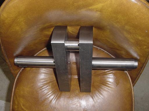

The American walking beam engine in my sidewheeler has a built up crank, pressed together, and fitted with “poor boy” keys. The interference fits are 0.001 on a 1.25 inch shaft diameter, and the maximum design torque is 270 LBf-Ft, a healthy number. The crank webs are ordinary low carbon steel, and the shafts are common, unhardened drill rod. This crank is not overstressed, and the fits are not overloaded.
The level of machine integrity described by steamboatjack is first class, but for many applications it may be much more than is necessary. To have machined my crank from solid, especially the high strength stuff steamboatjack states as a minimum strength (600 N/mm2 = 87,000 PSI) would have cost a small fortune compared to what I was able to produce in my small home shop.
Many two stroke racing motorcycle engines use pressed together cranks, so they can use needle bearings on the big end of the connecting rod. These cranks hold up well, under stress conditions that generally far exceed those of our steam hobby.
Design of machinery should always be a compromise, trading simplicity and ease of manufacture where prudent to allow reasonable cost. A forged one piece crank may be necessary for high performance engines with peak cylinder pressures of 1000 PSI or more, but is beyond the reach of the one-off home shop builder, unless of course a ready made IC engine crankshaft is adapted to the engine being built.
- Walking Beam Built Up Crank Pressed together
- CRANK FIN s.jpg (31.21 KiB) Viewed 11686 times
- "Poor Boy" keys, drilled, tapped and locked in place with a hard set screw.
- CrankKeys s.jpg (32.4 KiB) Viewed 11686 times

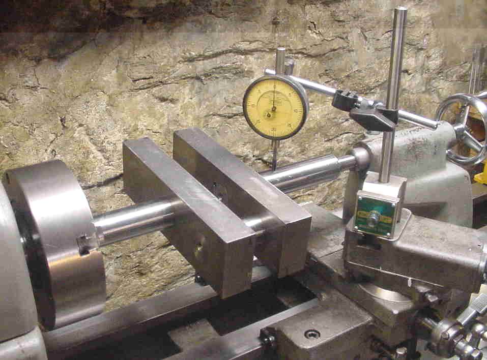

Re: Stuart Turner 6A - Crankshaft Casting
"Concerning the lead hammer truing, I believe Mike was referring to the way you true Harley Davidson cranks. The Harley crank has two flywheels and three shafts. The shafts are tapered (to fit the tapered holes in the flywheels) with threads on the ends for a nut."
While the Harley Davidson cranks are as described above, several Japanese 2-stroke motorcycle engines use a simple pressed-in crankpin on a three piece crankshaft assembly, with no tapers, no nuts, no keys and no pinch bolts. These cranks are pressed together, then aligned with a lead hammer which smacks the crank web. Alignment is checked by mounting the crankshaft between centers, and placing a dial indicator on the main shaft, near the crank web.
The photo shows the American Walking Beam Engine crankshaft being checked the same way. Fortunately I did not need to smack anything with the lead hammer, but if alignment was not right I would have.
- Checking Crankshaft Alignment
- CrankCenters.jpg (44.79 KiB) Viewed 11673 times
That is exactly how I was shown with the Villiers (s/cyl 2 stroke) so many years ago.
It was 'clocked' at at least four points, two on each main shaft.
