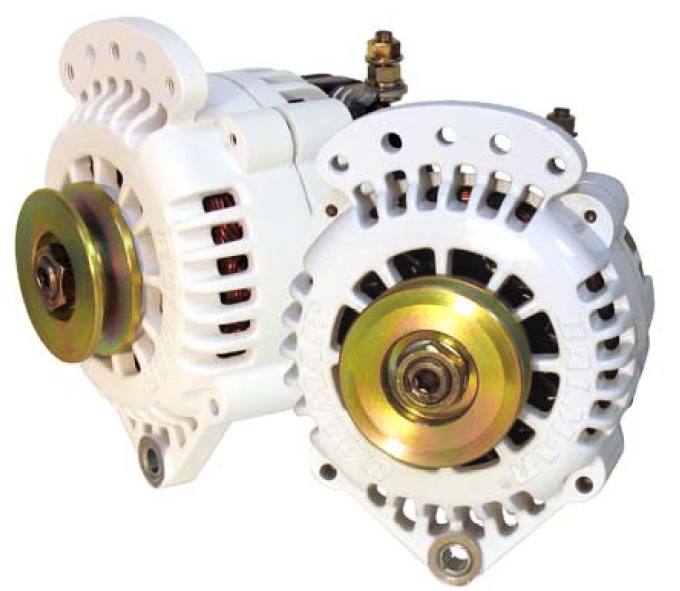

Looking up tech data for a marine 12 Volt alternator (Balmar 6 Series, with internal voltage regulation built-in, the smallest of their marine line) gives the following data:
Rated output: 70 Amps at 14.1 Volts.
Operating speed range: 1,320 - 15,000 RPM
About 2000 RPM is needed to get the alternator into reasonable efficiency, with an output of 50 - 60 Amps.
50 Amps x 14 Volts = 700 Watts Output
Alternator Efficiency is in the general vicinity of 50 % - 60%, based on what I could find for similar machines, although the Balmar datasheet does not specify this number.
700 Watts Output at 60% efficiency = 1167 Watts Shaft power Input = 1.56 Horsepower Alternator Shaft Input Required. To that one must consider the efficiency of the drive system from the Engine to the Alternator Shaft, probably 90% or better with a proper serpentine belt drive, and a ratio of 8:1 or similar, then engine horsepower required is 1.75 Horsepower, a healthy number for our small launch engines.
The smallest automotive alternators I have seen put out 30 Amps, these would require about half the input engine power, and would probably require a somewhat higher running speed.
