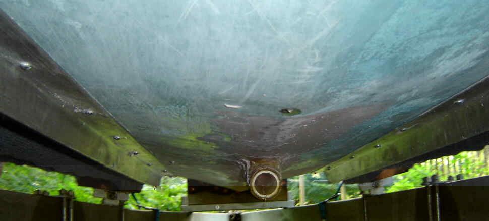

An iten in another thread you might consider. In the "Engine/Boiler Recommendation" thread the use of bilge keels is outlined for engine/boiler mounting optipns (see section drawing in Engine/Boiler Recommendation). If you do not want bilge keels, then an external flat bar can be used, either way you get more structural integrity in attaching the engine-boiler stringers to the fiberglass hull.

- Bilge Keels - Bolt Thru to Engine Bearers.
- keels-sterntube-look fwd.jpg (31.62 KiB) Viewed 5693 times
