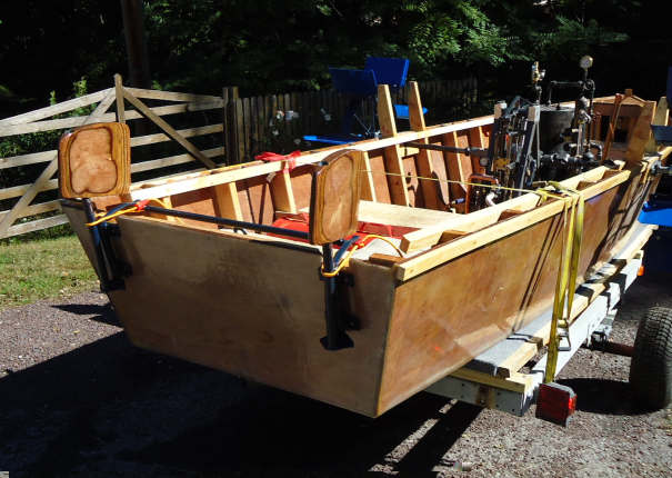

How to steer a sidewheeler? Traditionally with a rudder, although I have two in an effort to get the rudders into the wheel wash. Sidewheeler Margaret S. steers OK, but really no rudder effectiveness unless there is boat motion. My rudders also fold up, this protects them for shallow water (the sidewheeler hull only draws about 8 inches draft) as they can kick up if I get into shallow water . I can also back up to a beach and everyone can step off onto dry land with the rudders folded up.
Traditional sidewheelers did not have individual wheel control, and many have suggested that I have this feature, but I wanted the traditional setup, which has been satisfactory. There is a video about this on Boat Design Forum.
Ray Hasbrook had a sidewheeler that used a lawn mower differential for a paddle shaft, he could brake one wheel, then the other would turn twice as fast, that sidewheeler could turn on a dime.

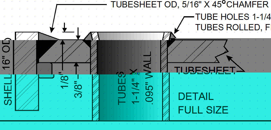

Good basic layout. One issue, the boiler code requires that the tubesheet be placed "entirely within" the furnace and shell tubes, so your plate dimensions should be:
Top tube plate Diameter: 15.25", Thickness: 3/8"
Bottom tube plate Diameter: 12.00", Thickness: 3/8”
Base plate, 15.25 in OD, 12.75 in ID x 3/8”
Detail attached.

Yes I was planning on the schedule 80 pipe, but I'll be changing that now. Also I admit that I have not looked very closely at the boiler code, thank you for letting me know about the tube plate placement.
Just a couple questions about the detail: What is the rounded square just left of the 1/8 next to the shell? And I've read a few places about "expanding the tubes in" just wondering what that is... I think that is what has been done to the tube in the detail but I'm still new to this so I thought I should ask rather than just assume.

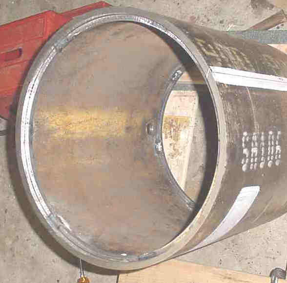

“What is the rounded square just left of the 1/8 next to the shell?” ANS: That is called a “backing ring” and is put there for welding purposes. The Boiler Code requires full penetration welding of the tubesheet to the shell, and the backing ring lets the welder use fairly high amperage welding, without any burning thru the metal, and get a weld that fully penetrates the tubesheet thickness. The full penetration weld can be obtained by making weld passes on both sides of the joint, but you would be hard pressed to find a welder small enough to get inside the shell of our boilers!
As an aside, when I was working on Nuclear Submarine building in the 1960s (height of the cold war arms race) at General Dynamics, they found several areas where welding was required but too tight for ordinary workers. The US Govt. evoked a national security rule, and commandeered all the midgets form the circus, and trained them to be welders. This was the only way to do it back then.

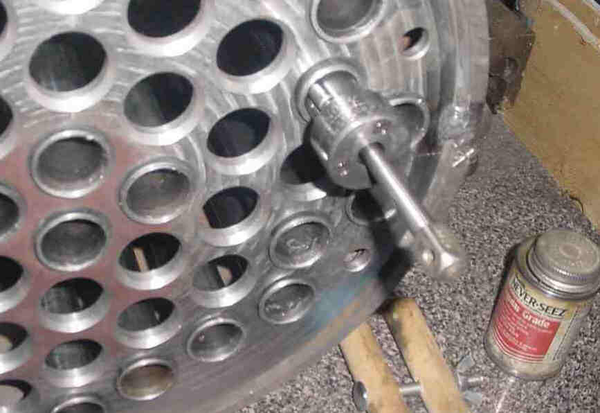

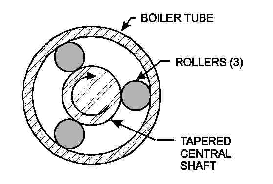

“I've read a few places about "expanding the tubes in" just wondering what that is”
ANS:
Boiler tubes should be expanded by forcing the tube wall thickness into plastic (permanent) deformation, which expands the tube diameter until it is a very tight fit into the boiler tube hole. This is done with a device, essentially like a roller bearing, called a Tube Expander.
The tubesheet holes are reamed a few thousandths of an inch larger than the tube Outside Diameter (OD), and the tubes inserted. The expander is then inserted into the tube ID, and the hardened steel tapered central shaft rotated, while being pushed into the tube. This action pushes the hardened steel rollers against the inside of the tube, with sufficient force to deform the tube wall against the tubesheet. The tubes are then tight, and usually leak proof.
After expanding the tubes, some use a seal weld on the joint, as shown on previous post.
Just welding the tubes into the tubesheet without expanding them first is not good practice. This is because there would be small gaps between the tube OD and the tubesheet hole, and these gaps would tend to accumulate and concentrate dissolved solids in the water. There would be no way to effectively remove these deposits, and they can cause problems at this critical joint.
When expanding tubes, the tube OD and tubesheet hole should be very clean, with no oil or other coating, just bare clean metal. The tube expander should be dipped into a can of oil and fully submerged to lubricate all of these parts during the expanding process.

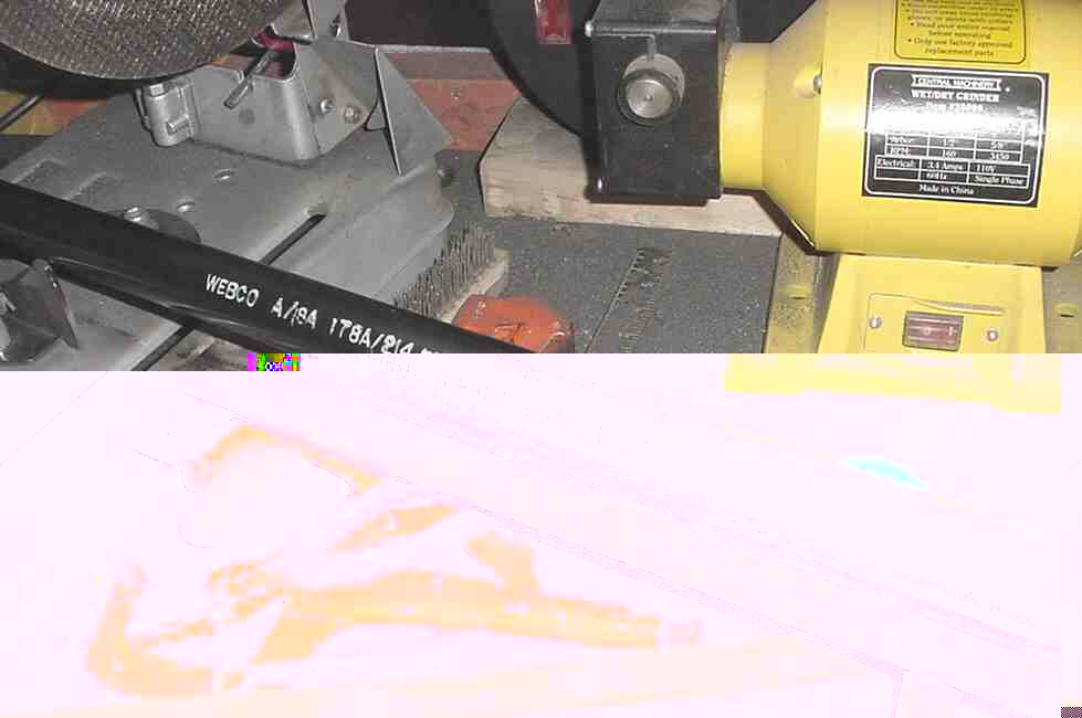

“The A178 steel boiler tube, found out that there is seamless and welded varieties, select seamless?”
ANS: The seamless is somewhat better, but the welded boiler tubes are very adequate for the service at a few hundred PSI or less. I would guess 98% of the A178 tubes sold are not seamless, and the seamless ones must cost plenty compared to the welded tubes (ERW). My boilers use ERW tubes.
