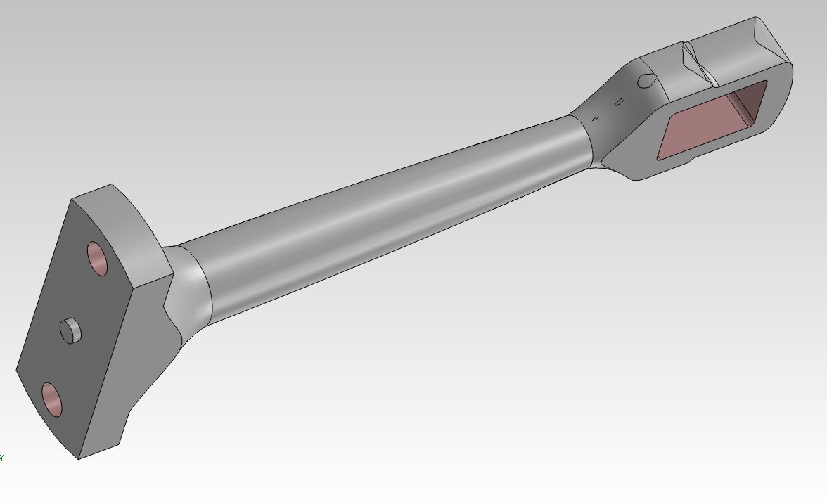

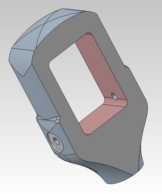

Final rod
- Con-Rod-04.jpg (44.79 KiB) Viewed 9604 times
- Con-Rod-03.jpg (31.99 KiB) Viewed 9604 times

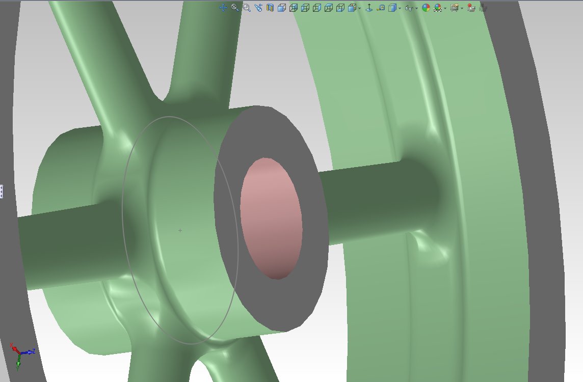

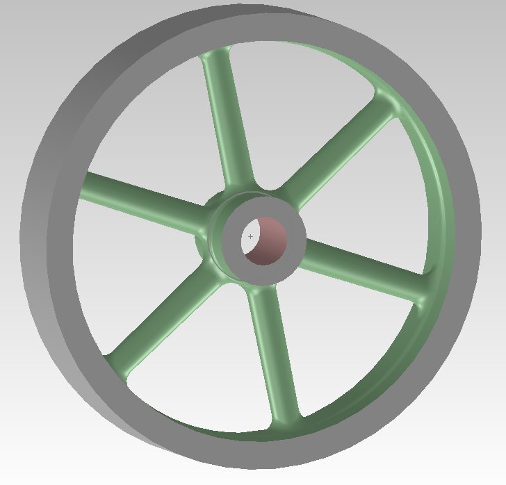

Flywheel
- 16-5-Flywheel-02.jpg (56.44 KiB) Viewed 9604 times
- 16-5-Flywheel-01.jpg (41.74 KiB) Viewed 9604 times
Pat J

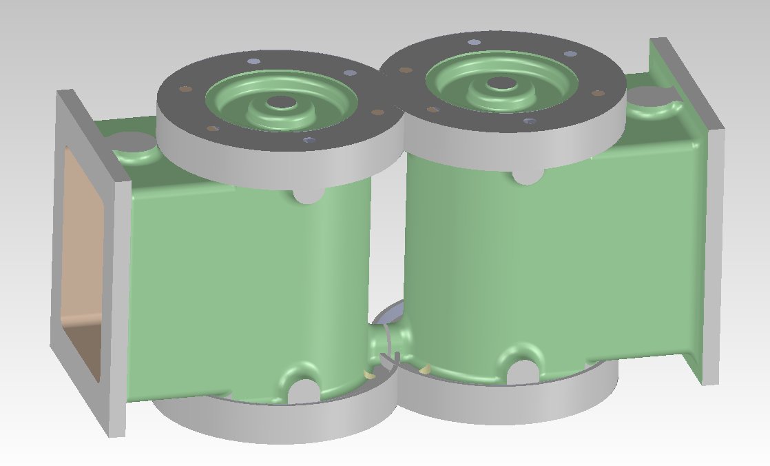

Re: Bottle Engine 3D Model
Still much left to do on this engine, expecially the frame.

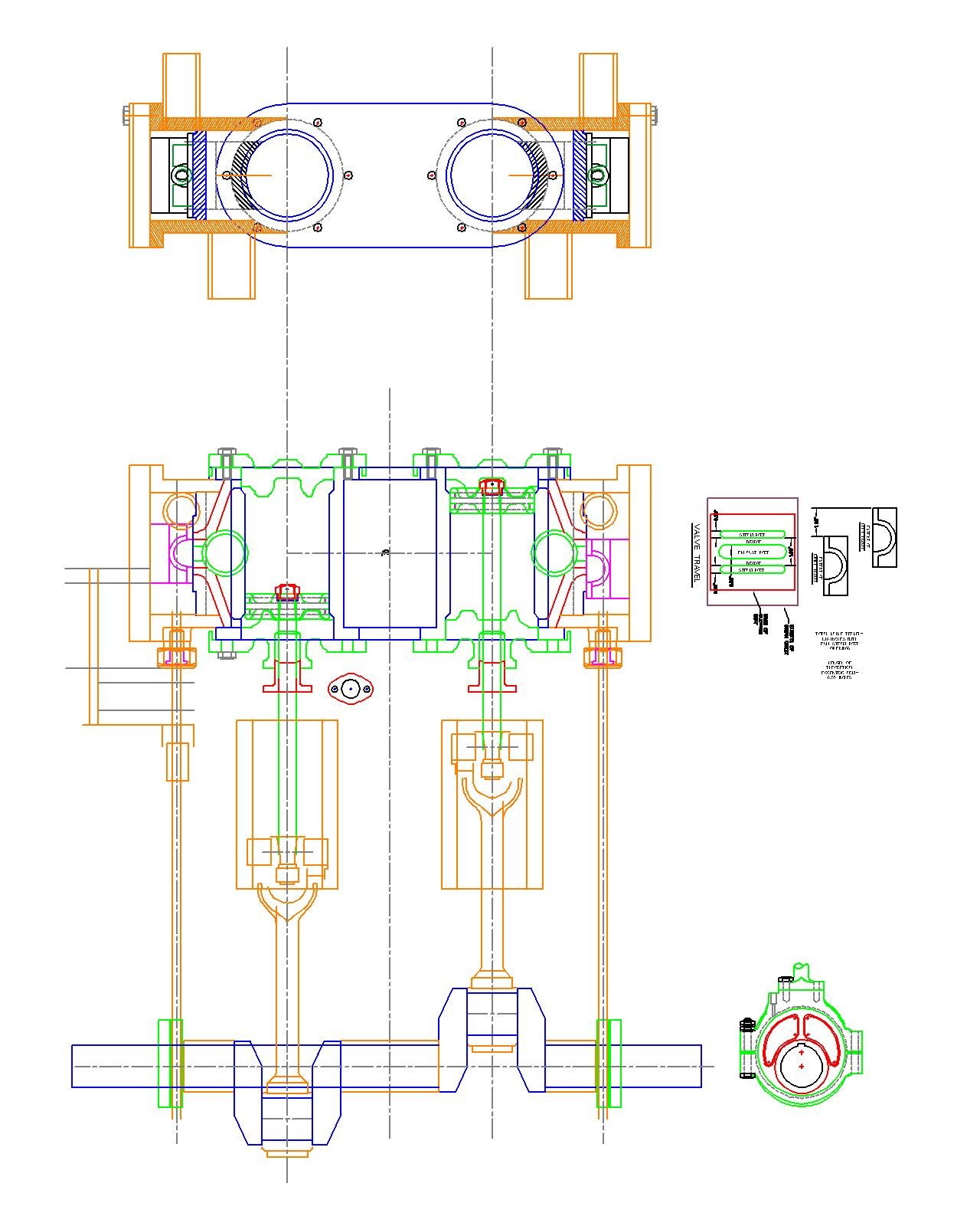

And an early 2D drawing of a twin marine to use the same cylinder and 3" bore.
- Twin-Marine-10-27-10.jpg (220.93 KiB) Viewed 9604 times
Pat J

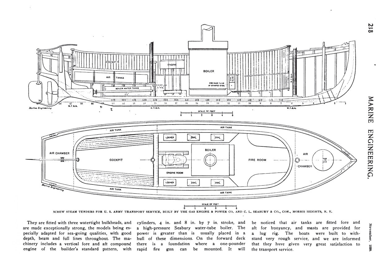

And the boat that I dream of building some day.
- ALDRICH-NAVAL-03.jpg (162.16 KiB) Viewed 9604 times
- ALDRICH-01.jpg (241.88 KiB) Viewed 9604 times
- ALDRICH-02.jpg (195.3 KiB) Viewed 9604 times
Pat J

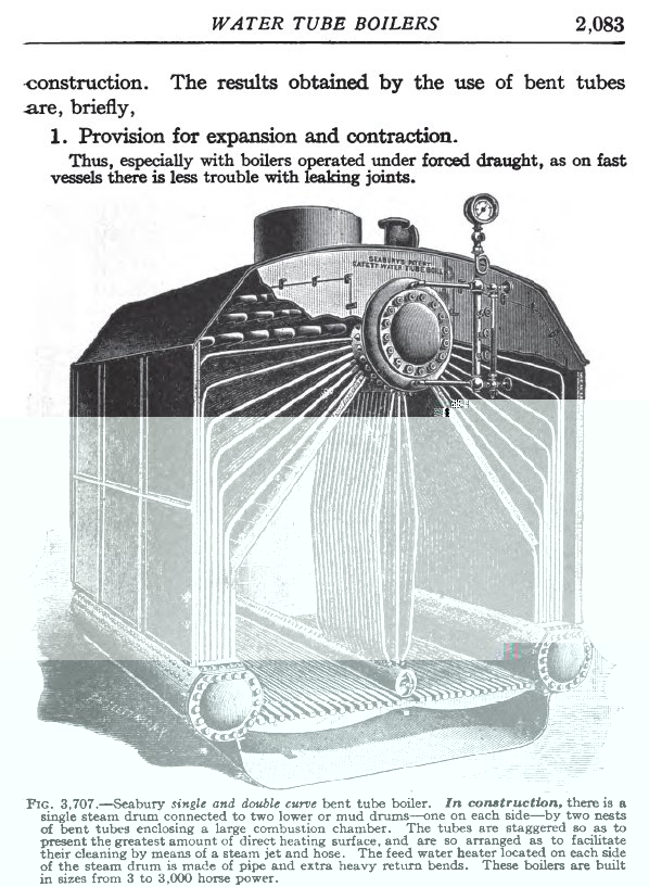

Oh, I forgot, maybe a porcpine boiler like this, or a water tube type with three drums as shown in the engraving.
