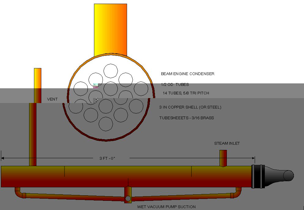

Very nice twin design you have going there.
As far as condensing goes, the Margaret S. has a planned condenser, but I like the sound of the exhaust so much I am not anxious to install the consender. The wet vacuum pump is already fitted (for now it does duty as a bilge pump or a lake water suction to fill the water tanks while underway. The boat has two 15 gallon water tanks, and this is enough for several hours cruising when in salt/brackish waters. When on the lower Delaware River (salt water), I have always been able to stop at any marina dock and fill the tanks with fresh water if needed.
The boat is propane fired, and there are two advantages, one is ease of control, the other is a complete lack of soot on the boiler surfaces. With the turbulators in the firetubes, cleaning any soot would be a problem. We have tried to throw some firewood down the stack, to get a little smoke and wood burning smell, but the turbulators take so much temperature out of the flue gas that the wood doesn't even start smoldering.
SW Condenser.jpg (67.05 KiB) Viewed 8510 times
