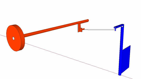

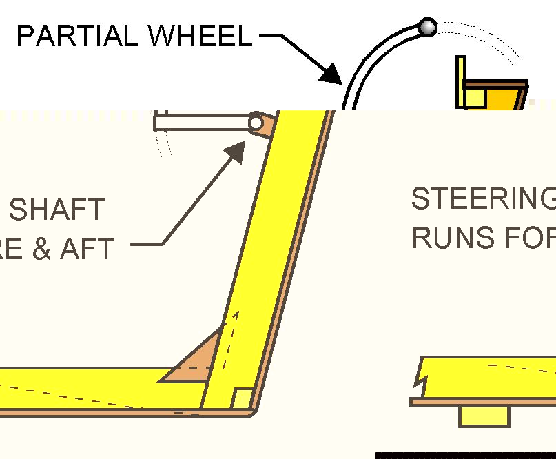

In any event I had no room on my steamer for a conventional steering wheel, and thought I would be confused with the steering wheel shaft running athwartships, so I opted for a partial wheel, with steering shaft running fwd-aft along the side of the boat. My electric boat has the same setup, and it has been entirely satisfactory, with no cables whatsoever.
