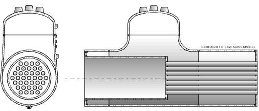

For boilers, the Roberts/Yarrow type water tube boilers are really good steam generators, but they require more tending - smaller water volume. The Large VFT (Iron Chief's boiler)and HFT boilers are the easiest to operate, more stable and forgiving, they do everything more slowly, unfortunately that includes making steam. Monotube and Flash type boilers are the best steam generators, but require some sort of intelligent controls to maintain them, and are best suited to steam car applications. Personally, I think the Ofeldt boiler is the best ever designed in mainstream use, all things considered - Simple, compact, lighter, safer, excellent steam generation, good internal circulation, manageable and relatively inexpensive and easy to build.

The horizontal firetube types, for example a gunboat boiler or scotch marine type, has similar characteristics, but is even more stable in water level than the vertical firetube type. Add to that the lower center of gravity for the horizontals, and you have perhaps the ideal seagoing boiler. Ever notice that 90% of the small seagoing steamships of the late 19 th century had scotch marine boilers?
A VFT, Scotch, or Gunboat boiler can be fabricated by most shops, as there are no bent tubes and no complex shapes in the entire boiler (dryback Scotch excepted).

- Small Gunboat Boiler
- GBB s.jpg (18.46 KiB) Viewed 10989 times
