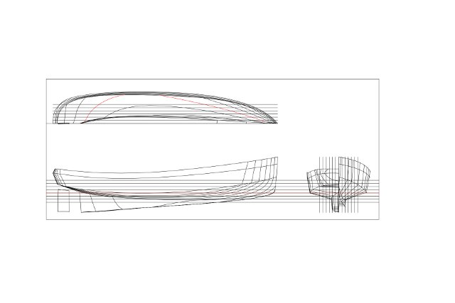

My brother designs boats (along with other things); his website is http://smaalders.net/yacht_design/. He's doing the design for the hull; here's an initial proposed sketch of the lines, including a box keel to facilitate beaching (nice to be able to do in the San Juans):
Sea Lion draft lines_Dec 2012.jpg (18.67 KiB) Viewed 11610 times
. I've got copies of Skene's Elements of Yacht Design and David Gerr's Propeller Handbook here, so running the basic numbers is not difficult. We're going to emphasize efficient performance at 6 - 7 knots; burning two or three times the fuel to go 8 or 9 is fun at a steamboat meet, but for longer distances quite impractical. I want to take this boat all over the Northwest via water, so living aboard in comfort is an important part of the design.

Nice hull you have worked up, looks like a comfortable and seaworthy hull.
