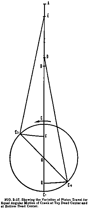

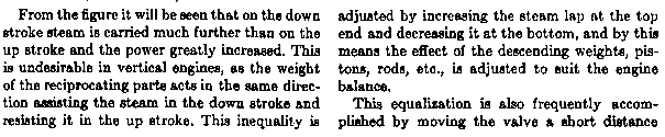

Please forgive the multiple attachments, but I had to do multiple scans to keep the files small enough to post. The following post will contain the diagram referenced.
FYI: this comes from is Part IV of a 1946 Pub that was primarily intended for instruction at the Naval Academy it is not a manual as such and contains a range of what was considered common practices of the day and may not just Navy.
Dave

Diagram.

Oilking wrote:Diagram.
This is another reason to look into the use of radial valve gear- in particular Marshall- the travel of the valve is also unequal, but in a manner that compensates for crank error.
Greg
