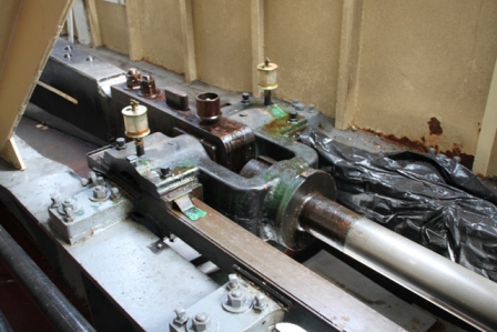

Just for fun I tossed in a shot of the crosshead with drip oilers. There are 19 per side not counting the pressure oilers. This thread did start with a question about lubrication. FYI: the piston rod is 5in in diameter.
