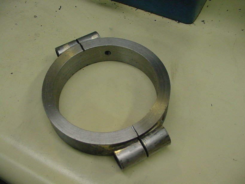

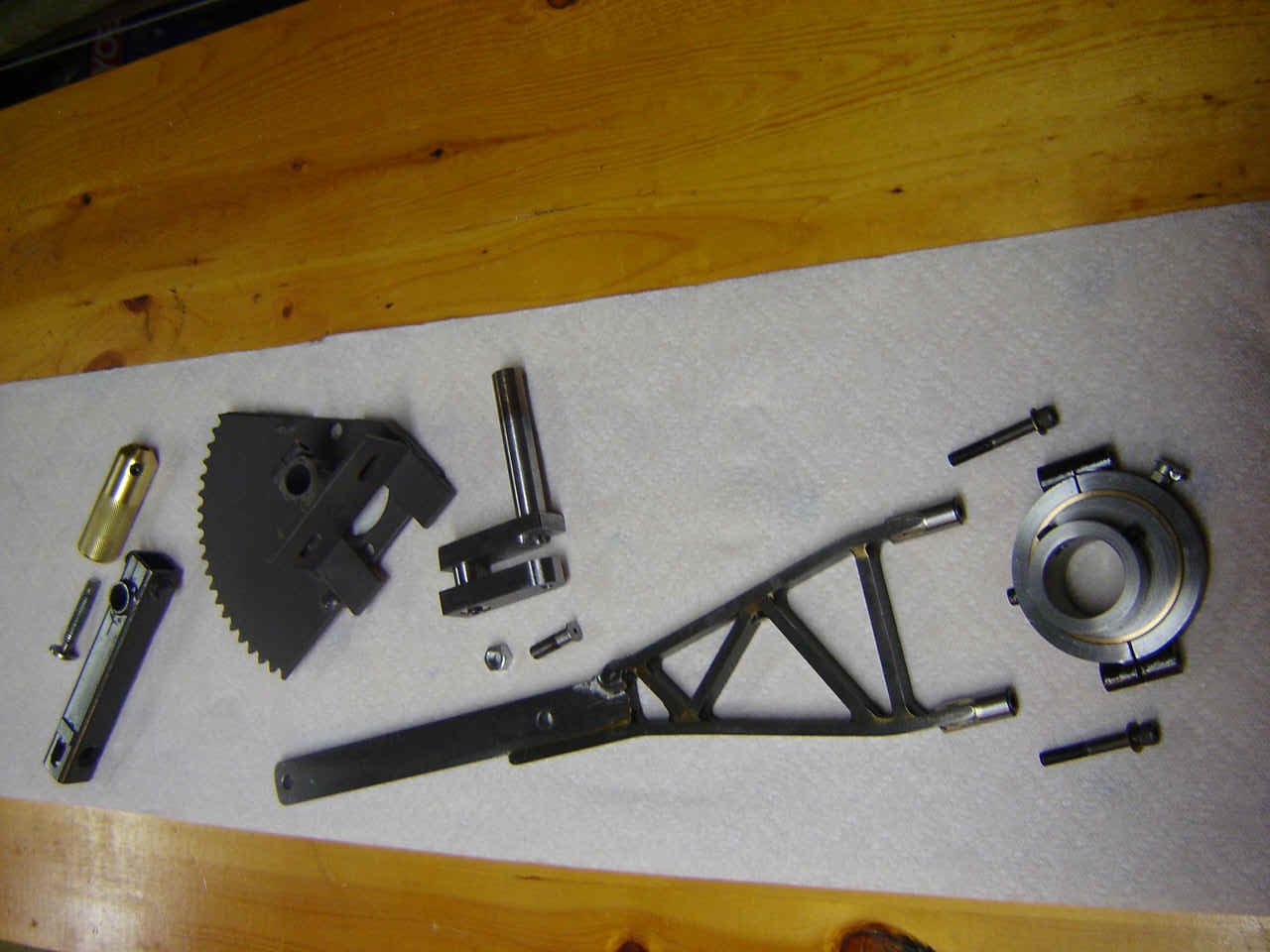

One method to reduce the use of expensive bronze for as a bearing material is to make the part of steel, and fit a bronze bearing with a pressed fit, or bronze held in place with screws, or fitted the same as automobile /IC engine practice, etc.
The valve gear eccentric bearing for my engine was fabricated with steel, and then fitted with a bronze bearing. You can also use automobile/truck split bearings, available in almost any size you want, rapidly available and cheap in the USA. Look up the engine bearing size, often given in engine manuals (available online), then order the bearing shells.
- ValveGearParts.jpg (107.69 KiB) Viewed 166067 times

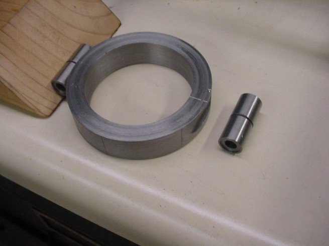

Eccentric bearing build details.

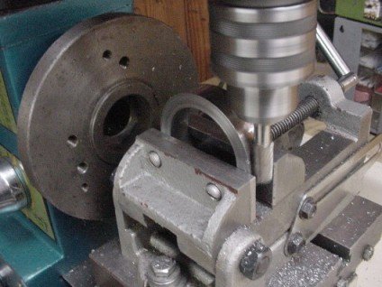

A bearing ring is machined of steel, and milled recess made for bolt seats.
- ECC CAPS MILLINGS.JPG (34.31 KiB) Viewed 166065 times
Bolt seats were brazed in position, or this entire piece could be made from one single piece of steel.
- ECC CAPS READY TO SOLDERS.JPG (39.56 KiB) Viewed 166062 times
Brazed assembly
- ECC-CAPS-FINS.JPG (66.75 KiB) Viewed 166061 times

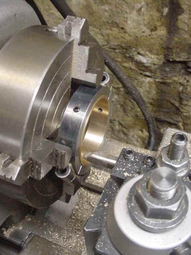

Bearing Bronze installed, held in position with a light press fit, and three screws that also keep the eccentric allignment
- MachineEccentricBearingS.jpg (74.53 KiB) Viewed 166060 times

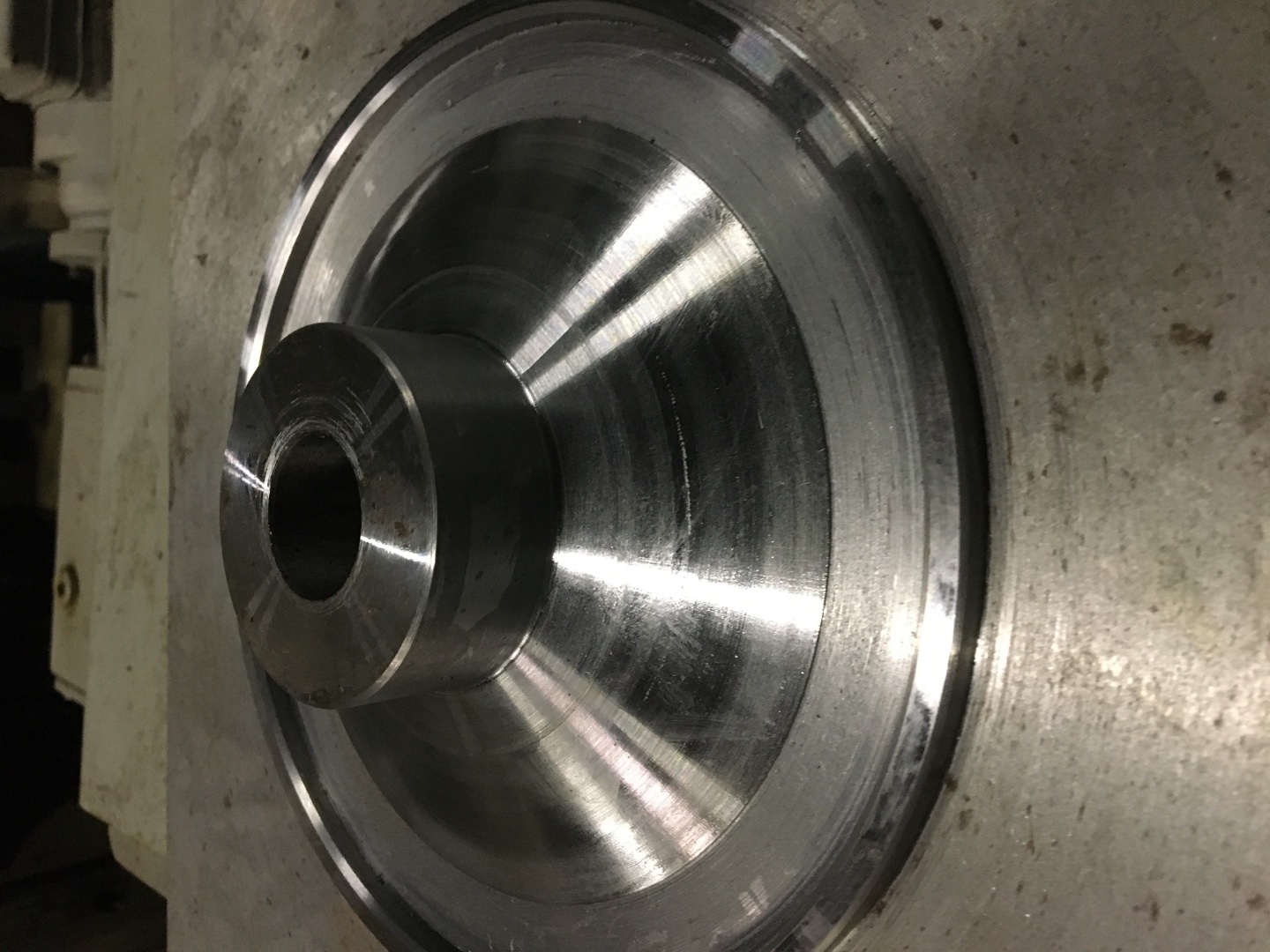

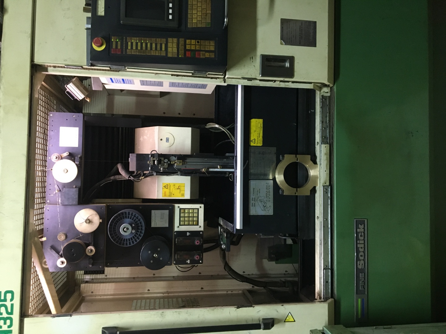

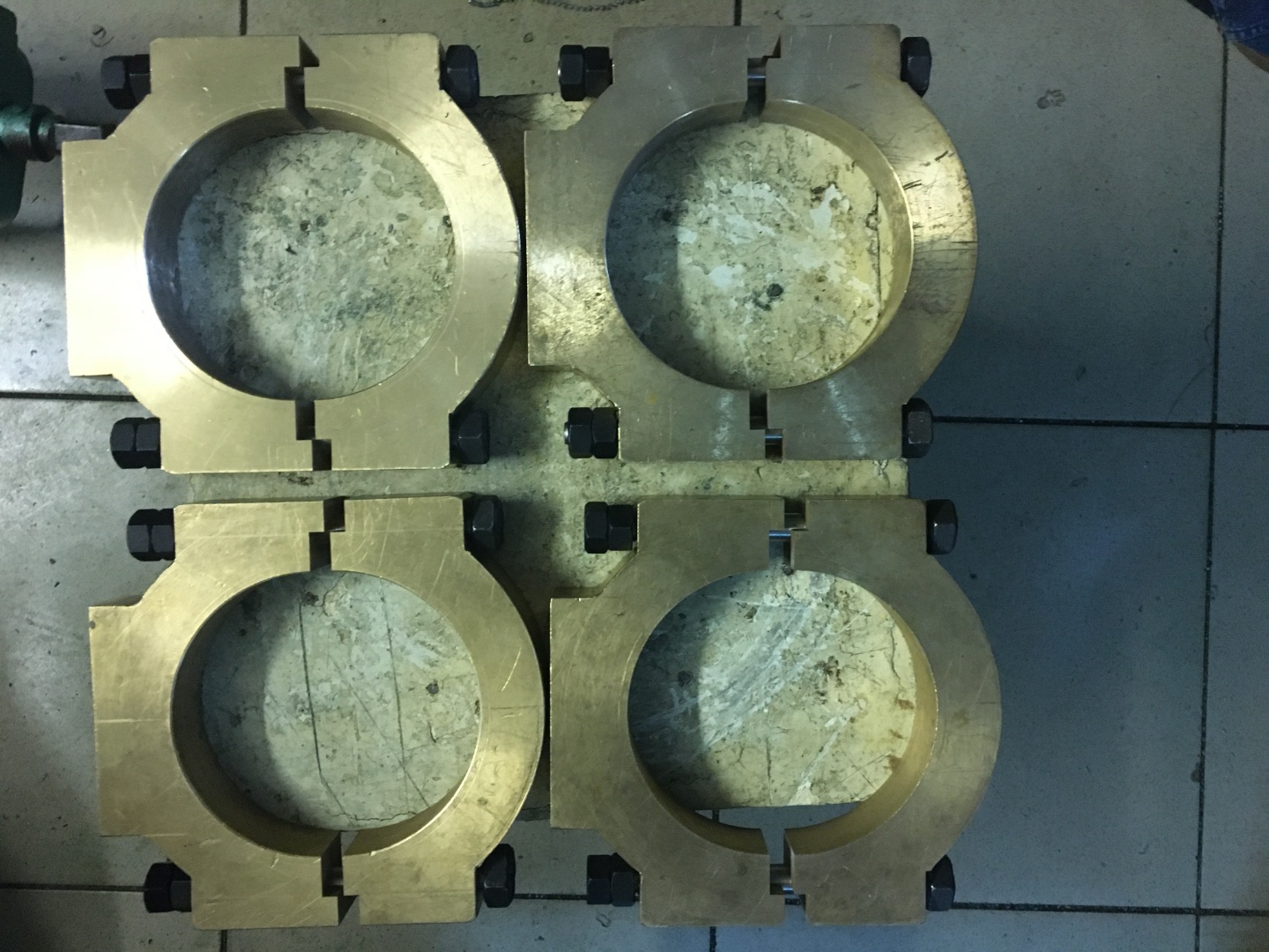

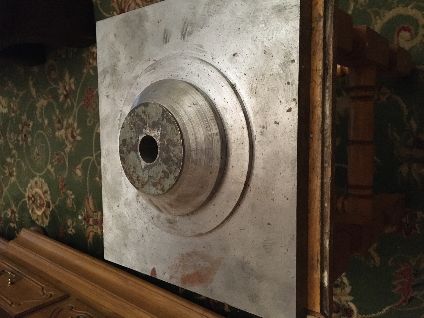

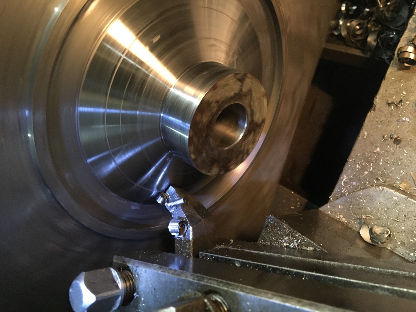

Dear Fred! I would fully comply with your recommendation by making clamps for eccentrics from steel, using a small amount of bronze. But only if you shared your pictures in the year 2018. In 2018 I decided to make bronze clamps. I bought a bronze disc on 200 mm in diameter and 75 mm thick back then. Currently, I am not able to change the design of the clamps, as in your pictures. Your design is economical but difficult to manufacture. It takes a lot of skill and a lot of time. Time is my enemy. While I'm busy making the top cover of a large cylinder. Here are some pictures. Dear Cyberbadger! I am grateful for your offer. When I have completed all the major large steel parts, I will contact you and we will discuss your proposal in detail. Best regards Ingvar.
