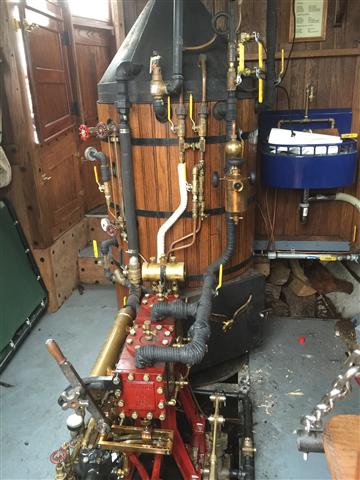

I just wrap it with clothes line and paint it. I did all that insulation mess under the rope the first time, when I removed it, the pipes were rusty and if it gets wet and it will, it's ruined.

That clothes line braided rope is whatever Home Depot carries in their hardware department. It's just wrapped directly on the pipe and then painted with Industrial enamel flat black, same paint as the hull is painted with. The pressures we run, we never see temps high enough to ignite it. Remember too, the pressure is lower in the steam line/valvechest (MEP), a drop in pressure is a drop in temperature. It takes a while to wind on there but it holds up good and looks nice too. You can even get fancy and put Celtic knots or bands on it (Google for how). I use a "ferrule" wrap like they do on fishing rod eyes or serving on bow strings. Lay the end of the line down and then start wrapping over the top of it and the end is secure and hidden. The whole thing is done that way, short sections, which is better if you ever need to remove a portion of it, don't have to unwrap the whole thing. The elbows take a bit of practice and patience. When finished, saturate the whole thing with the paint, which probably helps with the heat resistance. It's cheap and it works.

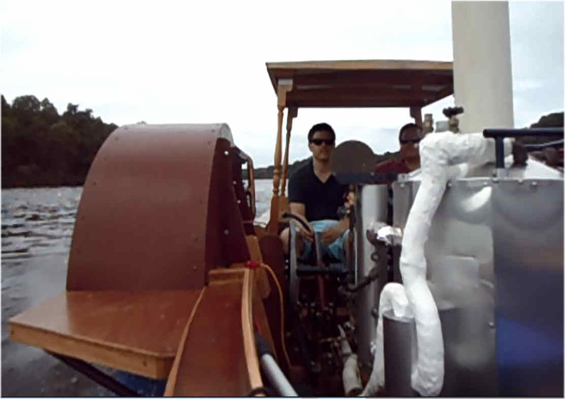

On hot pipe insulation, satisfactory performance can be made several ways, as delineated in the past few posts. I have settled on using several layers of Aluminum foil wrapped around the piping as the main insulating material. The foil is reflective, which is a good property where high temperature is concerned, and the several layers gives stagnant air pockets which are providing good thermal insulation. In the late 19th century the US Navy started to use it as an ideal steam pipe insulating material, but soon abandoned this because of the excessive cost. For our boats a few rolls of heavy duty aluminum foil, the cost is not significant.
Winding the outside with pure cotton rope works well, and is rather labor intensive.
Getting Plaster of Paris soaked into pure cotton gauze (hard to find, most of what is available is a cotton-plastic material blend, not good for temperature) forms the outer protective coating for most of my piping. The advantages are that it forms a hard tough surface, ready for paint if you want, and the plaster hardens in a couple of minutes. The Plaster of Paris will not hold up well if you take more than about a minute, after wetting, to apply it over the insulation. If you take longer, then the Plaster of Paris is worked after it has started hardening, and very weak material is the result. I have easily gotten several years service from this arrangement

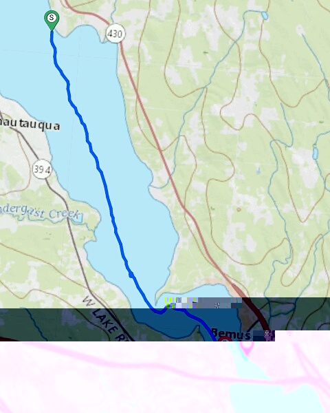

Longest trip for Nyitra today, and 150-200psi the whole way on properly sized chunks of mixed firewood. A new nozzel on puffer made a huge difference also.
14 miles, 300lbs hardwood.
7 miles, 1hr 50 min.
