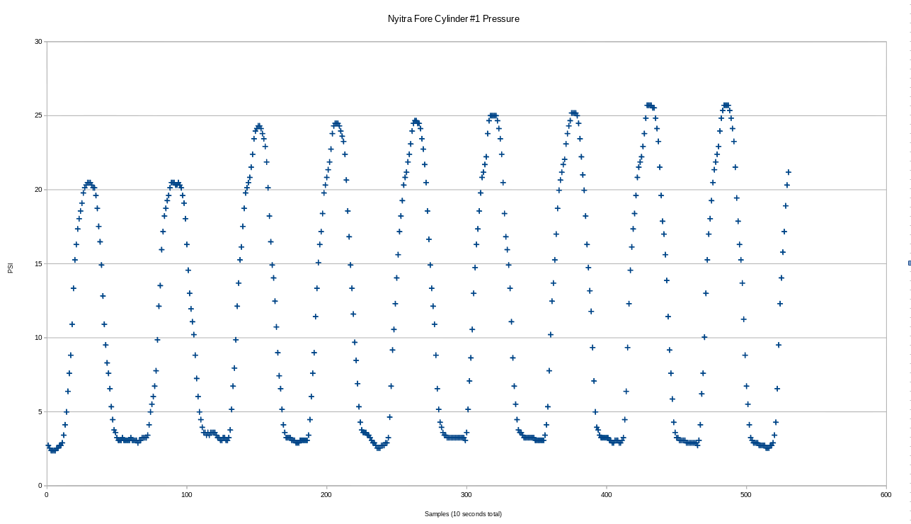

Got one capture running the engine slow with the new $30 sensors and circuitry.
At this time my sample rate is 50hz. The bottleneck is not the A->D itself, it is supposed to be able to acquire at 800hz.
I looks pretty clear to me, but at higher engine speeds 50hz won't cut it.
In the graph that represents 10 seconds, you can see that the engine rpm is near 60rpm,

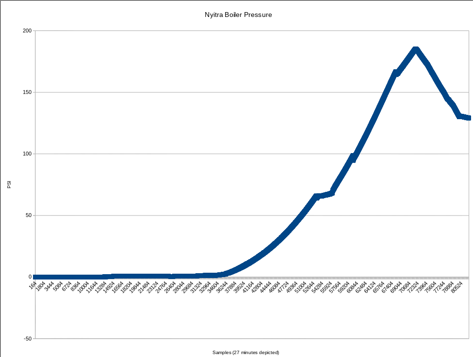

This graph shows 27minutes, this is the second sensor that is recording the boiler pressure. I am partially doing this to confirm that the engine cylinder pressure never exceeds the boiler pressure.
Around 52,644 samples I ran the injector and added 2-3 gallons to the boiler.
You can see that the colder water cooled the boiler and it took it a few minutes to really heat that water up before the pressure started really climbing again.
