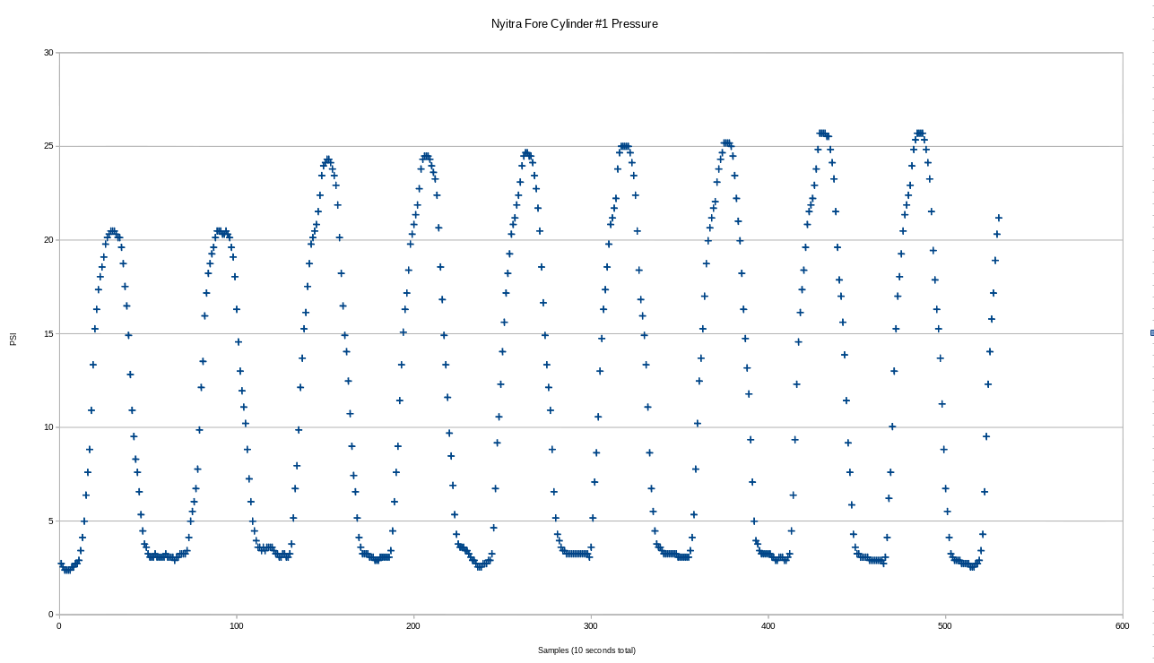

Got one capture running the engine slow with the new $30 sensors and circuitry.
At this time my sample rate is 50hz. The bottleneck is not the A->D itself, it is supposed to be able to acquire at 800hz.
I looks pretty clear to me, but at higher engine speeds 50hz won't cut it.
In the graph that represents 10 seconds, you can see that the engine rpm is near 60rpm,
