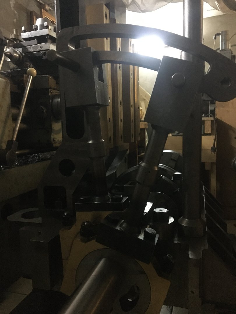

Continuation:
Posted: Fri Oct 15, 2021 9:56 pm
by Freezerrr12
I thank DetroiTug and Fredross for the recommendations given to me. I will take your advice and implement it when installing eccentrics on the crankshaft.
First, I will set the eccentrics at an angle of about 130-135 degrees.
I will test how the valve on the high pressure cylinder (first cylinder), which has yet to be manufactured, will work.
While I made all four eccentrics with bronze clamps. Photos of two of them, I managed to post on the site.
Unfortunately, I ran into difficulties with my old computer, so I had to use a new one. I forgot my username and password, so I couldn't get in touch for a while. Recently I managed to post one photo. I will try to post all the photos of what I was able to do. Once again, I would like to thank the forum participants for their assistance and very much needed recommendations.
Ingvar.
Posted: Fri Oct 15, 2021 10:08 pm
by Freezerrr12
Continuation
