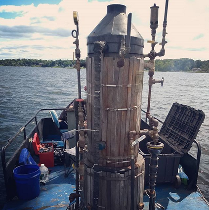

Nyitra has undergone a lot of hidden upgrades, a 3/8" 40"x40" mild steel plate added ontop of the 3/4" marine ply for the engine and transmission shafting to bolt to, engine overhaul, etc.
I held a private race on Lake Chautauqua this weekend, what we call the "Fern Lodge 1890s Classic: Sail VS Steam" This year it was Nyitra vs a Sunfish sailboat.
The race was a winner takes all race with the course being from Point Chautauqua to the Chautauqua Institute Clock Tower and then the second leg ending at the Mayville Public Dock.
We recovering from two set backs during the leg from Point Chautauqua to the Chautauqua Institute Clock Tower: a broken steering linkage and the aft crank pin journal nut coming undone- good thing I was watching the engine. I cut steam with the 3/4" right angle Milwaukee Globe Valve in time for the journal insert to fall onto the deck!
Unfortunately, our stack blew off and Nyitra has joined the long list of Chautauqua Steamboats who have parts laying in the depths of Lake Chautauqua!
This severely crippled the puffer arrangement and steady pressures between 150-200psi dropped quickly to 50psi, we had to stop a few times, and we finally had to get a short tow.
Noone received more then a few minor burns/scrapes and it was a good fair fight.
This was in actuality fairly historically accurate - steamboats did break down sometimes and sometimes Sail could be more reliable.
Congratulations to my good friend for a victory for team SAIL this year.
Happy Steaming - and don't forget to secure your stack!

Had some good performance testing and a first steaming with propane. I have to embrace more common fuels for a longer trip, as well as for making Nyitra more manageable single-handedly.
I have come to the consensus with my good friend that the upper speed limit on Nyitra is currently limited by the transmission.
The theory is at roughly 5mph the HTD Gates Powergrip belt and the propeller shaft htd toothed pulley are acting as a pump, and the water has nowhere to go so finally it pushes the belt outwards so much it skips a tooth because of the torque and hydraulic action.
This was mentioned as a possibility by the machinist I paid to machine the propeller shaft for me.
The solution is to drill out holes diagonally so the water can rush out the sides of the pulley.
This is perhaps easier said then done as the pulley is currently rusted to the shaft and the pulley is stainless steel.

Thanks Wes. Well I kind of wanted Sail to win this year, but not quite 3 big breakdowns big.
Already rectifying the weak points...
I just am upgrading Nyitra to Hydraulic steering from a company called Hydrodrive. Their M75 kit is meant for an outboard to 75Hp. I adapted it for my Rudder. Now it's all new, and the steering links are all fairly tight and all _steel_ now (I was using these chain-link fence tops for under $1, but those are made of some zinc chinesium and they have broken several times at inopportune moments).
https://www.amazon.com/Hydrodrive-Outbo ... B07DNGS4GQ
Nyitra can now be fired with propane, I'm going to build a pot burner for kerosene/diesel. Trying to get Nyitra flexible with fuel and reliable enough for a long trip down the Ohio River.
