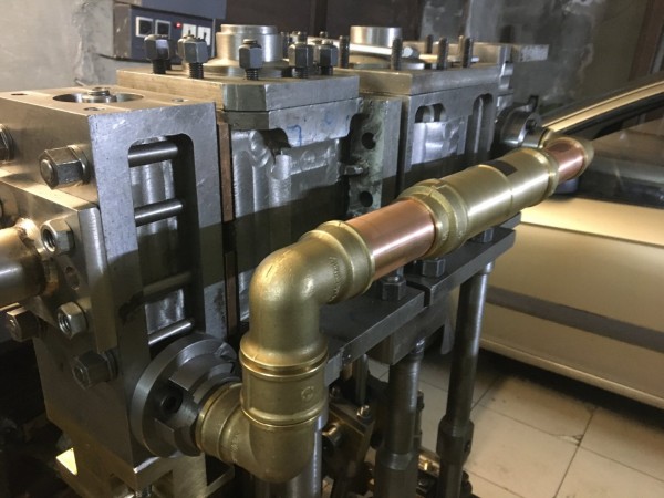

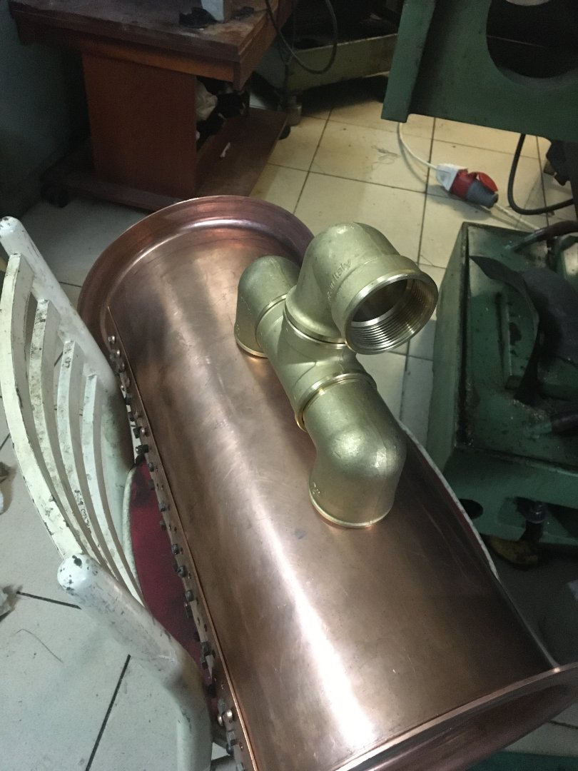

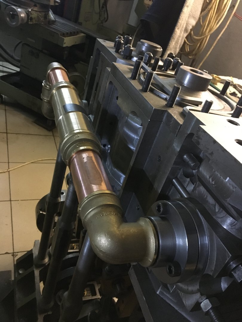

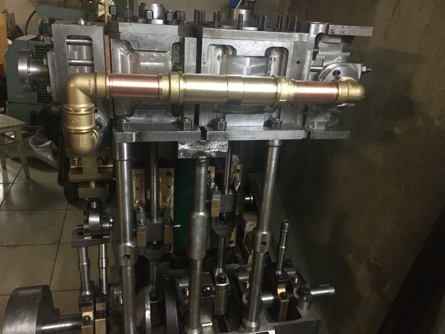

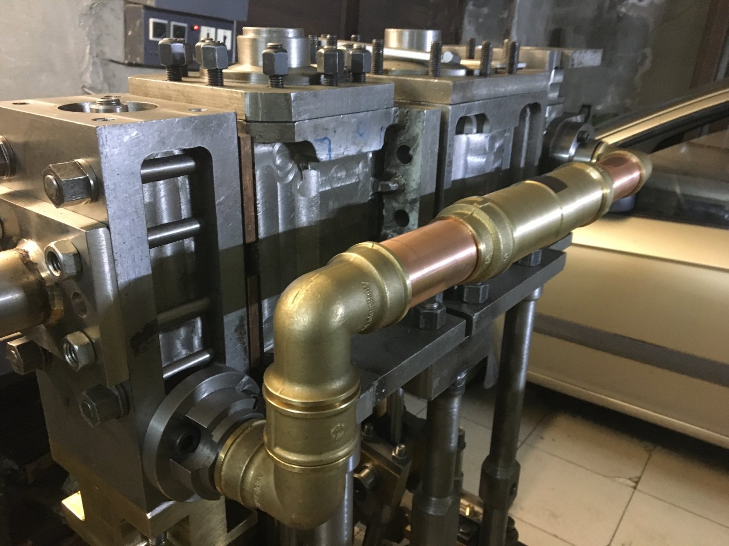

Find attached the picture of manufactured receiver.
- Posts: 268
Does that receiver pipe have provisions for heat expansion?
Perhaps that is not required?
Looks good, though.
Looks good, though.
Freezerrr12
- Posts: 105
- Boat Name: Anastasia
Hi! Dear RNoe, your question is correct. The minimum possibility of thermal expansion of tht receiver is provided for by its construction on threaded connections. I hope this expansion will be quite insignificant. The steam temperature in it is not more than 150 degrees C/

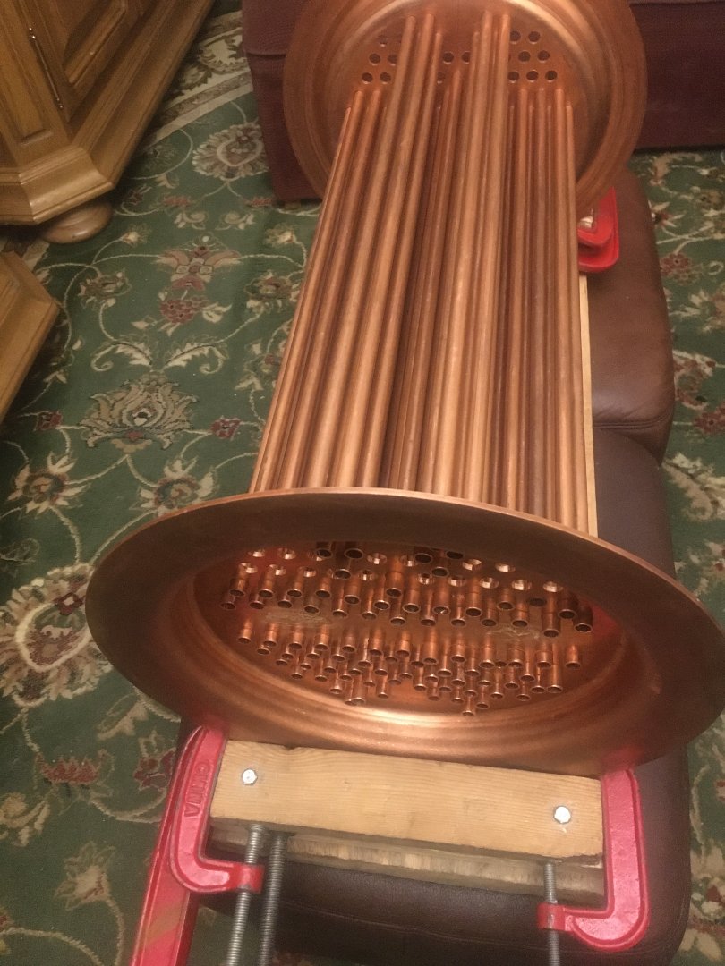

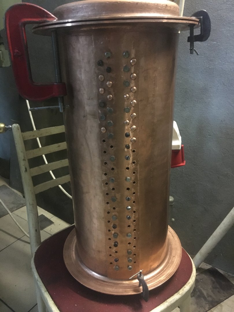

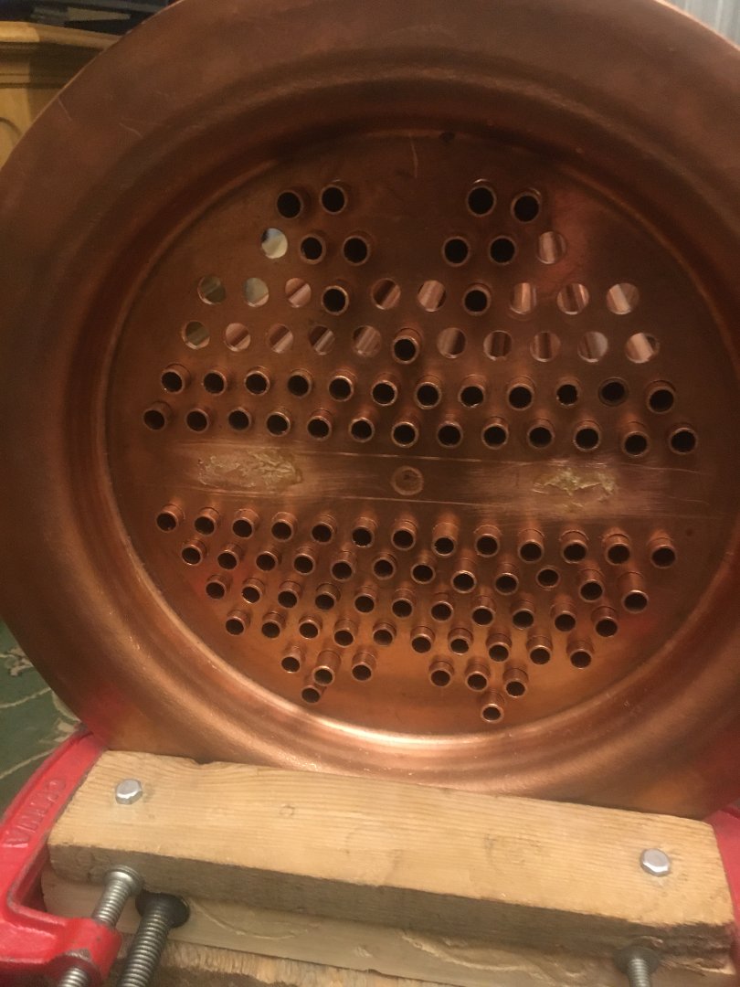

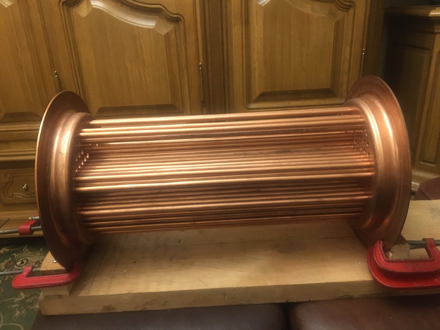

Dear forum participants. I need your advice. What area should be the condenser (condenser) of a traditional design for my steam engine. The structure is something like this. The diameter of the copper cylinder is exactly 10 inches - 254 mm by inner diameter. Cylinder length 18-18.5 inches. The number of copper tubes with a diameter of 10 mm - 112 pieces, 17 inches long. Photos of the manufacture of the capacitor (condenser) and its approximate design are attached. I will wait for the assessments of my capacitor (condenser) project, which i have already begun to manufacture. Ingvar.
Freezerrr12
- Posts: 105
Please, kindly note that the previous photos show that not all the tubes are installed, but this is a matter of time. Also, please, find attached the photos of the body of condenser (copper tube). It was cold in the garage in winter, so I did the condenser when it got warmer.
- IMG_7449 (2).JPG (132.43 KiB) Viewed 298146 times
- IMG_7697.JPG (126.87 KiB) Viewed 298146 times
- Posts: 865
Beautiful work Ingvar. I think the rule of thumb for cooling surface in an inboard condenser is 1 square foot/indicated horsepower... I don't have my metric calculator to convert, I apologize. Will you be using a circulating pump for the cooling water? Obviously the cooler the circulating water, the more efficient the condenser.

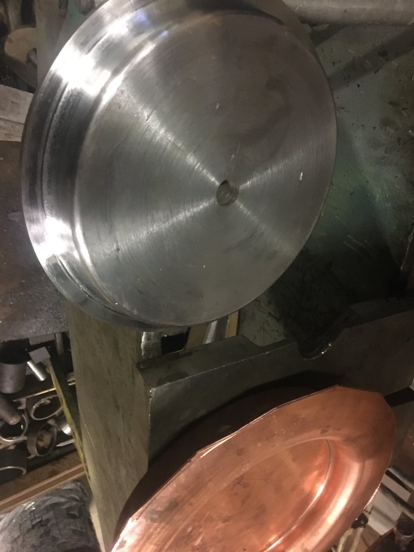

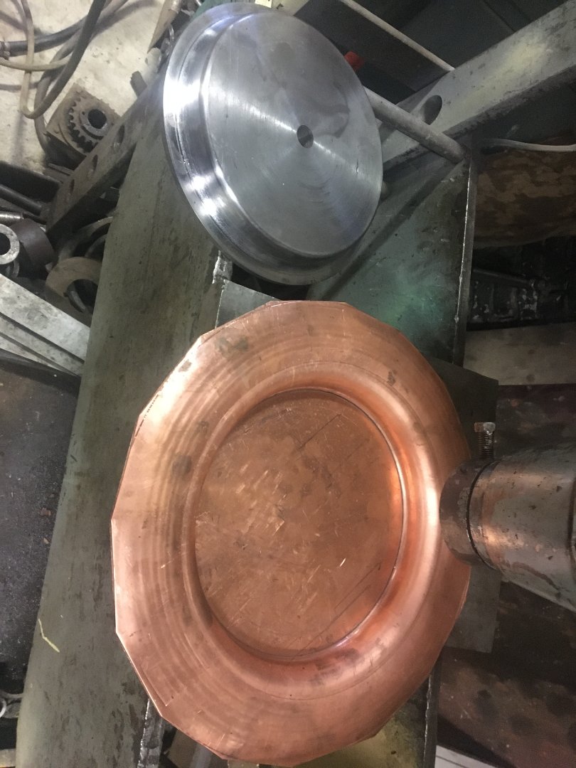

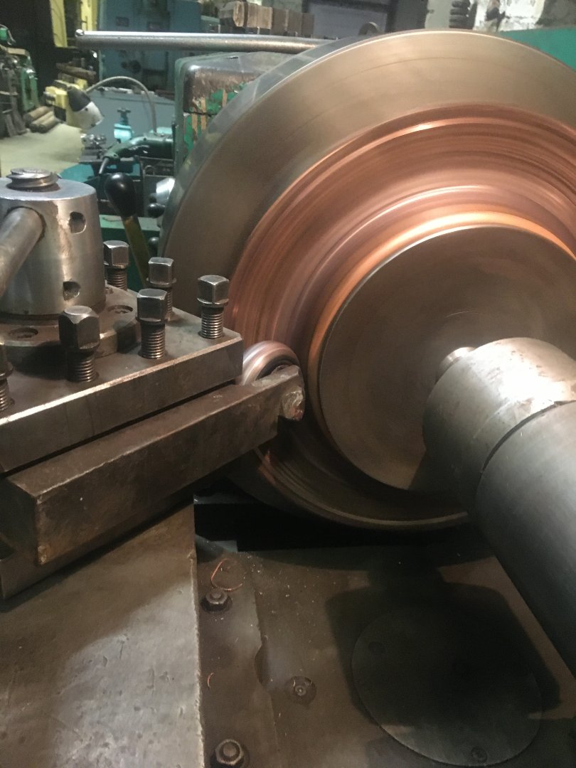

Freezerrr12
- Posts: 105
This is a photo of the condenser cover, which is made from a 3 mm thick copper sheet. So far I have only made four caps.
I also intend to make a fifth - medium one, for rigidity.
