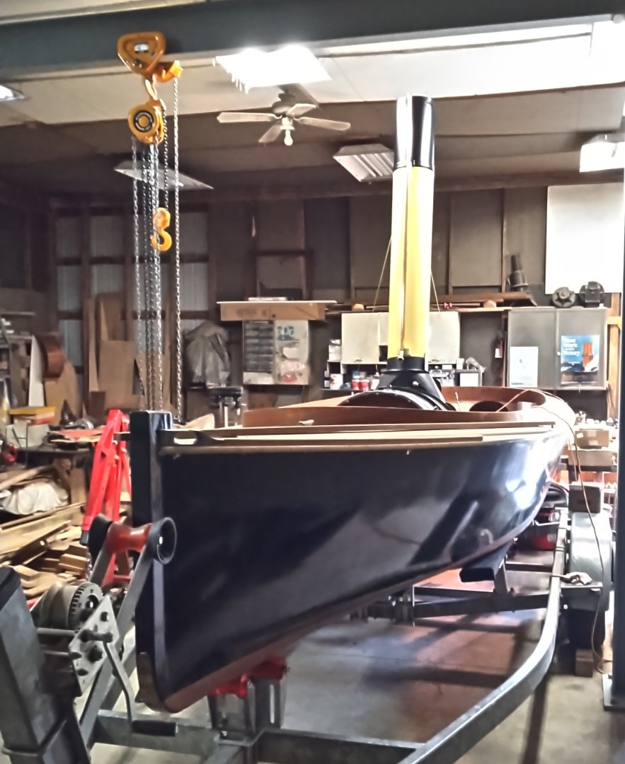

by S. Weaver
Hey, Wes,
Yes, though I'm busier than ever with "real work."
All of the feedwater piping is finished - suction and pressure - and so I making deck templates for those areas so I can walk around without smooshing copper lines. Boiler goes in once the overhead crane is finished in The Works. After that, it is pipe the auxiliary steam lines, cap the coaming, do some quarter-round and paint the hull one final time!

Posted: Thu Oct 29, 2020 4:11 pm
by S. Weaver
KIMG0134 (2).JPG (136.92 KiB) Viewed 70473 times
A shot with the boiler in the boat, secured to its mounts, with stack and bronze stays in place (Stack easily removes for transport or low clearance.) Now on to insulation, applying the jacketing, and boiler piping. The oak coaming and other trim on the foredeck is waiting to the last so I don't scratch it up. Apologize for the "quality" of the device image.
