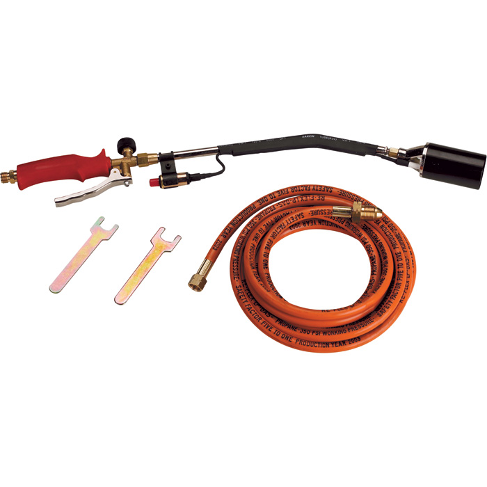

"as I understand bbqs are not allowed in case they start a fire, so boats with fires possibly sending out sparks are almost certainly a nono!"
On this issue, one could point out that the exhaust from a steamer boiler is at a much lower temperature than the exhaust from a gasoline or Dissel engine (300C vs. 600C), and with exhaust steam into the boiler stack even lower temperature. On the issue of potential for sparks, a propane burner could be substituted. On first running of my steamboat I was in a hurry to get underway so I just purchased a big propane "weed burner" and put the burner torch into the firebox. Crude but it worked well for more than a year, and absolutely no chance of sparks.
- Weed Burner - Propane 20 to 200 kW thermal output

Fred,
The "weed burner" looks like a great idea even as a backup for a complicated oil injection system. How long will a 20# tank of propane last?

20 Pounds of propane has a heating value of 450,000 BTU (132 kWh), and I would guess about 4 hours of run time, more or less. My boat can go about 6 hours on a tank, but I have relatively low power output.
Using the old ASME definition of a steam "boiler horsepower" (33475 BTU/hr or 9.8 kW boiler output) that translates to about 10 horsepower-hours, or 1 horsepower for 10 hours, or 2 horsepower for 5 hours, etc. Steam launch engines will use in the vicinity of one boiler horsepower per actual engine horsepower, small non-condensing plants more steam, larger compound condensing plants less boiler output per engine output shaft horsepower.
After some time running the propane tank does get very cold (0F, -18C) when drawing off significant amounts of gas, and propane pressure is reduced. Sometimes I switch to a spare tank, tie a rope onto the cold propane cylinder, and throw it overboard. The lake water warms up the tank in a few minutes. Others have a warming water jacket (60F, 15C) onboard to keep the tank up to temperature. Propane tanks should never be warmed with hot water or steam, that could be dangerous.
The burner with hose and lighter costs about $20-$30 US, Propane tank $30-$40 US, and refills about $15 US, an expensive fuel, but compared to what we spend on the steamboating hobby the fuel price here is small.
