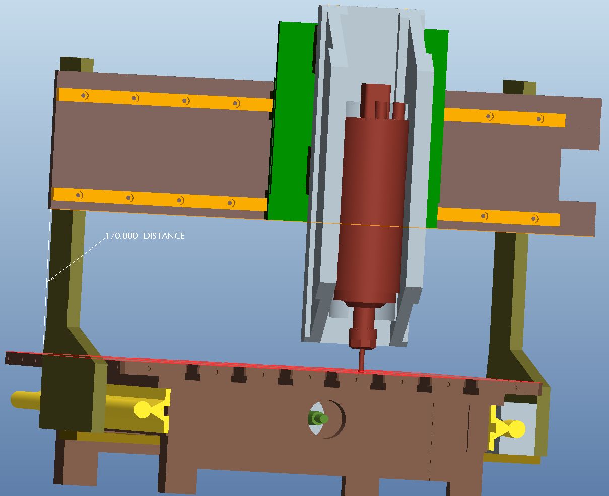

Hello Steam Friends
I am still rigging for the pattern making. As you have seen some pages before, I started a pattern mill project with a friend. Unfortunately he loaned me his for the cylinder patterns. So there was no need to build up my own.
But in the last weeks I started to complete my own pattern cnc mill. The Y-axis is running under the self made table already. Even with CAD design I like the "card board design validation" to get a good feeling of proportions and forth.
Distance will become 200 mm now

Rainer-
Nice looking CNC machine.
I have seen several online that are building similar units.
I guess that is the future of pattern making.
It certainly simplifies making the more complex patterns.
I wonder if people will offer online CNC services as they do for 3D printed parts?
The CNC option seems to allow for a much larger pattern to be made.
Good luck with it, let us know how the software/hardware setup goes.

Yes, this is a usual setup and nothing special. Maybe the German-Over-Engineered cast Aluminum base and the 200 mm z-travel with such a small machine makes it a little special. I don't want to bore you with this: I only wanted to show that I am still alive and still interested in steamboatingPatJ wrote:Nice looking CNC machine.I have seen several online that are building similar units.
For me it's the only way because I never learned how to make wooden patterns. With this technique you give a little more computer power and invest into the scale pan to compensate the absence of skills and know how of long term pattern makers - but still - by buying a Microsoft Word program you don't win the literature Nobel price with a 100% guarantee.PatJ wrote:I guess that is the future of pattern making. It certainly simplifies making the more complex patterns.

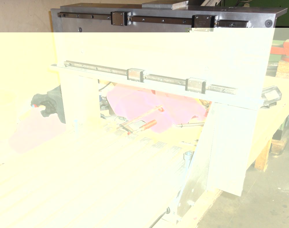

Here the actual status - I found some 100 x 100 x 10 mm angle profile in the laydown - makes it rigid...PatJ wrote:Good luck with it, let us know how the software/hardware setup goes.

That base is a work of art and engineering.
The angle sides look very good too.
