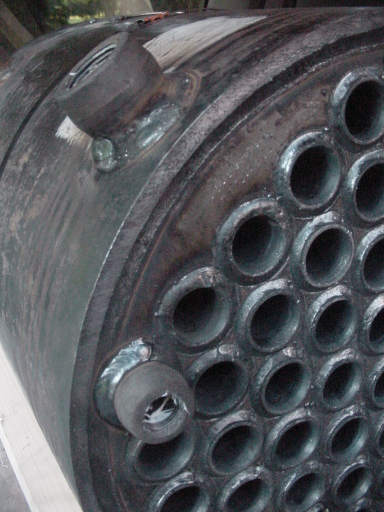

A heavy steel forging for welding onto a pressure vessel is named a "Thread-o-let" or a "Weld-o-let" The threadolet is what we use, it has female pipe threads for screwing on piping. A weldolet is similar, but it has no threads, just a socket to insert pipe, which is then welded in place.
- A-105 Thread-o-lets.jpg (32.64 KiB) Viewed 10227 times
- threadolets.jpg (13.19 KiB) Viewed 10227 times
Re: Boiler questions
I knew I'd get it wrong or at least not quite right.
To be honest, I have bought a lot of Schedule 80 female to female couplers, cut them in half and used them with no repercussions beyond some shuddering from a couple of friends. Just make sure you bevel them for full penetration as per proper welding practice.
" Schedule 80 female to female couplers, cut them in half and used them with no repercussions beyond some shuddering from a couple of friends"
If you want to do it according to code, use a-105 Thread-o-lets. If you are building (or repairing) a non-code boiler, schedule 80 female couplings cut in half (or "half-couplings" as they are sold already short) are OK for many applications. The short "half couplings" are to be used to attach connections to atmospheric tanks etc.
As Mike stated: An important part of this is to have "full penetration" welds between the thread-o-let, (or the coupling) and the pressure vessel. That is done by having a bevel machined or ground on the welding surface, about 45 degrees. AND having the connection held about 1/8 inch away from the pressure vessel before welding. This gap is required. If welding rods more than 1/8 inch diameter are used, then the gap should be at least as much as the welding rod diameter.
Do not use MIG to put a pressure vessel or its connections together , stick welding is the way to go, unless you have fancy welding equipment that would be found in a pressure vessel factory or similar.
