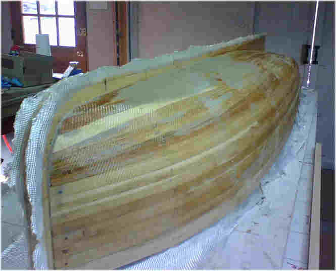

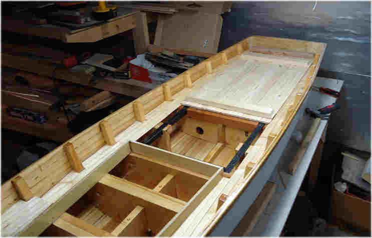

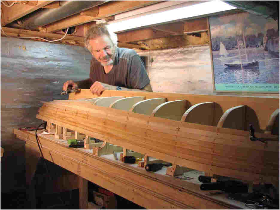

Another modeling option, strip planking. This method is used often to make light weight canoes and kayaks, thin wood strips, fiberglass cloth covering, makes for an excellent steamboat model. The pictures below show a 6 foot long steamboat model I made with these materials for the John Fitch Museum. John Fitch built the first steamboat in regular commercial service, Philadelphia PA, 1790, 17 years before Fulton.
- Interior of Fitch Hull

- Hull covered with fiberglass cloth & resin

- Thin strips nailed to wood frames, 1/4 inch thick soft wood
