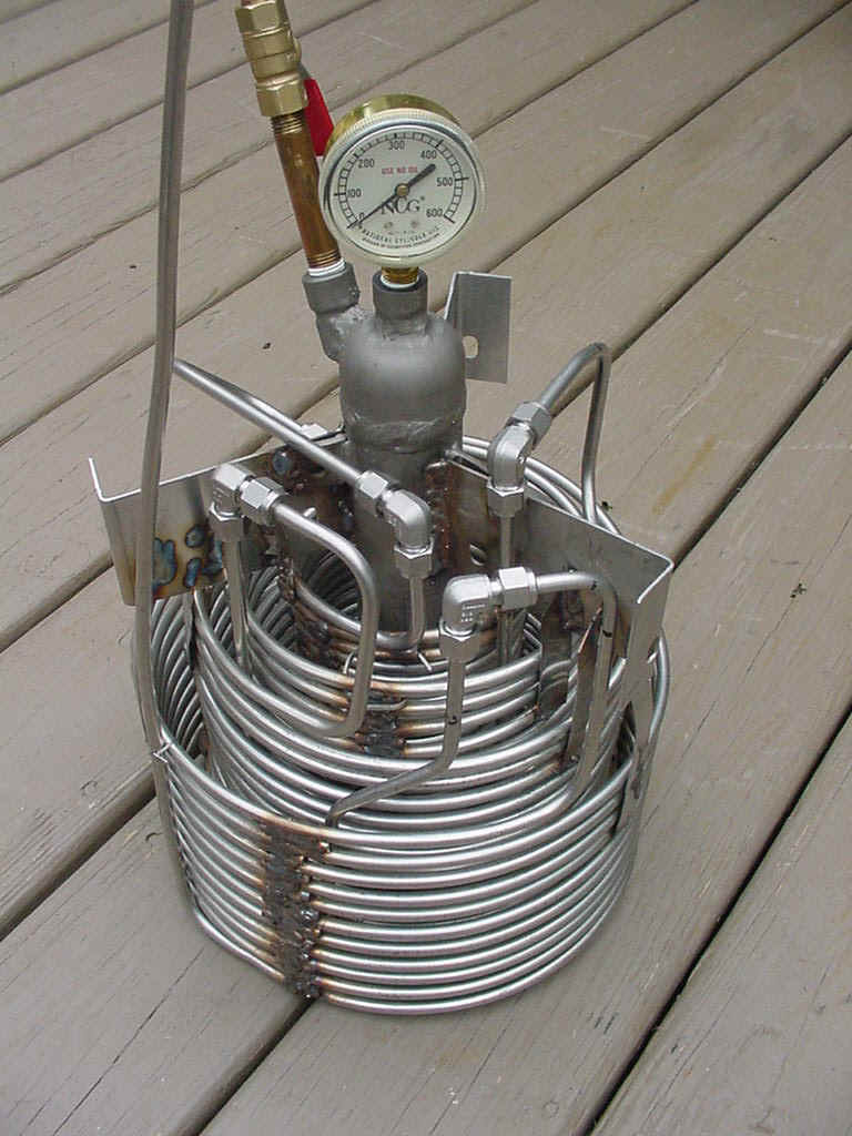

Yes, my first steamboat had a monotube boiler, and worked satisfactorily. The only operational problem I had was when the feed pump intake filter became dirty, increasing the pressure drop leading to the feed pump suction.
Eventually this led to enough restriction that the feedwater flow was reduced. The system was designed to allow flow reduction to about 50% of feedwater pump capacity, and still provide 100% steam flow, so all was well for some period of time.
Further reduction in feed flow resulted in superheat increasing, and for a period of time engine performance was better and better as steam temperature climbed. When steam temperature was approaching 900F, the steam flow was reduced such that engine performance decreased, not enough steam flow. At this point the insulation was burning up on the main steam pipe.
I finally realized what was going on, and changed the filter element, normal performance was restored.
Very little storage capacity in this monotube. If the engine inlet was suddenly shut, the safety valve (175 psi setpoint) would quickly lift, then re-seat, then lift again ....etc. This would happen about 10 times per second, sounded like a machine gun.
Monotube 5000PSI Design Pressure
