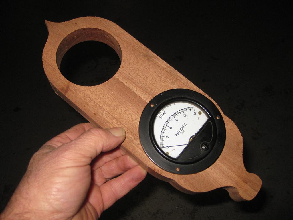

I have an engine driven "generator" on the tug that puts out around 10 amps at 12 volt, and ~ 400 shaft RPM.
I don't remember all of the particulars on it, but it's basically:
Nema 34 72 volt DC brushed servo, 7 amps continuous, 38 amps peak.
Belted about 15:1
The electronics are simple, just one side of a bridge rectifier used as an inline diode to prevent the battery from spinning the "generator" at low RPM.
A simple switch to connect/disconnect to the battery. Sellers around the web have small cheap solid state voltage regulators for wind generator use that would work, but I'd rather just disconnect it if I don't need it.
Then some period correct gauges
Any brushed DC motor will output voltage and current when spun. When connected to a 12 VDC battery, once RPM sufficient for the voltage is achieved, anything above that is current going to the battery.
Belted about 15:1
- IMG_3000 (Medium).JPG (76.83 KiB) Viewed 10811 times

P.S. Ron - love the gauge!
