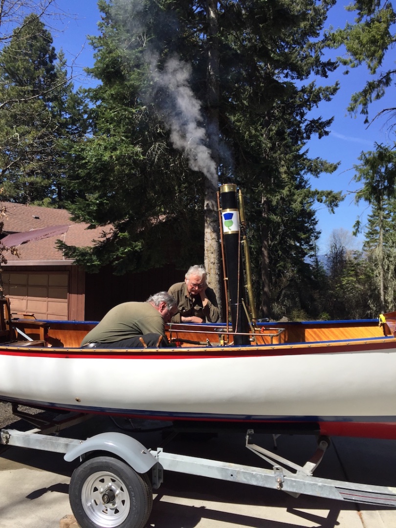

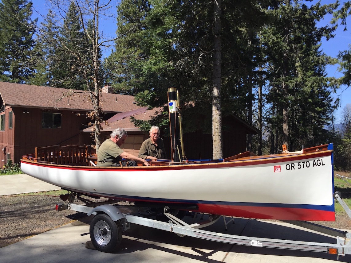

First really warm day this year, temps in the 70s F.
So... First steam test of Steam Thistle! I've been waiting for this for several months.
I have two short movies and don't know how to make them accessible here.
So you get to use your imaginations!
Resulting check list:
Oil delivery and control system works well. No changes required using gravity feed. Pressure is available and functions OK.
Boiler water makeup system works per design with gravity feed.
Propane cold start system work per design.
Safety valves work and set properly.
Engine runs! But the boat will work better in the water when the condenser can do its work.
(I made a condenser bypass system which also works per design.)
Whistle does not work on steam. It works fine on compressed air... Reboot required on design.
Oil burner atomizer needle valve is too sensitive. Modification required. Probably a much smaller valve.
The boiler draft system works fine, with natural draft being sufficient. I did install a stack blower, but just in case...
It could make more steam than required with no condenser, and on the trailer.
A test on the water will reveal more.
I'm satisfied so far. More to come.

Re: Steam Thistle Clauran
Good to see your beautiful boat getting ready for cruising.
Whistle performance is a trying task in my view. I have made many boilers and engines, but every time I make a whistle there are problems, and I have attempted several. They typically work fine on air, but sound terrible on steam. For a few years I had a good Lukenheimer whistle from a locomotive, and it sounded great, but I traded it for kerosene running lights for my sidewheeler. Now I need to find another, or attempt to make one.
Oil burner needle valve, I would recommend a Swagelok needle valve, best quality and good fine adjustment. They retail (with 1 / 4 inch tubing connection) at about $120 US, but you can get them on e-bay for far less. They come with small, medium and large flow capacity, and choosing the right one is important in my experience. If you can tell me your oil pressure I can give you the proper valve selection.
Fred:
Thanks for your reply and recommendation.
Oil feed is gravity, with the steam atomizer providing some vacuum to draw the oil. I can pressurize the oil supply for a cold start up, if required.
The burner oil orifice if a mere 0.059" diameter! And it will obviously provide more oil than required.
The original kerocene burner for the Blackstaffe boilers also had the same size orifice.
And I had no problem generating steam today. So I believe the burner size is OK.
The atomizer steam valve is a quality needle valve, but obviously (now) provides far too much steam flow for that burner.
I will check out the Swagelock valves.
Thanks.
Hmm! She might look a little better if you painted both funnels to match, I'm not much for that knobbly finish on the front one?!?!RNoe wrote: Fri Apr 10, 2020 12:25 am First really warm day this year, temps in the 70s F.
Very nice boat! I really like that stem, nothing on a boat says 'class' louder than a negative rake on the stem.

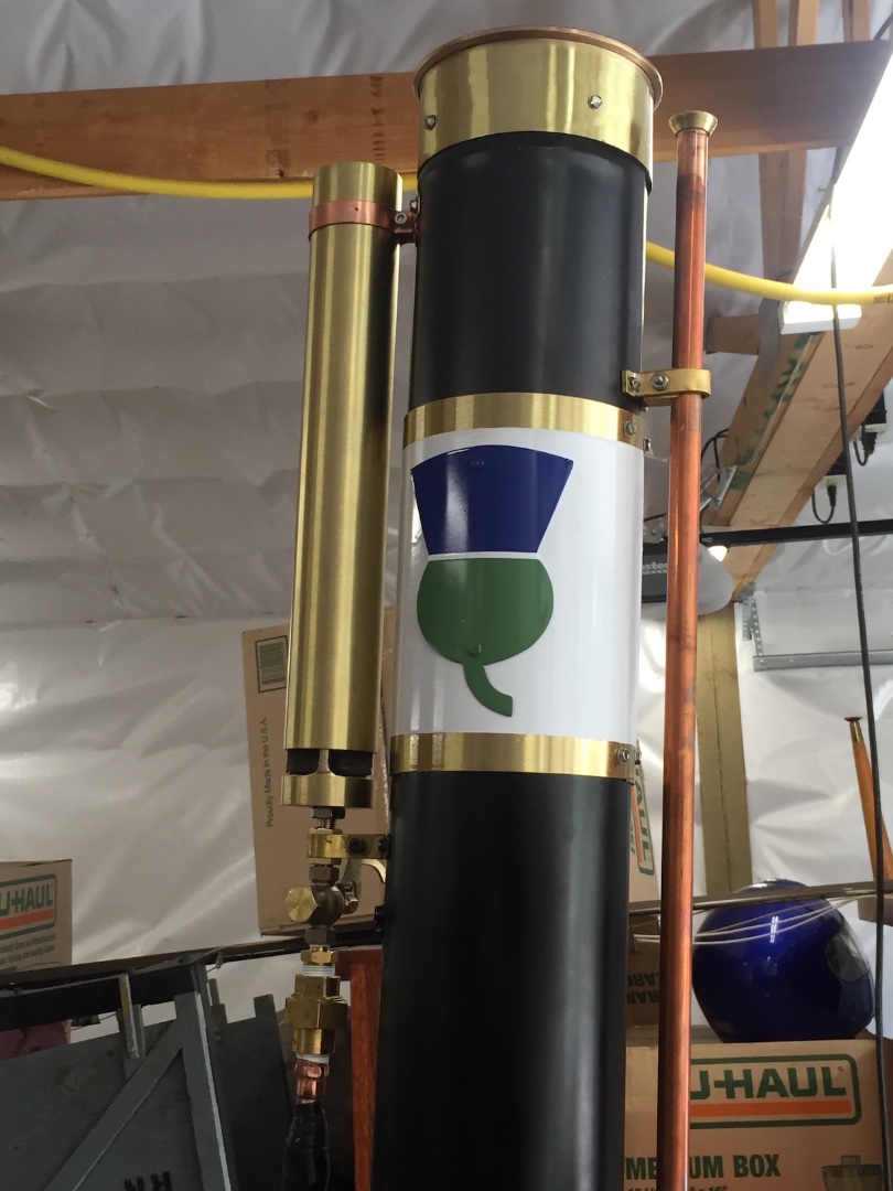

Having gotten over the failure of the steam whistle bell I fabricated, I made a change.
Since the Fed. Gov. is giving us some $$, I spent some on a new whistle from LocoParts, similar to those on my steam locomotives.
Specs: 14" long, 2" diameter, 4-note, cast bronze internal chambers, and weighs 5 lbs with valve!
It will have a pleasant sonorous call. Should sound nice echoing off the water.
Next task is to replace the steam atomizer valve with a more fine-control pressure-regulated two-valve device.
I had one off of old Maggie Steam Launch, which I rebuilt and it's ready to install.
Then another steam test and I get to hear the new whistle.
