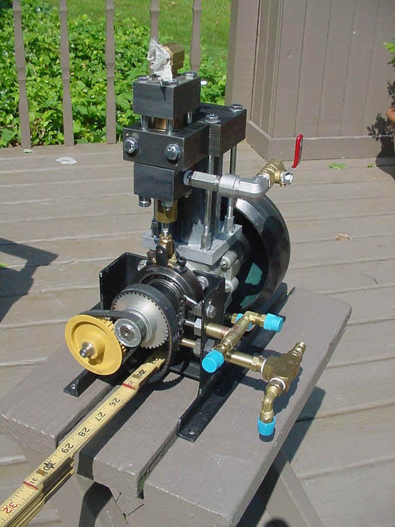

The car top Scanoe needed step-up gearing, the engine running at 600 RPM, and the drive shaft at 1000 RPM. For anything under a few horsepower (including the 1340cc Harley Davidson Motorcycle), toothed belt drive is the way to go. It is silent and reliable, with virtually no maintenance required.
The attached picture shows the Scanoe engine, made from a 4.7 (75cc) chain saw engine. A second toothed belt drive runs the feedwater pump and oil pump, with a ratio reducing pumps' speed. Engine ran 600 RPM, pumps at about 200 RPM, the step up drive (drive shaft was near the ruler in the picture), with about 1000 RPM, then to a 1:1 right angle drive to a vertical shaft, then to the lower end of a small outboard motor lower unit, which had its own gear reduction to about 600 RPM propeller speed.

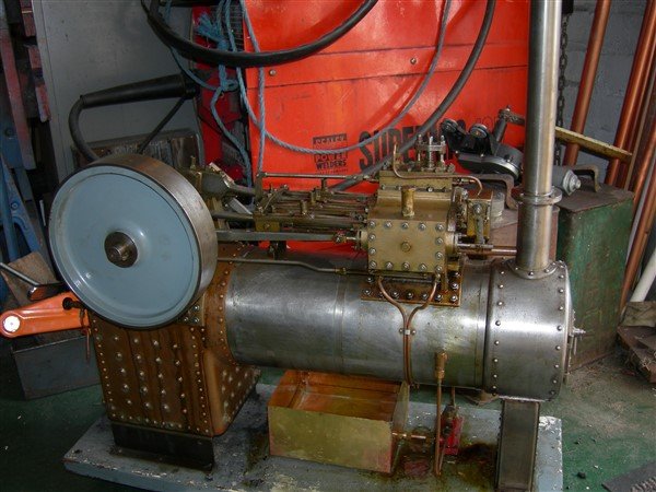

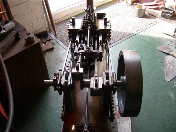

Further machinations on an engine for Pete's little canoe. Locked down and looking for something different to do I remembered a little stationary engine that came my way a few years ago.
Twin Stationary (3) (600 x 450).jpg (64.52 KiB) Viewed 15963 times
Twin, over mounted, copper boiler etc. a very nicely built model. I had never steamed it, though I did hydro it a couple of years ago and ran it on air. I dragged it out from under the bench and filled and fired it. after a bit of a struggle with the fire I did get it to run very sweetly. It will tick over at virtually nil PSI.
Twin Stationary (2) (600 x 450).jpg (68.4 KiB) Viewed 15963 times
I thought to measure it and it has a 2" stroke with what appears to be 1 1/4" bore (guessed from the cyl cover) Running the numbers on it, it's giving a hair's breadth under 0.6Hp at 75psig (safety valve setting. I hydro-ed to 150). Very respectable from something so comparatively small, a touch under 24" long x 11" wide and 22" to flue top. The original question on here was "How heavy would suitable plant be"? The answer to that is this is 84lbs. A bit heavy for a one man job but probably doable. With similar plant this hull should still manage two medium sized adults.
