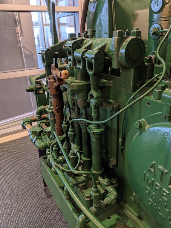

I was at the Columbia River Museum in Astoria, Oregon last week and took some pictures of the pumps on an 75 hp Atlas Imperial diesel engine; I find this sort of pump easy to understand and repair while underway. A simple rocker arm driving a plunger pump with easily opened/rebuilt commercial check valves.
