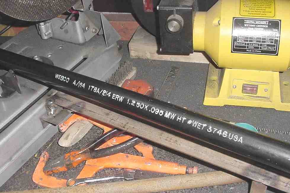

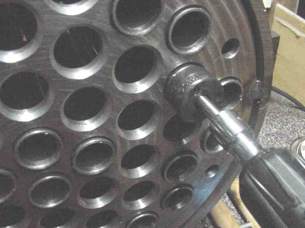

With regard to rolling tubes in place, the ASME Boiler Code requires this, regardless of seal welding of tubes or not. If a boiler is made with tubes seal welded, yet not rolled in place, then there is a very small gap between the tube and the tubesheet. Water impurities tend to accumulate in this space, and harden with time. For a VFT type boiler, the lower tubesheet is getting the highest heat flux and this accumulation in the crevasse becomes a hard ceramic-like deposit. Repeated heat-up and cooldown conditions result in the deposit forcing the gap wider, with the kind of forces the are similar to what happens when water freezing within a pipe or pressure vessel. We all know how ice usually damages the steel pipe. I know of boilers made without rolling the tubes in place, and they generally continue to function OK, but why tempt fate, rolling the tubes is a simple operation.
Many small boilers have used ordinary steel pipe for firetubes or watertubes, however this practice is not recommended. Several specifications for steel pipe are prohibited for use in power boilers according to the ASME Boiler Code, so the first question: what specification of steel pipe are you thinking of using? Note that real steel boiler tubes for our pressure applications (ASTM A178 Steel boiler tubes) have the fine finish and precise tube outside diameter to allow professional tube rolling. If you look at the hours of labor needed to make a proper small steam boiler, and you value your time at something more than $10 per hour, then the economy if using sub-standard materials comes into perspective.

Re: Stainless steel tubes
Boiler Fabrication Margaret S VFT Boiler
Rolling Tubes.jpg (49.23 KiB) Viewed 8473 times

fredrosse wrote: Sun Oct 17, 2021 5:05 pm With regard to rolling tubes in place, the ASME Boiler Code requires this, regardless of seal welding of tubes or not. If a boiler is made with tubes seal welded, yet not rolled in place, then there is a very small gap between the tube and the tubesheet. Water impurities tend to accumulate in this space, and harden with time. For a VFT type boiler, the lower tubesheet is getting the highest heat flux and this accumulation in the crevasse becomes a hard ceramic-like deposit. Repeated heat-up and cooldown conditions result in the deposit forcing the gap wider, with the kind of forces the are similar to what happens when water freezing within a pipe or pressure vessel. We all know how ice usually damages the steel pipe. I know of boilers made without rolling the tubes in place, and they generally continue to function OK, but why tempt fate, rolling the tubes is a simple operation.

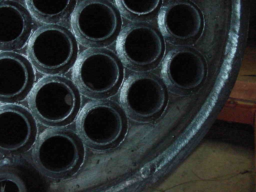

Seal Welds
TS WELDS.JPG (57.54 KiB) Viewed 8467 times

Post by lostintime »
I do not mean to beat a dead horse, but.. when I was referencing tig welding in place I mean having the tubesheet backbeveled and open clearanced to the "pipe" tube so full penetration welded, no micro crevasses for mineral build up ( I am experienced in pressure vessel/piping welding, but in industrial refrigeration, ammonia systems, not steam, I "design, build, and run the "steam" machines backwards" for a living). Unfortunately i don't have a copy of the astm code for the "backwards" side of things. Using energy to move heat, I'm credentialed, backwards.. I'm trying to learn...conceptually very similar, but lots of devils in the details.
