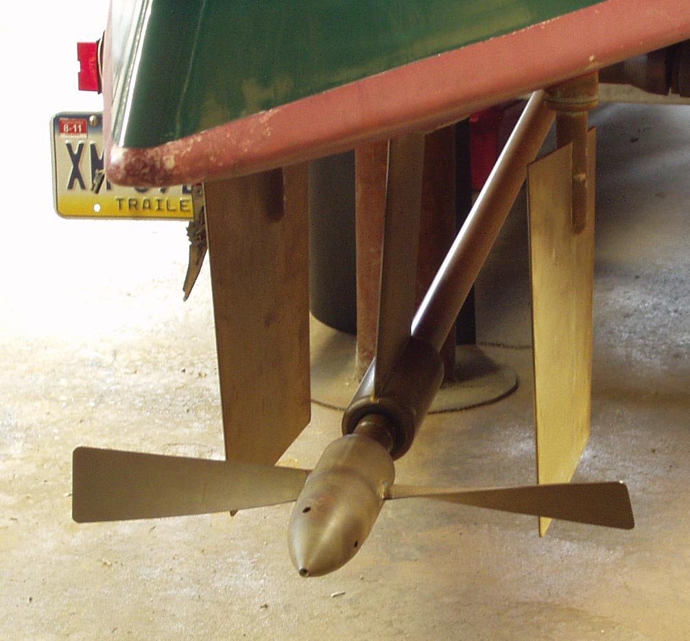

"....So for example an 3 x 17 x 26 prop. would be adequate? Or would you recommend an 2 or 4 blade prop?"
Comparing the recommended prop, 18 inch diameter x 27.5 inch pitch at 300 RPM, vs your propeller with 3 blades x 17 inch dia. x 26 inch pitch, which is about 6% less pitch, this can be accommodated with about 6% higher shaft RPM, say 317 RPM No significant difference here.
As to the number of blades, this depends on the blade area required, and you would probably be OK with a typical motorboat propeller having 2 blades. A "steam wheel propeller", having 3 blades which are much thinner (less blade area and less blade thickness) than typical motorboat three blade propellers would be most ideal. The typical three blade propeller for motorboats has somewhat more blade area than you would need, however satisfactory operation with this type propeller is OK, just a bit less than ideal.
Note that a propeller of 17 or 18 inch diameter for motorboat service is typically OK for over 30 knots with several hundred horsepower IC engines. running at a couple thousand RPM. Therefore they are typically far more robust than necessary for our steam launches running at only a few horsepower.

How does one determine necessary blade area for a given displacement and desired speed?
- Kelly Anderson
- Posts: 186
- Boat Name: Vividus
- Location: Strasburg, PA
Re: Upscaling a Hasbrouck engine
I had good luck using the formulas in Dave Gerr's Propeller Handbook. That's where I arrived at the 22 sq. in blade area for Reciproca's 17"x26" prop.
