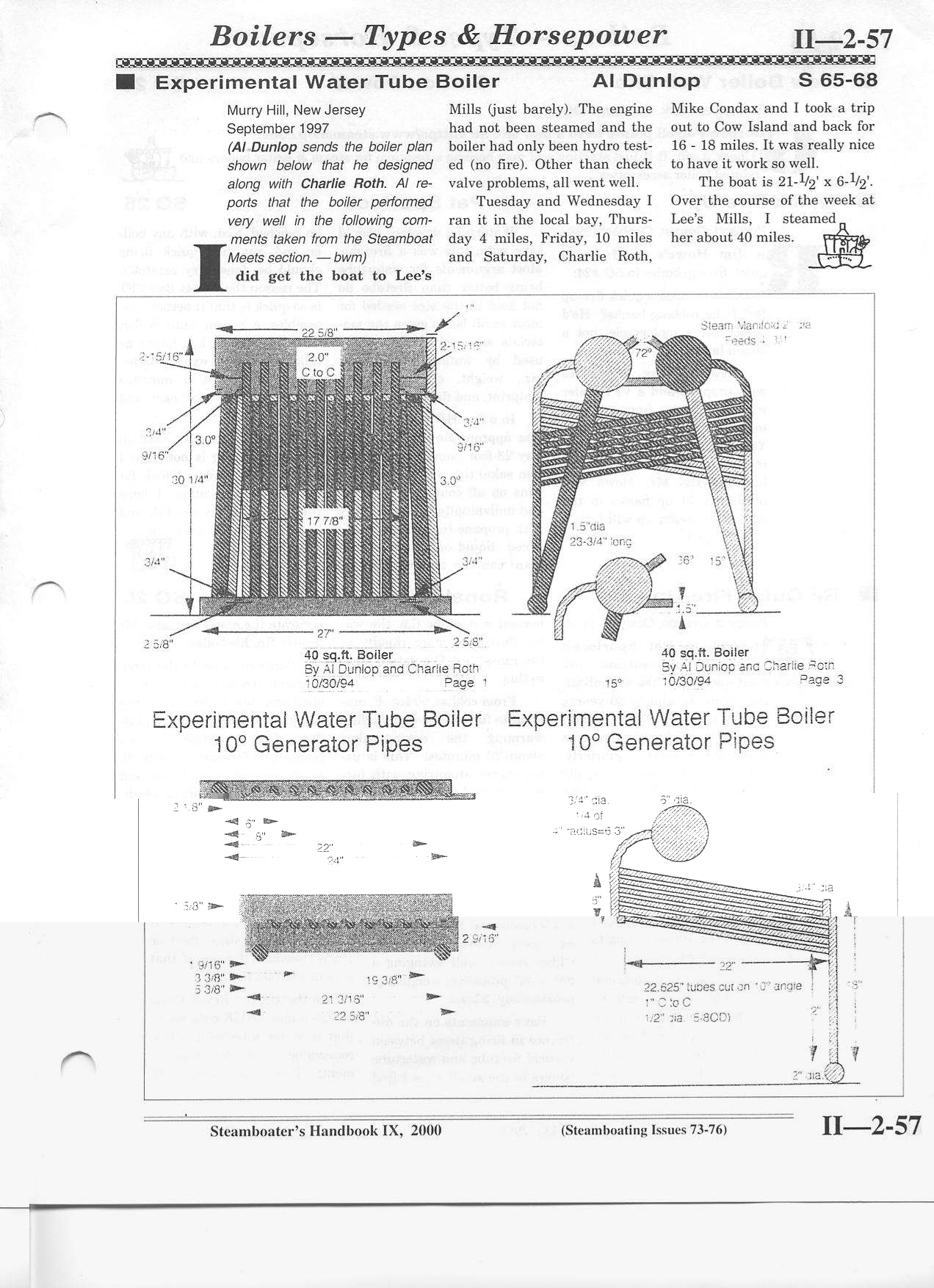

Well, the boiler is less like a "Roberts" and more like a "Worthington"
The tube banks are much like B&W, but each row is in a separate header and cross alternately beneath the main drum that runs lengthwise. John built it with a mud or foundation ring that encircles the firebox. The circulation should be quite good, much like a B&W.

John's boiler looks like a version of Al Dunlop's boiler from Steamboating.
Here's the page from the Handbook
