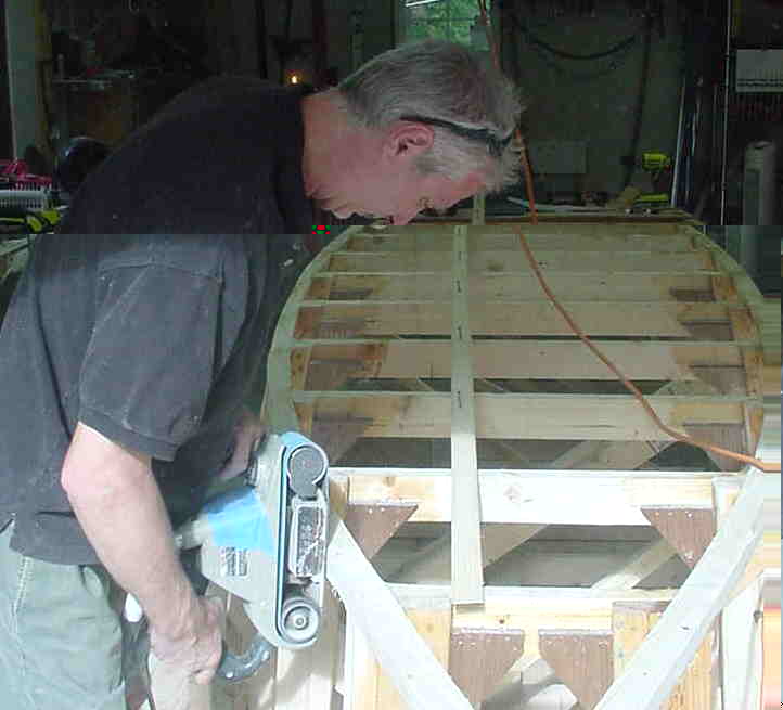

Dressed Chine Logs to match frames

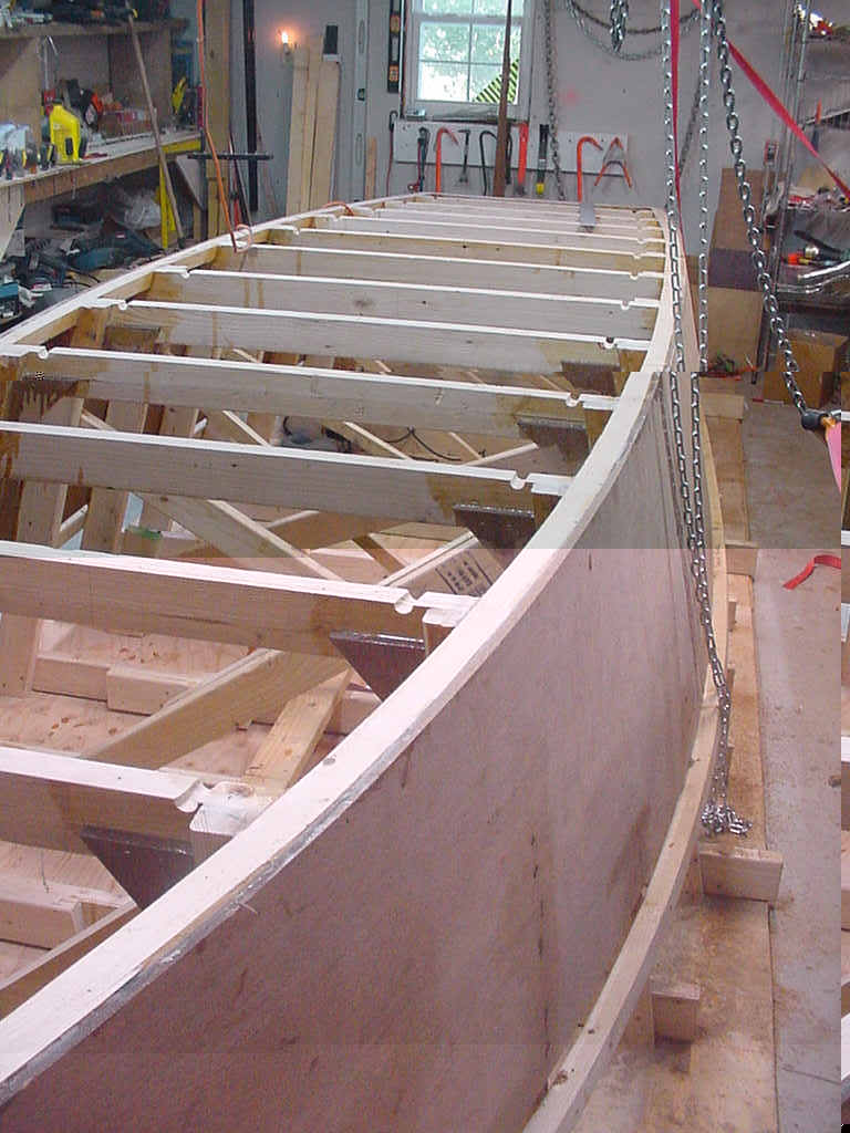

Epoxied sides onto frames

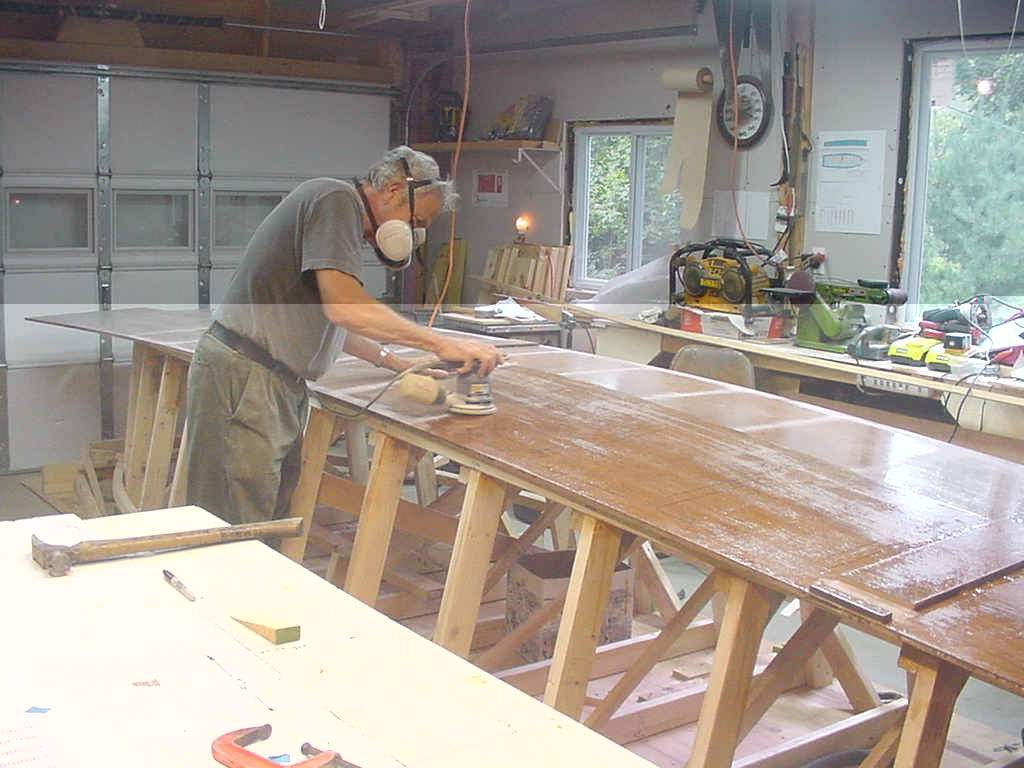

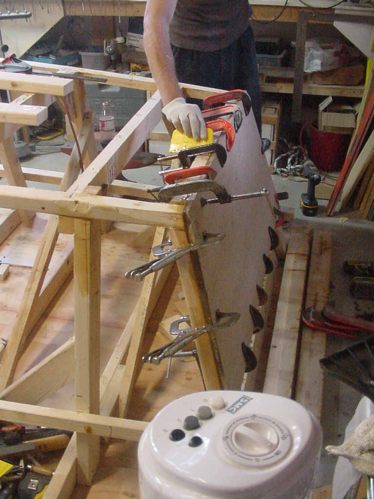

- 60 Grit and a Godzilla Belt Sander
- Saturday-Dressing Chines.jpg (27.49 KiB) Viewed 26366 times

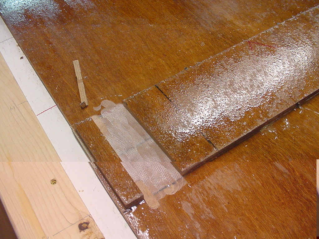

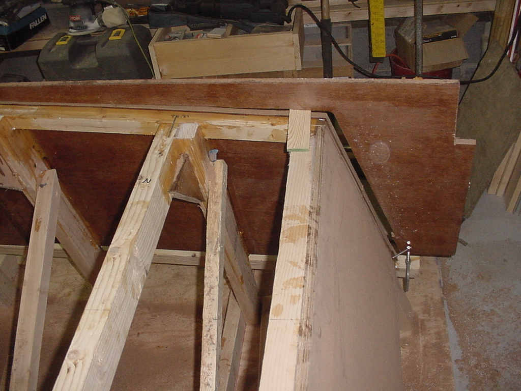

- Cut away butt blocks near Chines
- RoutedButtBlock for Chine Log.jpg (109.36 KiB) Viewed 26366 times
- Rule No 1 of Boatbuilding: There can never be too many clamps.
- Friday Transom On.jpg (81.07 KiB) Viewed 26366 times

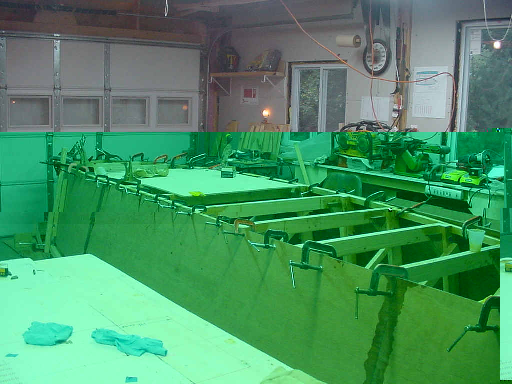

- Hull sides epoxied & screwed
- Sunday Sides Epoxied.jpg (72.2 KiB) Viewed 26366 times
- Sanding sides where side frames are glued to plywood.
- Sunday, Sanding Sides before Epoxy.jpg (79.91 KiB) Viewed 26366 times

Hi Fred,
Your getting on with the job, and now your into sanding epoxy...messy job.
The dust is light and it settles everywhere. I am really glad to see you using the respirator. A suggestion that will help keep things cleaner in a small shop. Get yourself a large window fan and hang it in the shop over head. On either side of the fan, mount a forced air home heating furnace air filter. Let it run while your sanding. This rig will take a lot of the dust out of the air for you, and it will keep some of the dust from settleing on ALL horizontal surfaces.....you should have seen my shed when I was done....WOW...there was a lot of dust in there!
I have the same random orbital sander and I can tell you the dust bag doesn't catch the dust that it needs too. If you have a shop vac, get the adapter and use it when your sanding.
Keep using the respirator!....try to sand when the epoxy is fully cured. Sanding while the epoxy is still "green" promotes dust with lots of catalyst in it and raises the risk of allergic reactions. Most epoxy boat building ...as I am sure you have learned by now, is preperation...the actual bonding doesn't take long....its getting ready to do it that does...
Just be careful of your health.....Ok Friend?
Warm Regards,
Dave
Warm Regards,
Dave
Thanks for the input. Our "Godzilla Sander" has a shop vacuum attached, and it catches almost all of the epoxy/sawdust. That sander is way too heavy to use in preparing the sides and bottom for new epoxy (just lightly sanding the old epoxy application), but I think I can easily rig a vacuum pipe to the orbital sander.

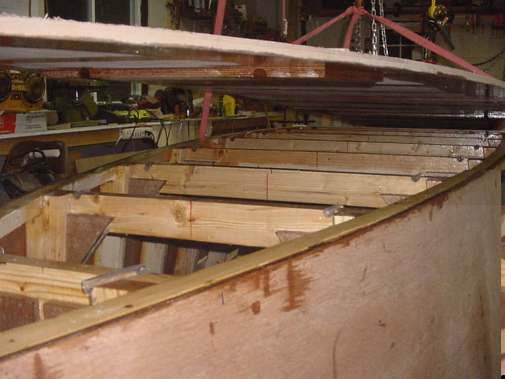

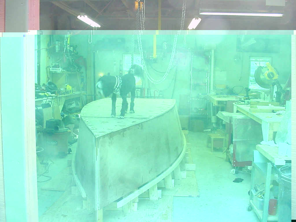

Thursday - Put the bottom on the frame. Lost both my helpers, so I had to do everything by myself, including maneuvering the 4 ft x 20 ft x 5/8 plywood bottom sheet. Thanks to pulleys and a small winch, it was managed. Took me about 20 hours of work total, very hard on this old man.
- Excess side panels to be trimmed
- excess sides at stern.jpg (69.26 KiB) Viewed 26321 times
- Bottom Ready to flip.jpg (75.42 KiB) Viewed 26321 times
- Ready for Bottom
- Inverted Hull ready for bottom.jpg (85.35 KiB) Viewed 26321 times
Thursday - Bottom on Pictures
- Mara Inspects the Bottom.jpg (58.05 KiB) Viewed 26311 times
- About to attach bottom.jpg (68.39 KiB) Viewed 26311 times

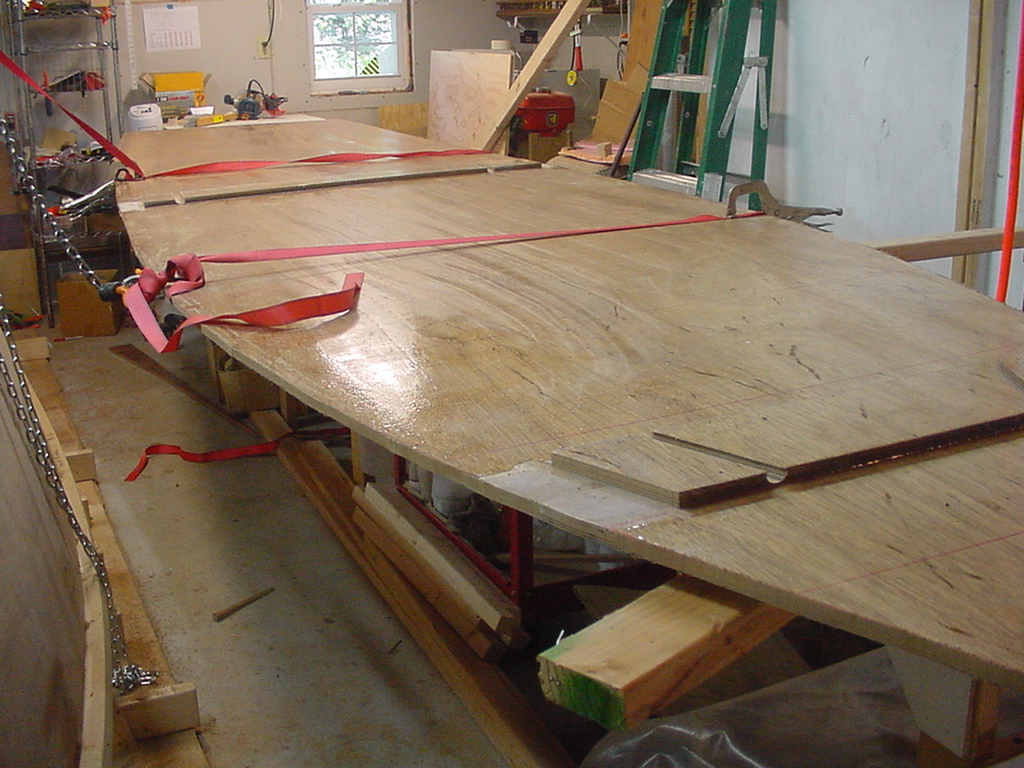

Applied 9oz cloth and epoxy to the bottom. The bi-axial cloth had an extra "binding thread" that made the cloth thicker, took over a gallon of epoxy to wet out and fill the weave. A gallon of epoxy onto 70 square feet is more thai I planned for, so I decided to switch to ordinary 10 oz cloth for the sides.
