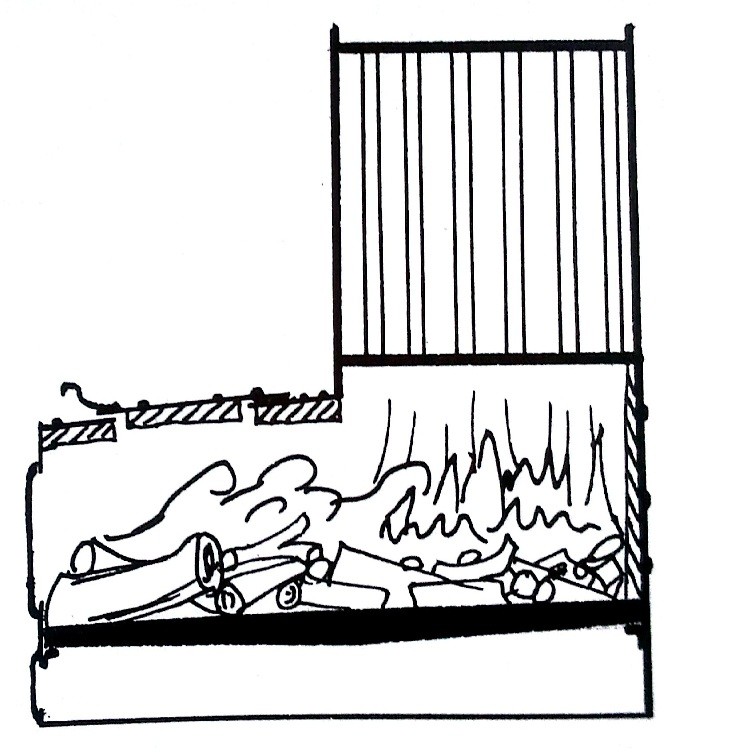

Going back to the orignal question ... To burn drift wood which is usually damp you need to have something like a Dutch oven
There was a steam powered saw mill near here that used all off-cuts to fire the boiler. They used a similar setup (on a much larger scale). Essentially the wood was burned separately and the hot combustion gases passed over to the boiler.
The above illustration is out of Steamboats & MSL Jan-Feb 61 pg 24. The extra combustion space allows the wood to dry.
Oil seems easier :lol:
