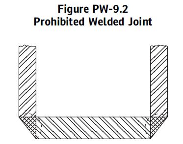

Josh, the 1/4 inch thick shell is OK for thickness, but I would strongly recommend you use the ASME minimum of 5/16 inch plate thickness for the tubesheets and bottom ring. As to putting the sheets inside the shell and furnace tubes, this is not really difficult. You can make these sheets with a perimeter gap of 1/8 to 3/16 inch (sheet diameter 1/4 to 3/8 smaller than shell ID) and still get a good full penetration weld. As Mike states in the last post: "it only took me a few minutes with my killer disk grinder to make the tube sheet fit close enough for a good TIG root weld.+
Why does the ASME Code require tube sheets to be positioned and welded inside the shell? Welds often have enough composition difference and often imperfections that can weaken the joint. With the tubesheet not placed within the shell, but placed on the end of the shell, the weld alone holds the tubesheet to the shell, and it is in pure tension, (or tension plus bending, which is worse). If there are imperfections in the weld, or the weld experiences cracking (a common occurrence in many pressure vessel welds) the joint can fail catastrophically. With the tubesheet placed completely within the shell ID, the weld can loose much of its strength, but will still block the tubesheet being driven to failure due to shear stress. The weld could basically turn into "Swiss cheese" and still its presence would block the potential for pressure to drive out the tubesheet.

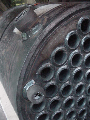

THESE ARE BEST, SOME USE SCHEDULE 80 THREADED "HALF COUPLINGS" WELDED TO SHELL

Prohibited Weld.jpg (21.17 KiB) Viewed 9798 times
A-105 Thread-o-lets.jpg (32.64 KiB) Viewed 9798 times

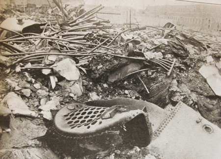

"I'm not trying to incite a rebellion or anything I just don't see any reason to pay the extra $ If I don't have to, for something that seems a little overkill."
Good choice of words Josh, that is, the last word in your statement....
ford boiler explosion.jpg (46.89 KiB) Viewed 9796 times
Re: From napkins to fabrication VFT boiler design
He's right, Josh. There is a reason for doing things a certain way. Hard experience, often bad. And a hydro test doesn't catch everything.
As a related example, the FAA has a wonderful publication on certain things NOT to do when building a home built airplane. Some of them seem quite innocuous until you think them through and then they make your face turn white.
The energy release from even a very small boiler is amazing. When I was a young tad living in the country we put our garbage in a hole in the ground and burned it every so often. In spite of some awareness on the family's part, a jar of some liquid stuff would end up in there and the resulting kablooie would nearly empty the hole. I always stood back a ways when tending the fire.
A short Google expedition with the words. "Boiler explosion" is educational.
