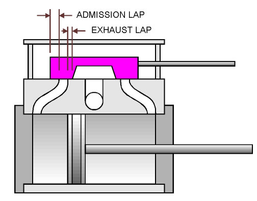

Jon, if you could measure some fundamental valve dimensions, that would help with the setup.

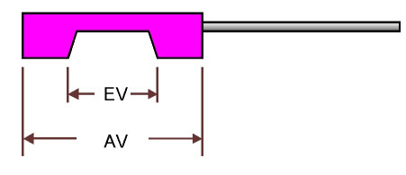

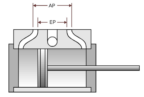

The first picture defines "Admission Lap" and "Exhaust Lap" both measured with the valve in mid-position. The best way to get these dimensions is by measuring according to the diagrams which follow, two dimensions from the valve itself, and two dimensions from the port face.
The final dimension needed is the stroke of the valve, which is twice the eccentric throw.
