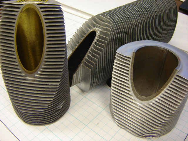

FINS HELP WITH GAS HEAT TRANSFER
extended surface tubes.jpg (42.55 KiB) Viewed 10602 times
