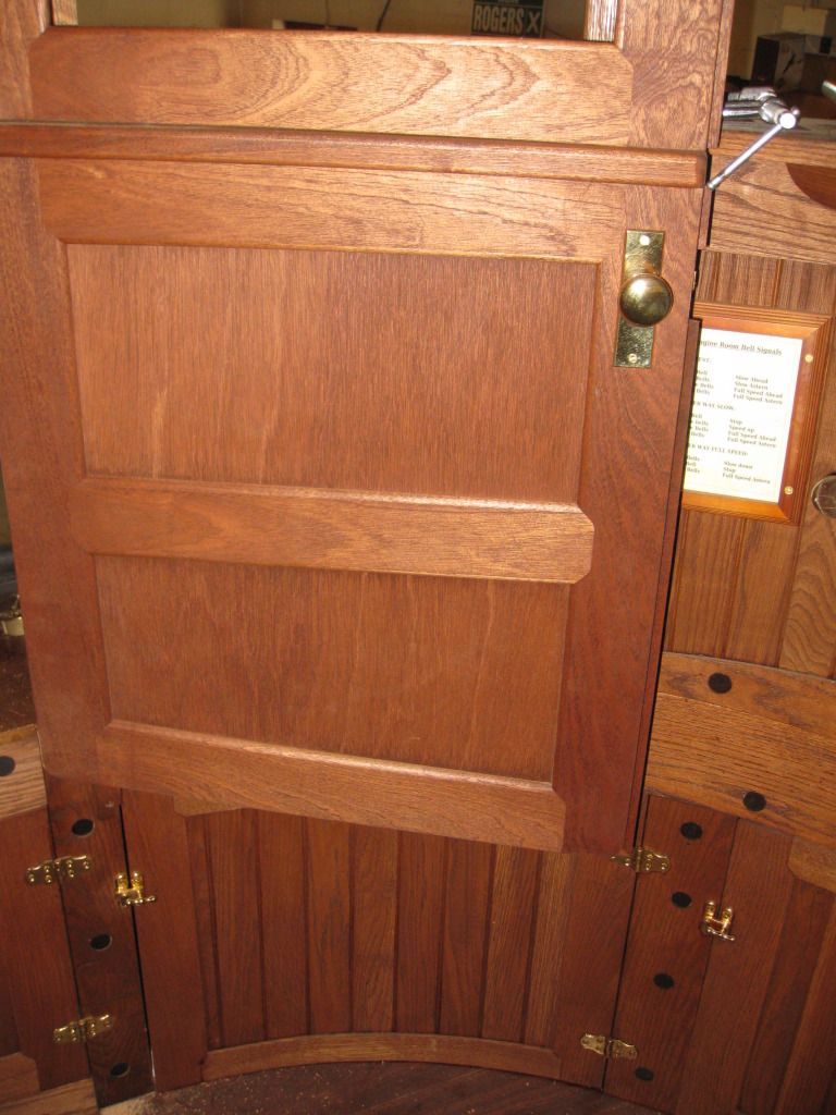

Here is the port wheelhouse door. It's made in two sections, a brass bolt in the middle holds then together to act as one door or undo the bolt and open the window section only. And too, those are lift off hinges I made. The doors can be removed easily.

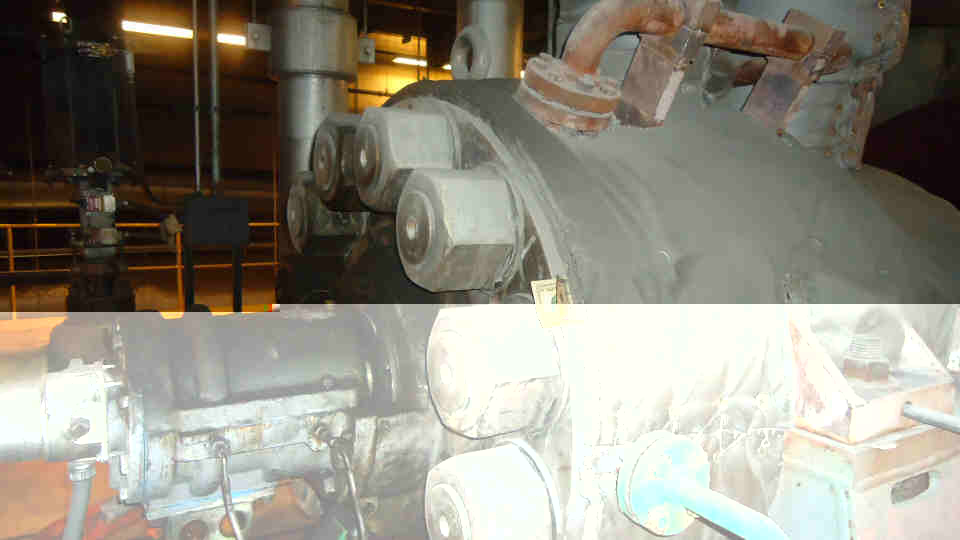

All of the work (horsepower) energy put into the shaft of the pump shows up as heat in the recirculation fluid circuit. The relevant thing here is the energy input to the circuit, compared to the ability to take away this energy by heat transfer to whatever cools the system.
For a Hypro pump in recirculation (not really producing any pressure, and not using much power), the input energy is small, and the pipes and pump casing exposed to the atmosphere provides enough cooling so that there will be no significant heating for your installation. My Hypro pump is rated for 140F maximum temperature, and it would be difficult to get even 1F temperature rise in the pump with ordinary recirculation circuit.
On large power plant feedwater pumps this is a very relevant issue, where 15,000 horsepower is put into a pump that is a couple of feet in diameter and a few feet long. These pumps typically heat up the water about 10F-15F per second, and if a healthy flow is not maintained, temperatures destroy the pump very quickly. The attached picture shows a 15,000 horsepower boiler feed pump, with big nuts holding it together. I put a $$bill in the picture for scale, don't think I have a socket wrench big enough for those.
