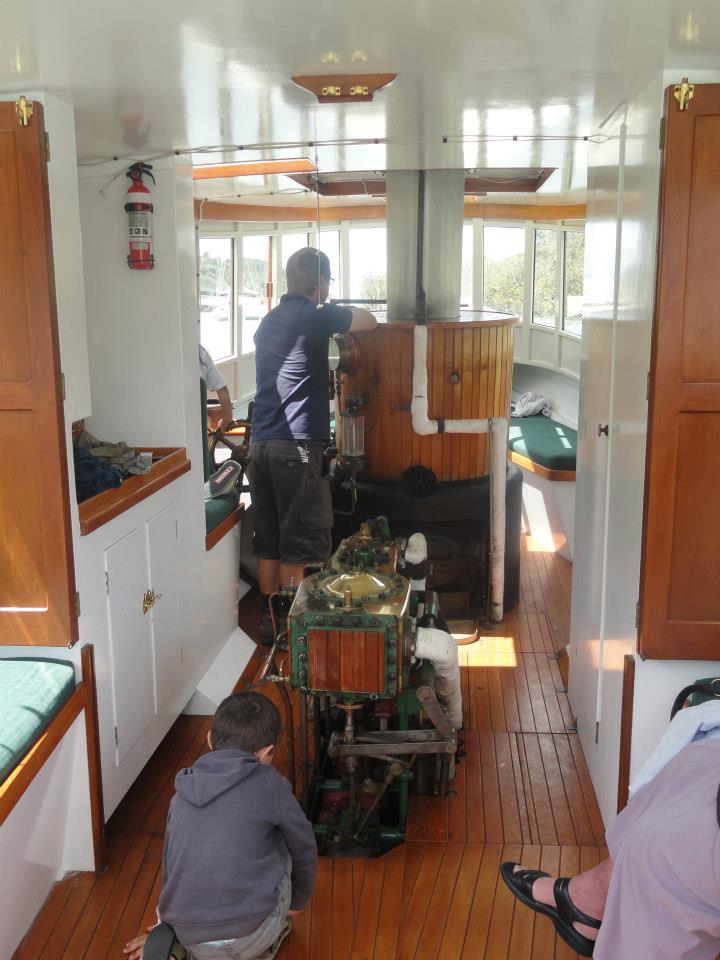

B) Tube sizes and retarders. I've run VFTs with boiler tubes of 3/4 inch ID up to 1 3/4 inch ID. In my experience it is only the larger tube sizes, over 1 1/2 inch ID, that need retarders. Zeltic has 1 1/4 ID tubes and the retarders actually have a negative effect, as they reduce the draft and contribute to soot build up in the tubes. As a result the draft enhancing blower is used more often. The same performance can be achieved without any blower with no retarders in the tubes. By contrast another boiler with 1 3/4 ID tubes was hopeless without retarders, the gasses just raced up the middle of the tube and out the top. For no extra coal, the boat speed increased by at least a 1/4 by using retarders, although soot blowing needed to be more frequent. So the conclusion is, have smaller tubes, no need for retarders.
The smaller tubes combined with no wetleg results in a lot of effective heating surface within the diameter of the boiler. Now if we make the diameter as big as possible and keep the tube size down that results in a lot of tubes, and a very effective boiler. The best steaming boiler I've ever operated is the big dry furnace VFT boiler in S.S. Kapanui. The boiler has I think about 125 1 inch ID tubes, all only 25 inches long. It provides more than enough steam for the 30hp Simpson Strickland compound driving a 37 foot boat. It is also a fast steamer, coming into full steam in 25 minutes if we set a good fire. If i were able to reboiler Zeltic, i could just build a smaller version of it as it is by far the most effective boiler of its type.

- Kapanui.jpg (88.46 KiB) Viewed 8380 times
