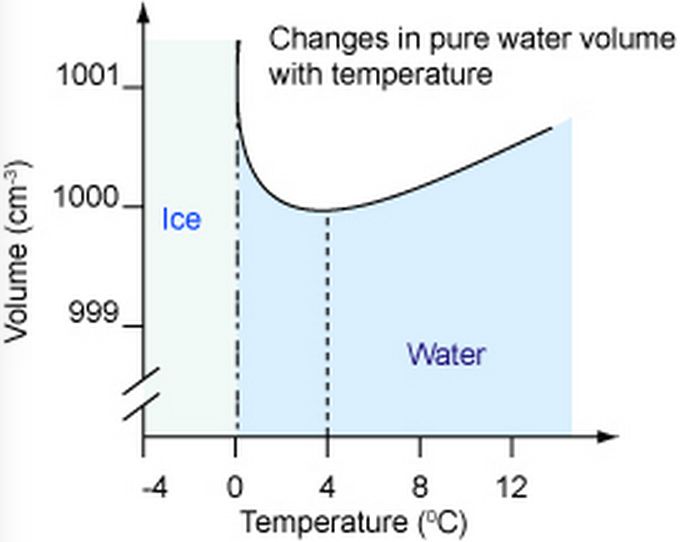

fredrosse wrote:CB is thinking transient conditions, where the heat gets to the metal, but not to the bulk of the water, that condition is rare, but might happen with some special circumstances.
The steady state / isothermal case is where the material of the piping and pressure vessel has a large thermal coefficient of expansion. PVC and CPVC have thermal expansion coefficients several times that of steel.
However, even steel containers can have more thermal expansion than several liquids. A good example is water, heated from 33F to 39F!
