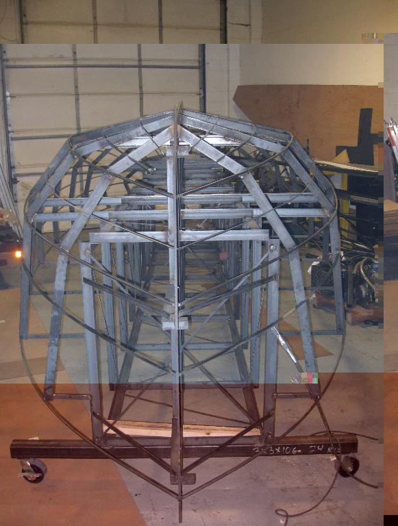

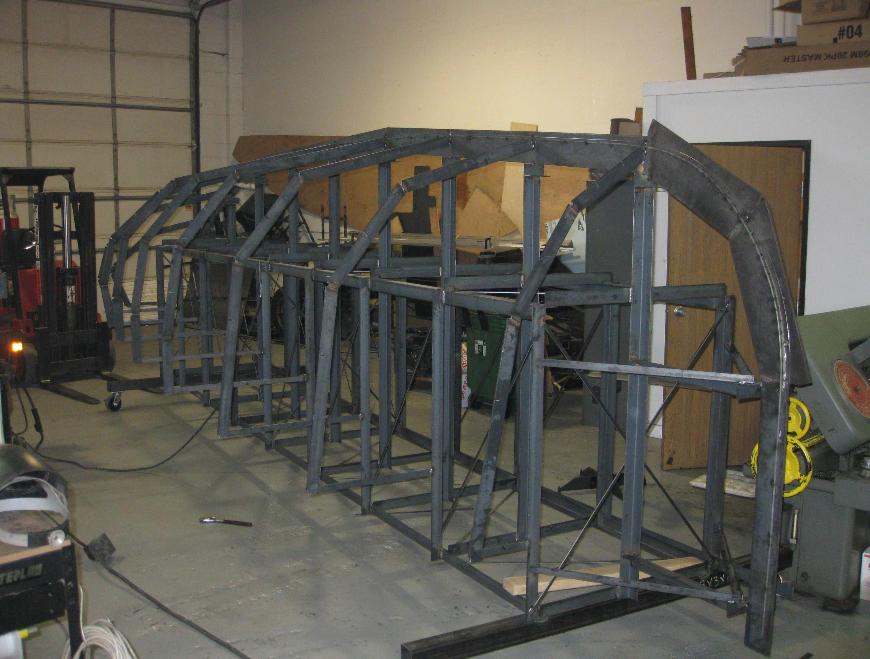

That is a good looking strongback. One suggestion I have and what I did is put casters under it so it can be moved around, makes it much easier to work on.

Hi DT thanks for the thought, I am hoping that I won't need to move the Jig before the hull is ready to lift off. For now I am happy with it sitting on the ground where I have it set up dead level. unfortunately my floor is not as flat as I would like, so moving it around is a little problematic. Having said all of that I will probably want to take it outside when sanding the epoxy so it may end up on wheels later on.
