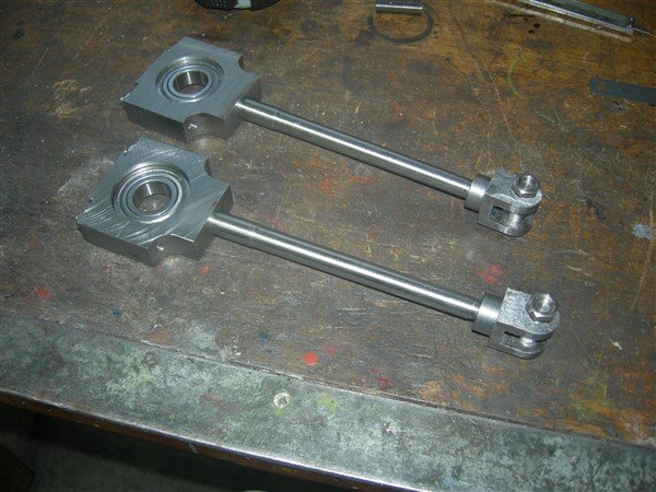

8" con-rods, giving a stroke/rod ratio of 2.42424 etc.
I don't think it will look ungainly or over-tall.
Now I'm wondering should I make them a fancy section . . . . . :roll:
Referring to the other thread "And Now or the Twin" I finished rounding the small-end yolks and screwed them to the con-rods. Then I discovered the faux pas! Measuring the centres, they seem to be (ARE!) 9" instead of 8". :o That would push the ratio out to 2.7ish. I must now contemplate if it's worth reducing them back to 8". This is what happens when you keep putting projects down and picking them up again months later! :roll:

Despite there being no reason not to leave the extra length on the rods, pride (it comes before the fall), devilment, determination, whatever, I decided to reduce them anyway. Carefully re-measured, marked, set up in the lathe, picked up the thread and cut. No problems! (?) Having completed, I placed my largest digi vernier into the bearing holes and Aaagghhhhhhhhhhh ( :? the fall?) it seemed under-size. Then I remembered that with that vernier you need to add 1/2" to all inside measurements. :oops: :lol: Dohh!
Con-rods (8) (600 x 450).jpg (70.84 KiB) Viewed 11941 times
Checking both they are equal within 0.003" centre to centre, and weight difference just on 0.3gm. I'll live!
