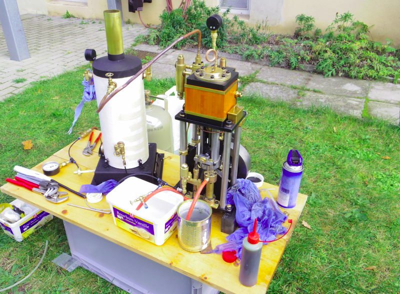

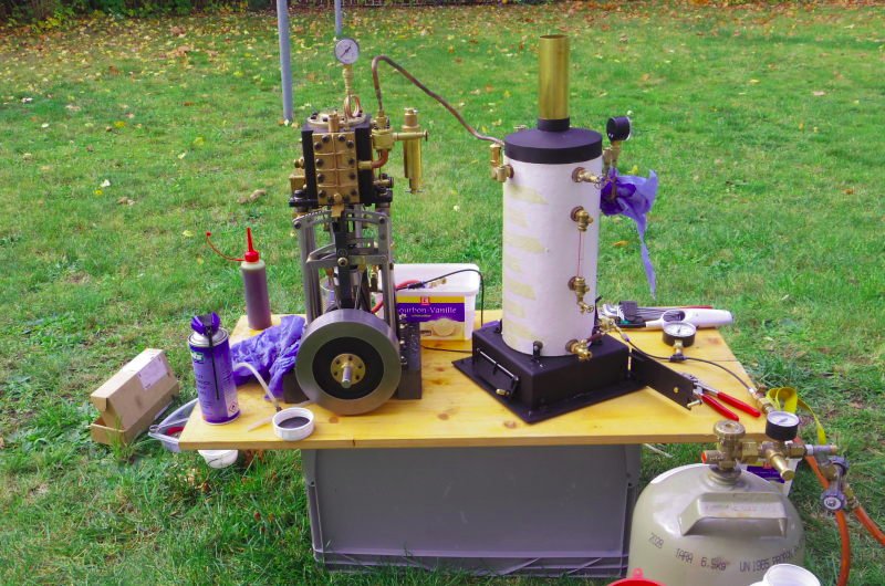

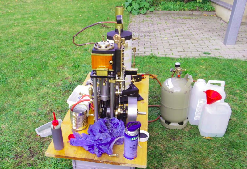

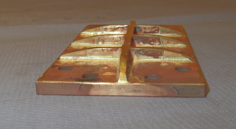

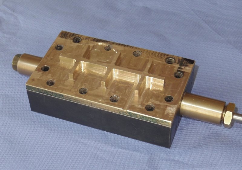

Hello,
today i have tested the engine with the balanced D-valve and the new pumps. The boiler is a bit small for the job but it works. The burner is a ceramical one with a diameter of 125 mm and the normal output is 11,5 kW.
Here you can see it run - https://youtu.be/O9kkZjXPH2Y
to be continued
-Dietrich

Balanced slide valves reduce friction and free-up the engine. They do this by reducing surface area exposed to the force of valve chest steam pressure pushing the D-valve against valve face. Another benefit is the associated valve gear (die blocks, bushings, pins, etc) lasting longer.
Piston valves effectively have near-zero force pushing against the valve face. Essentially a "balanced" valve by nature of their construction.
I'm not sure how a piston valve would wear out any faster than a slide valve or a regular cylinder piston/wall... If the valve is vertical as in a lunch engine (gravity is in its favor!), the stem is supported by a guide that is in good order, then the only lateral forces would be from the rings on the cylinder wall (if so equipped). In theory that would require little to no lubrication if running saturated steam much like what many claim with slide valves (If supported by a proper guide, how is a piston valve much different from the piston in the cylinder???). Now if someone selected rings with too much spring to them, or port faces without any ligaments I can start to see issues... But then I would say, "Conventional slide valve-trains wear out, balanced slide valves fair much better, and poor piston valve designs wear out."
Foreign bodies on the valve face are another story altogether... With a steel boiler, one should never run a steam line without a strainer. I have some pictures of wonderfully scored valve faces if you don't believe me... On an internally lubricated engine no less.

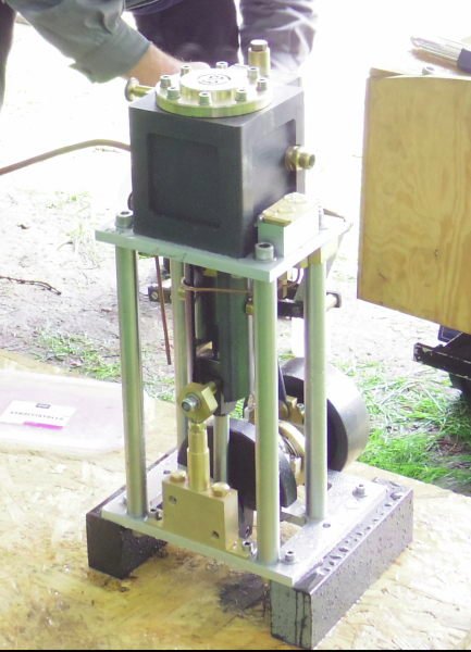

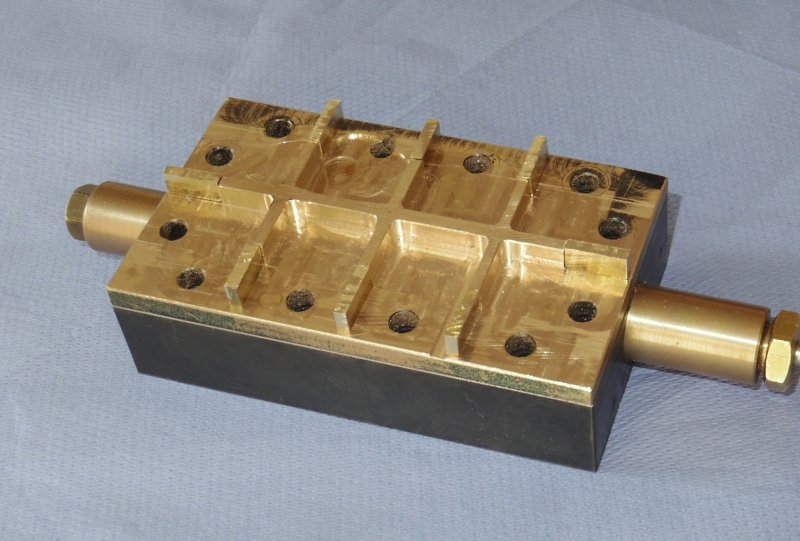

Did you make a different valve cover also?
Posts: 290
Hi Wesley,
yes and no, i have built a new from the old material. Because the old was very massive i have removed a lot of material and soldered some little parts so it looks like a casting similar to the old marine steam engine covers. Then the time was come for filing and sanding. ;) ;)
Then i have milled a gap at the inner side so i could mount the cup of the balanced valve. To get a smooth surface was a bit tricky.
to be continued
-Dietrich

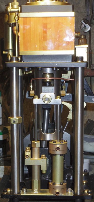

Hello,
when i've got the engine there was only a feedwater pump.
Because i want to run it with condenser i had to built also a condensate pump. So there was built a new pump unit with a smaller feedwater- and a three-valve-condensate-pump at a baseplate with identical dimensions as the old one. Both pumps are picked up by the crosshead with a yoke. The piston rod and the plunger are long guided.
to be continued
