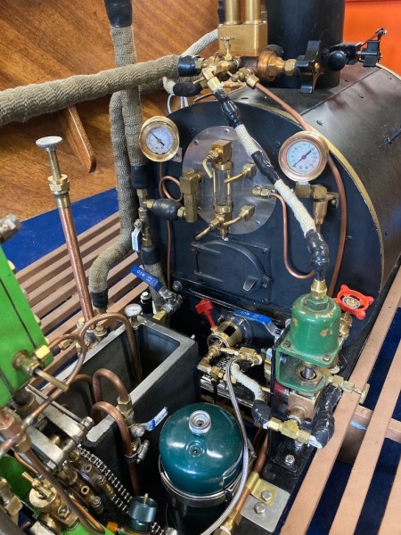

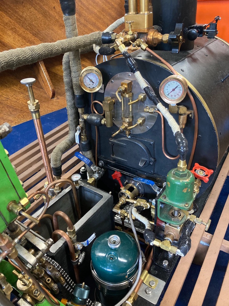

Pic attached of the 1 pound propane fuel tank in position. I will carry spare tanks aboard the boat.
It is easily replaceable or refillable from a larger standard BBQ tank.

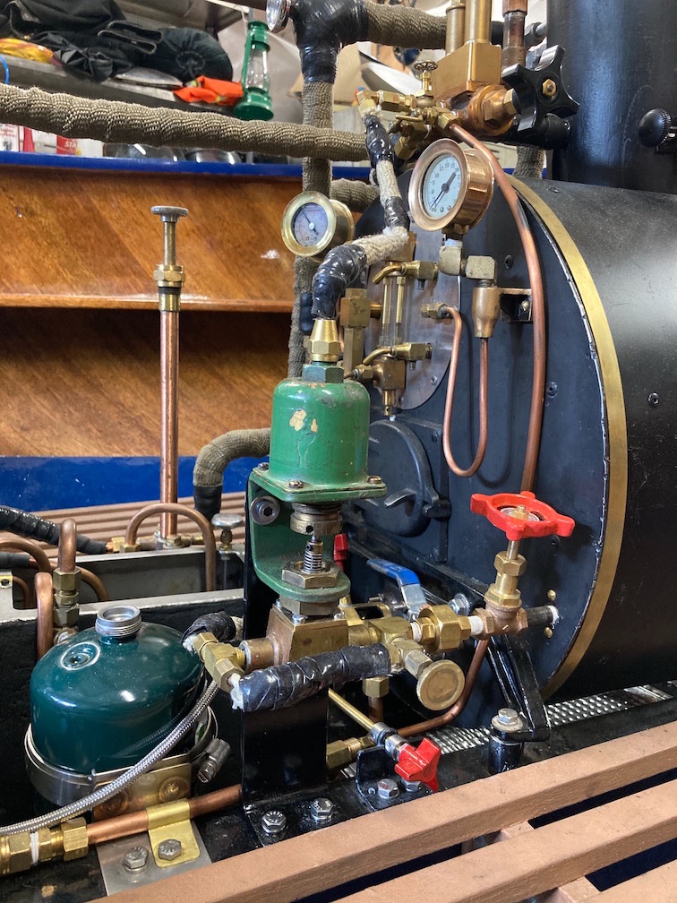

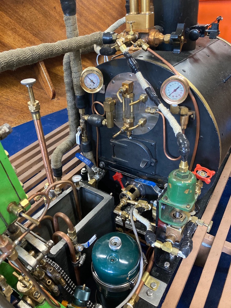

Oil burner atomizer control improvement:
The needle valve I installed for the atomizer control (orange handle visible in the photo in my previous post) is not sensitive enough and makes it difficult to maintain a small "spot" fire.

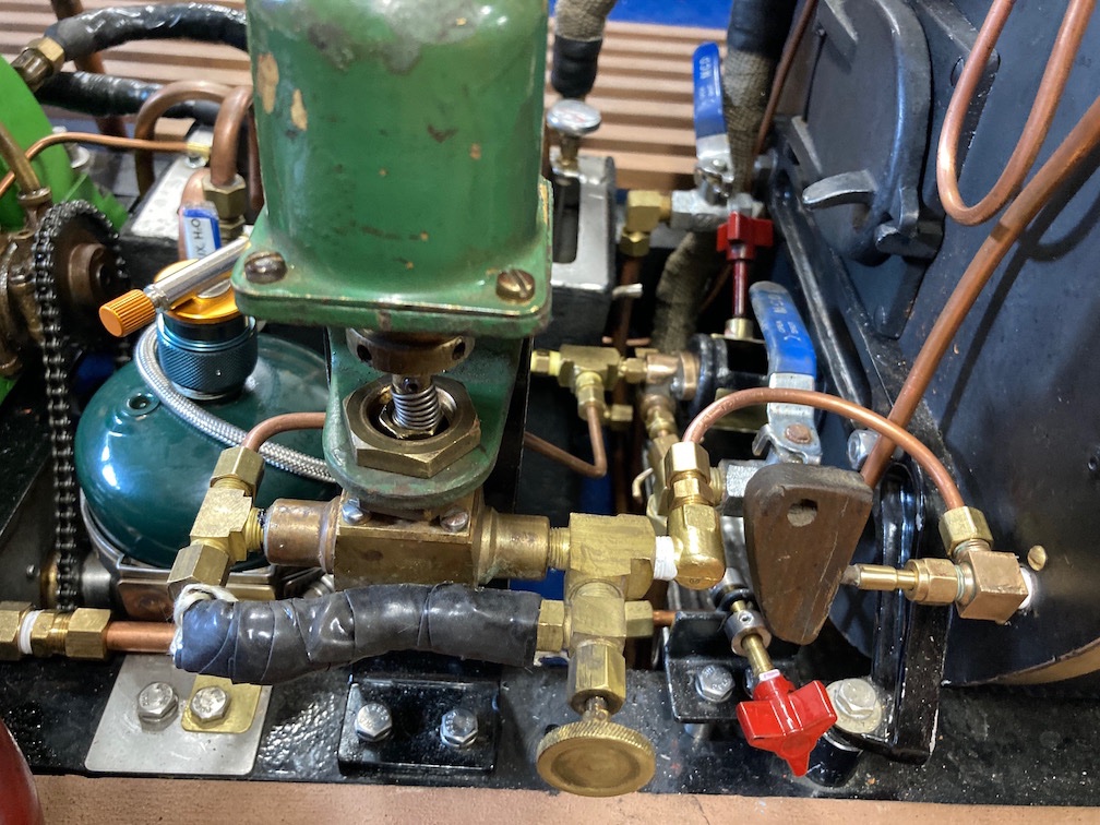

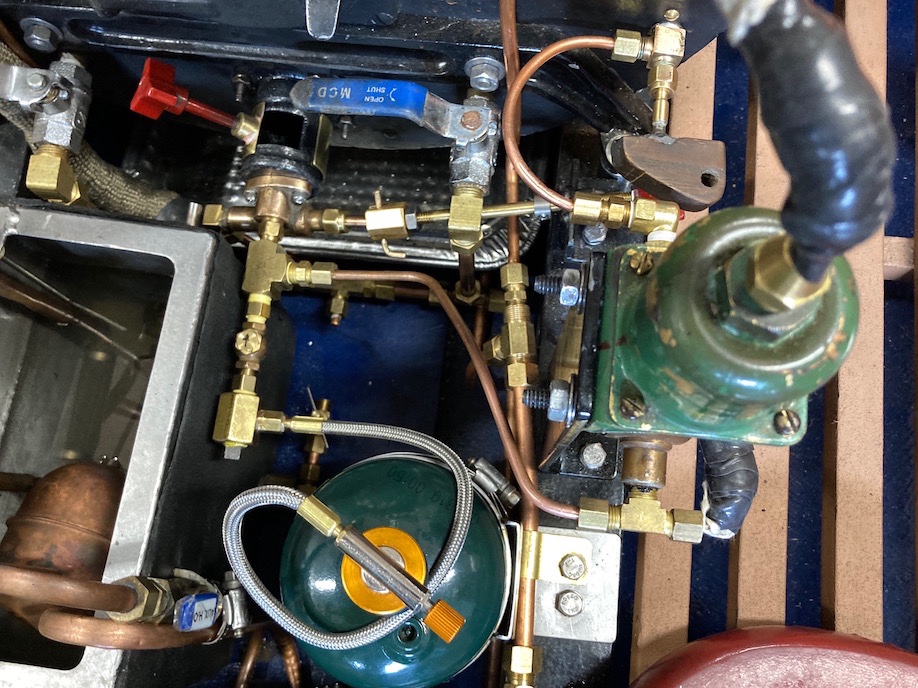

So I serviced/restored the old pressure controller from the original SL Maggie and installed it on SL Clauran.
Pics below show installed pressure controller (old green painted dome) and associated plumbing.
The orange needle valve controls steam for the maximum firing, and the small brass knob provides steam for the "spot" fire.
The top of the green dome is connected to boiler pressure and will shut off the "max" steam flow when the adjusted pressure is reached.
It still needs to be tested and adjusted, but knowing it worked for decades before with the same boiler design gives me some confidence.
We will see...

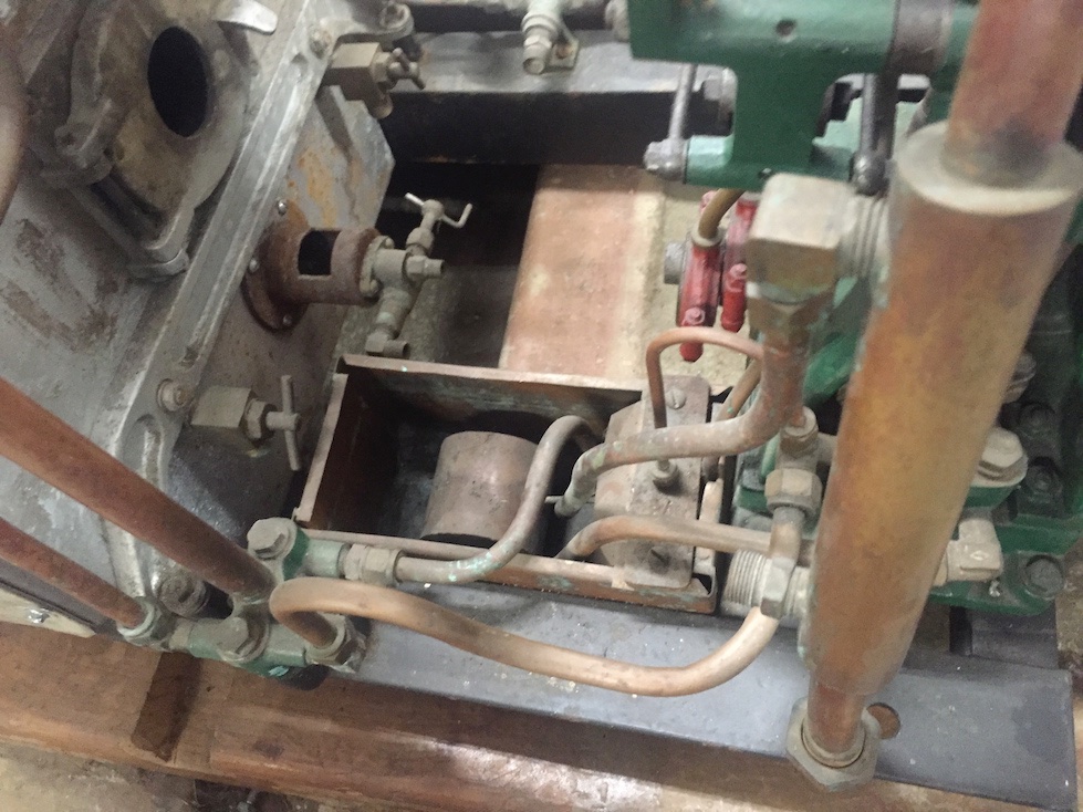

To answer a question I received, I'll post a picture below of the old Blackstaffe steam atomized oil burner that I will return to Clauran's new boiler.
It is a simple burner using steam flow to "suck" oil through a 0.057" diameter hole into the firebox.
No heating coils, no electrical power required, and no moving parts aside for the oil and steam control valves feeding the burner assembly.
You can see the horizontal burner assembly just above and to the left of the hot well, attached to the air mixing tube/burner mount.
The opening in that mixing tube is missing a slide allowing adjustment of the air opening size, to adjust the fuel/air ratio.
I will add that missing item.
The only required plumbing attached are a steam line (center) and an oil line (left side).
Oil flow is controlled by the built-in valve on the right side of the burner assembly.

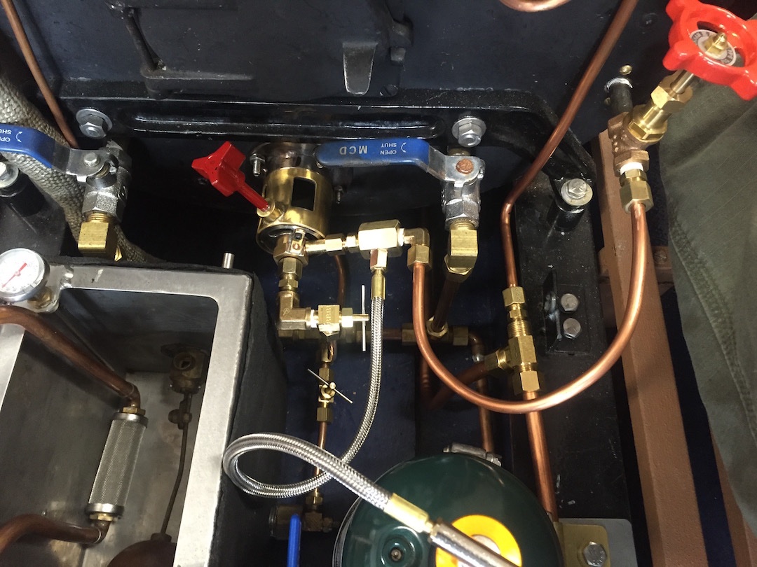

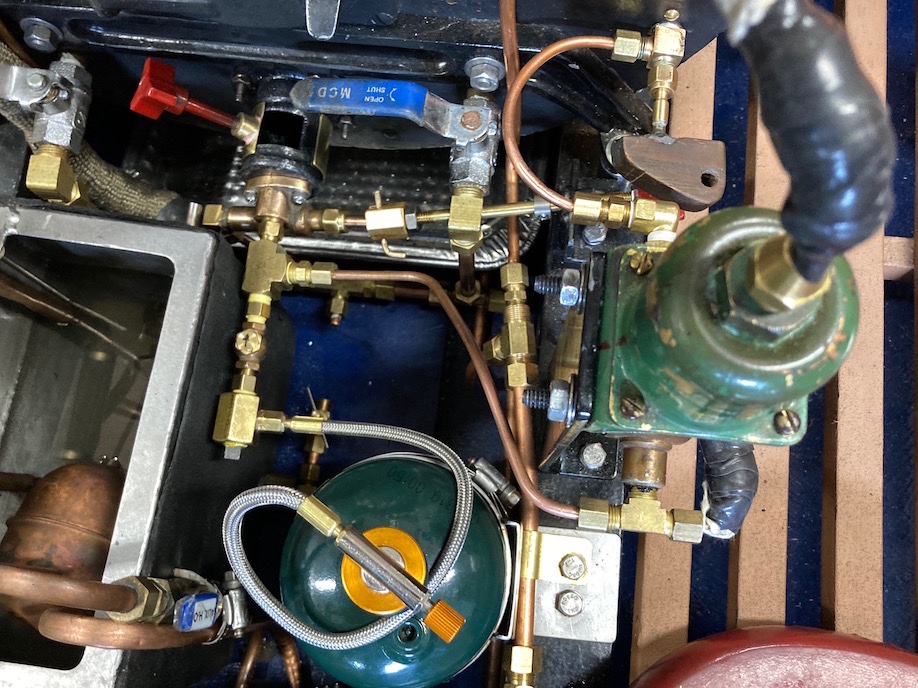

Revision 3 on the oil burner.
An original 1960s Cliff Blackstaffe oil burner for this boiler was acquired (astounding!), plus the original needle valve and pressure regulated atomizer controller, and I finished the installation yesterday, except for the insulation on the two new atomizer lines to the burner.
After the insulating is done, it will be time for another steam test. Whew!
Fire controls are on the right side in the pictures:
The brown wood triangle is the original atomizer needle valve.
The green domed device shuts the atomizer down to an adjustable idle flame (brass knob) when upper boiler pressure (adjustable) is reached.
The red handle is the oil control valve.
So all three operator adjustments are close together for ease of operation.
You can also see the propane supply line for cold fire ups.
I installed a check valve between the propane and steam lines to prevent steam getting back up to the propane line.
I have no information on temperature tolerance of that stainless steel shrouded line to the propane valve.
I do know that the pressure adjuster leaks steam past the vertical needle valve, and tightening the packing can lock the needle in place. Not good.
Perhaps installing new Teflon packing will help. Otherwise, that leaking steam might help keep the brass valve block hot, preventing condensate build up which could extinguish the fire.
This arrangement worked in SL Maggie for several decades, and I hope it works again.
Testing will tell the truth.
