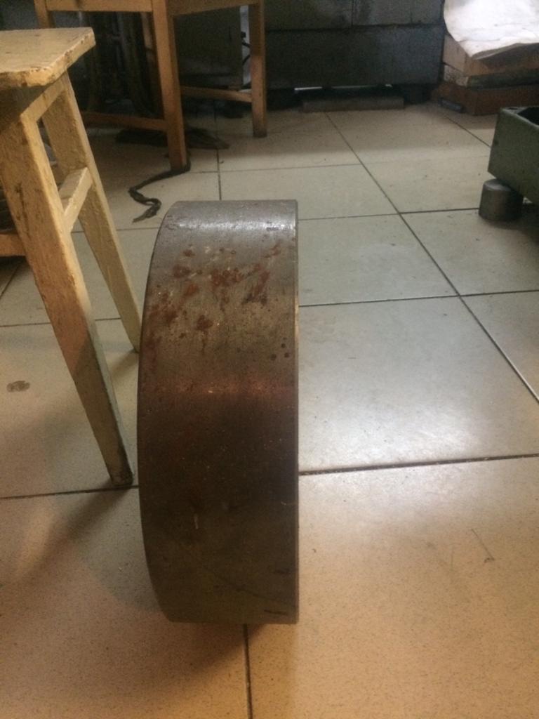

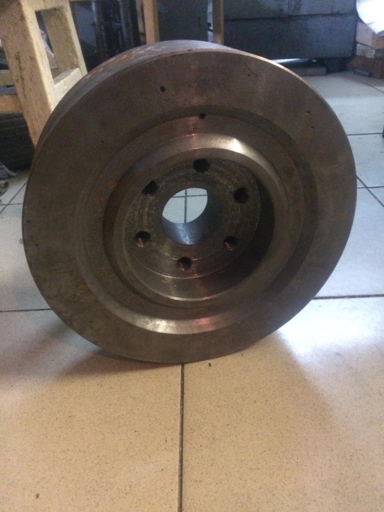

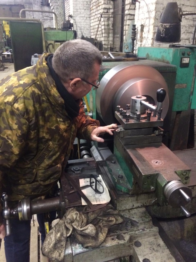

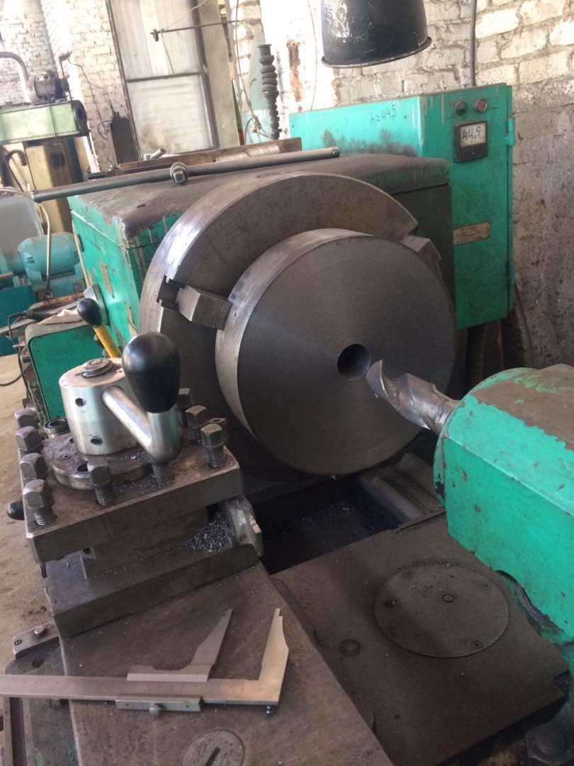

Dear Steam Engine Enthusiasts. I am very sorry that I did not receive any advice from any of you on choosing a steam boiler, but I still hope for your help. I found about 48 meters of copper tubing (155 feet) with a diameter of 18 mm. (about 3/4 inch) with a wall thickness of 1.3 mm. I ask you to answer my question: is it possible to use such pipes in a steam boiler with two pipes to achieve a pressure of 120-140 psi? Will there be enough steam from such a boiler to operate a steam engine? I am guessing that the weight of such a boiler, with two tubes 8 "in diameter and 3 feet long, would be less than 400 pounds. I am attaching a photo of the flywheel, which I was allowed to carve on a lathe last winter. Its diameter is 14 inches, and it weighs about 55 kg. Can you advise me on how to improve its design?

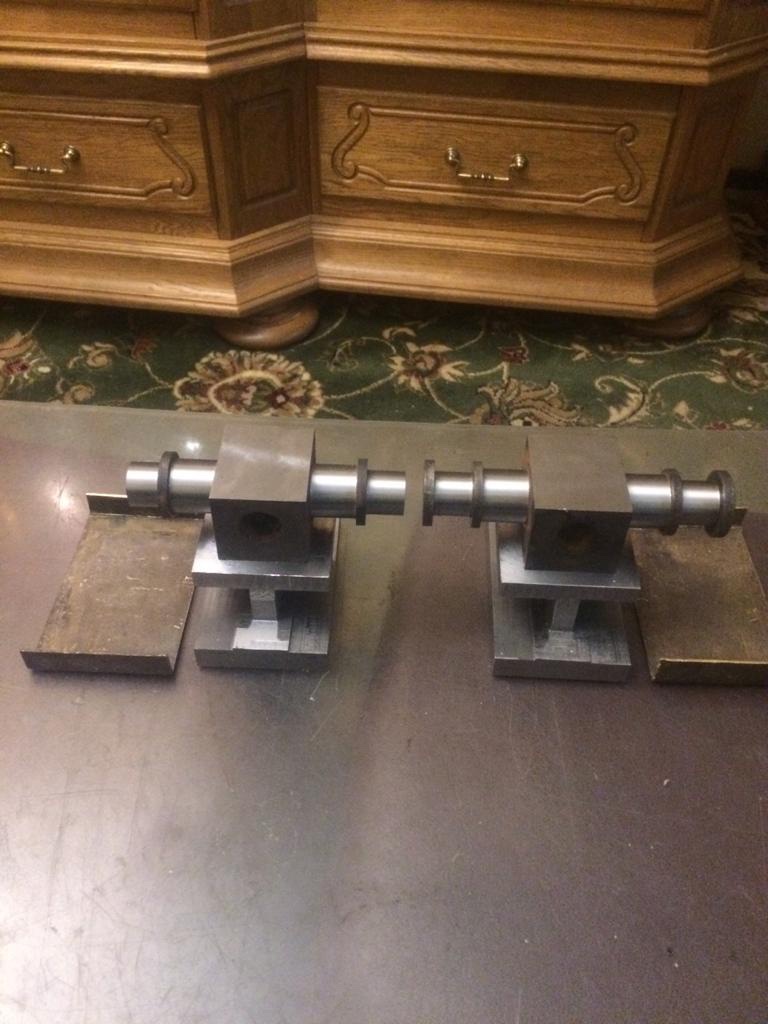

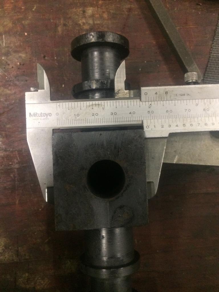

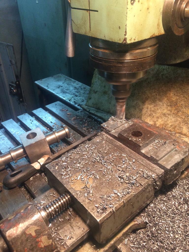

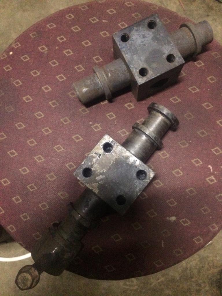

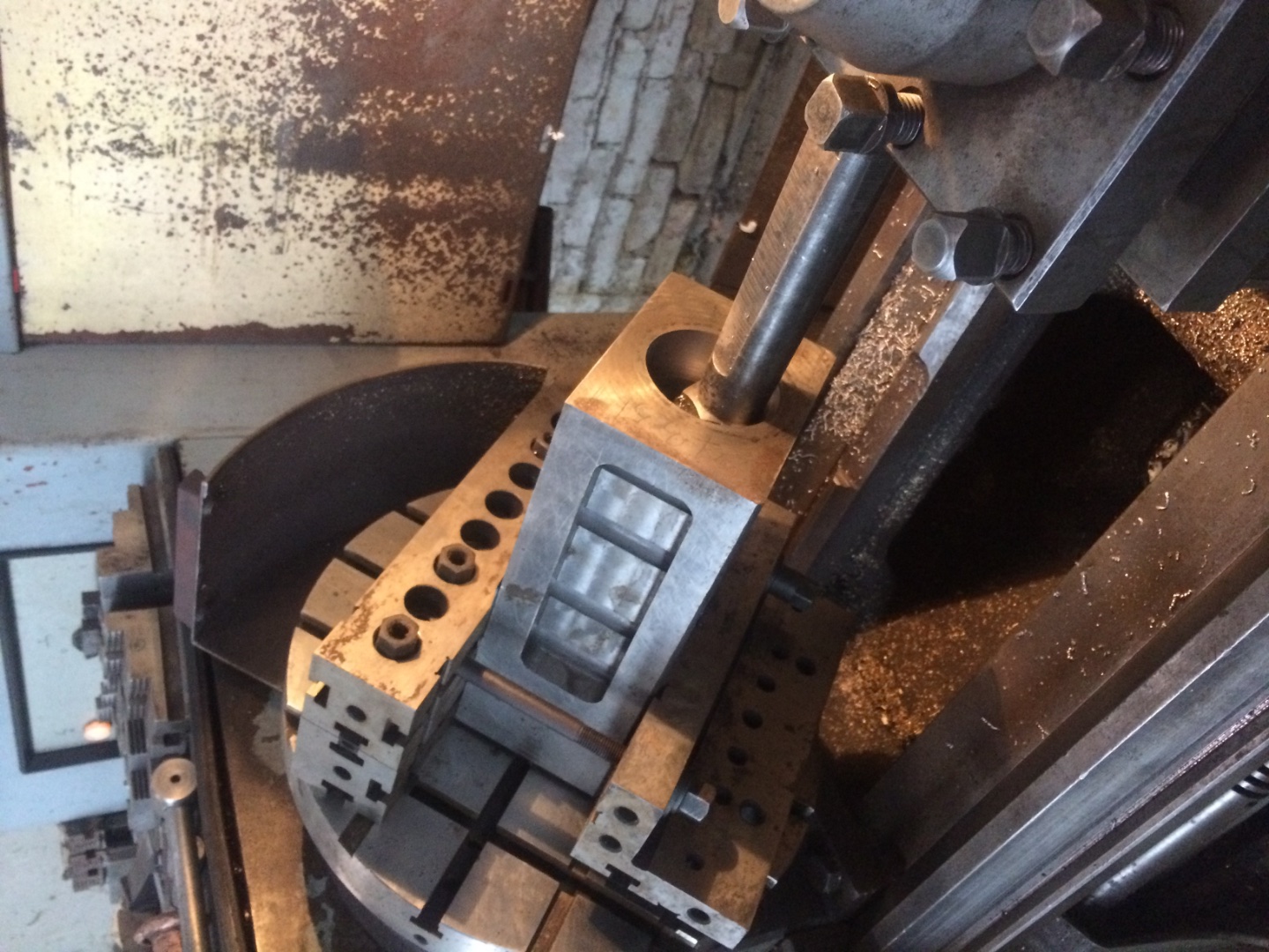

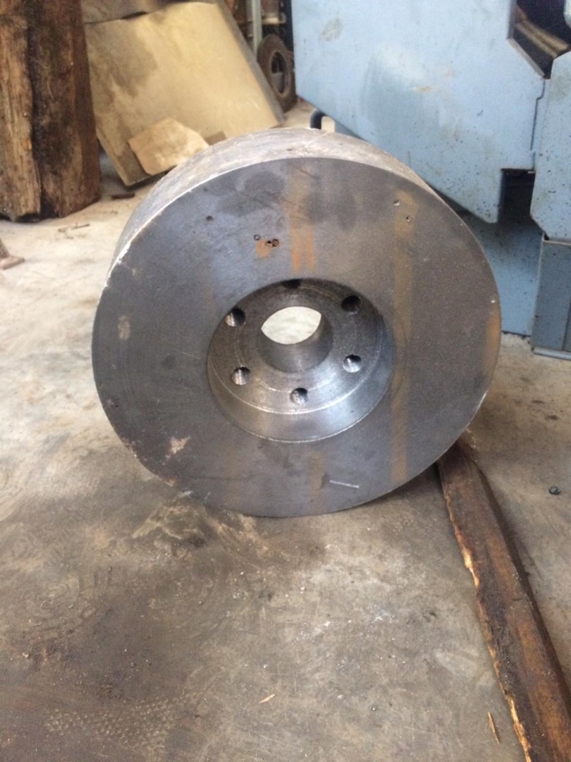

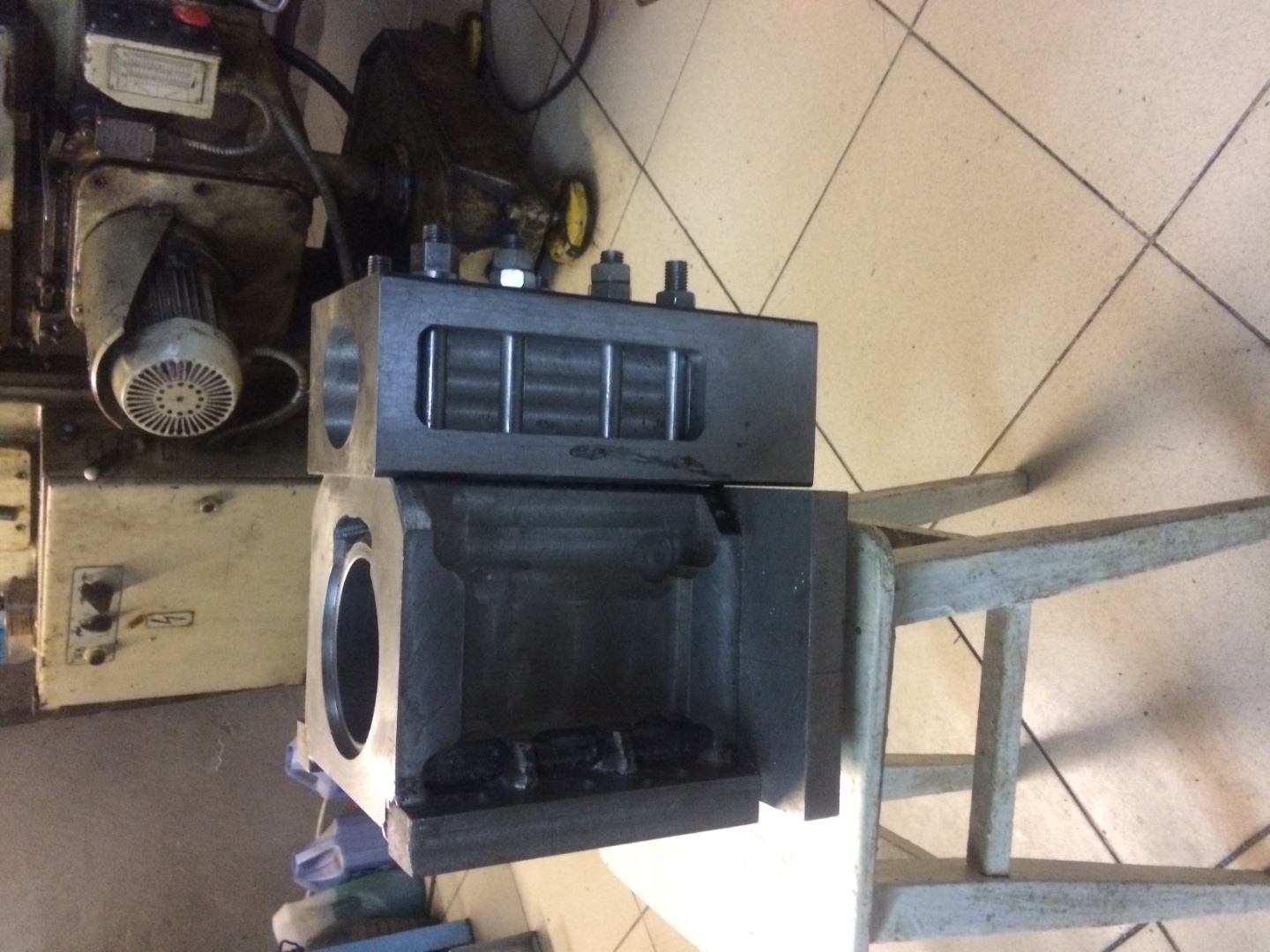

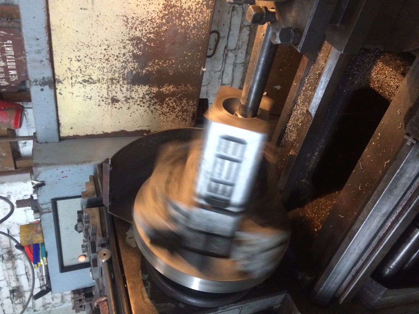

I also want to get information about why square holes (ports) were made in the flywheels on steam machines around the perimeter. I think that it was much easier to drill round holes, if they served, to love the crankshaft. I don't know what the correct flywheel design should be in this case. I want it to look like the 19th century. I also sent a photo of the crossheads, which will have a bronze sole (side) for proper gliding. I am currently making these bronze soles (sides) for kreikopf. Several photos on this topic.
- Posts: 266
The square or round holes in flywheels are for inserting a bar to rotate the steam engine as needed.
Drilling round holes in your flywheel probably is not necessary, but it will lighten it, which may be a good idea.
