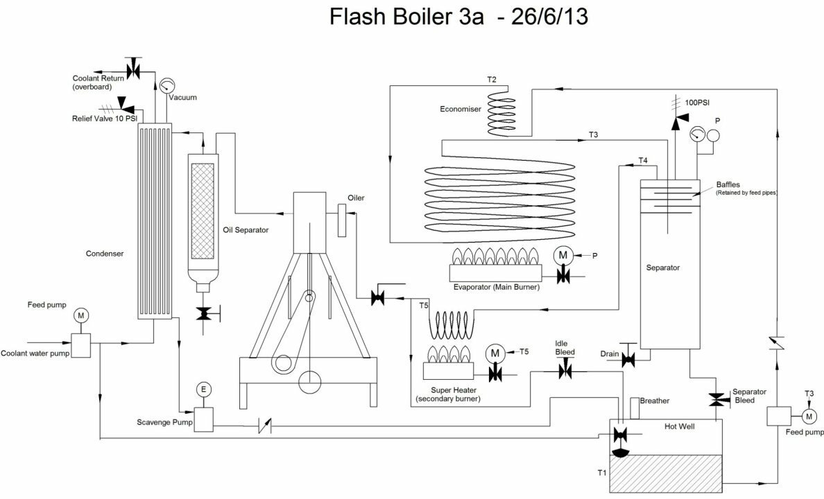

Coming back to the issue of safety valves or relief vales there is an article in SteamBoating Magazine (Issue 17-6) by Tony Anderson which includes them. The the photos and diagrams are still on the website and can be downloaded. His schematic is shown below:
Tony has moved the design of his plant along a bit further now and I may yet be able to twist his arm to write about it for the Mono-Tube website

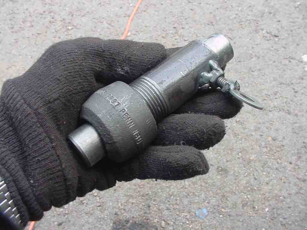

Sorry for the late reply. ASME Code rules do allow pipe sections, caps, reducers, etc to form a pressure vessel. To meet code there are many detailed rules, and to have a code stamped pressure vessel the fabrication must be performed by a "Code Shop", with calculations, material certifications, etc.
You mention using schedule 80 nipples welded to a vessel. This process, while apparently strong enough for our typical pressures, is prohibited by the code. Proper A-105 welded steel nipples, generally called "weld-o-lets" or "thread-o-lets" are needed as they have enough metal to structurally reinforce the hole in the vessel. These require full penetration welds, and generally a welding rod is placed between the vessel shell and the weld-o-let to make a gap before welding. Stick welding is OK, MIG is not OK.
The photo shows a "Thread-o-let" about to be welded into a boiler shell, with an alignment fixture that temporarily passes through a drilled hole in the vessel shell. Note how heavy this connector piece is, compared to schedule 80 pipe.
Piping components can be A-53 ERW (Electric Resistance Welded) pipe, but sometimes this pipe seam needs to be radiographed for code requirements. I always use seamless pipe for pressure vessels, so no radiographs are required. A-106 pipe is all seamless, and sometimes A-53 pipe can be had as seamless too.

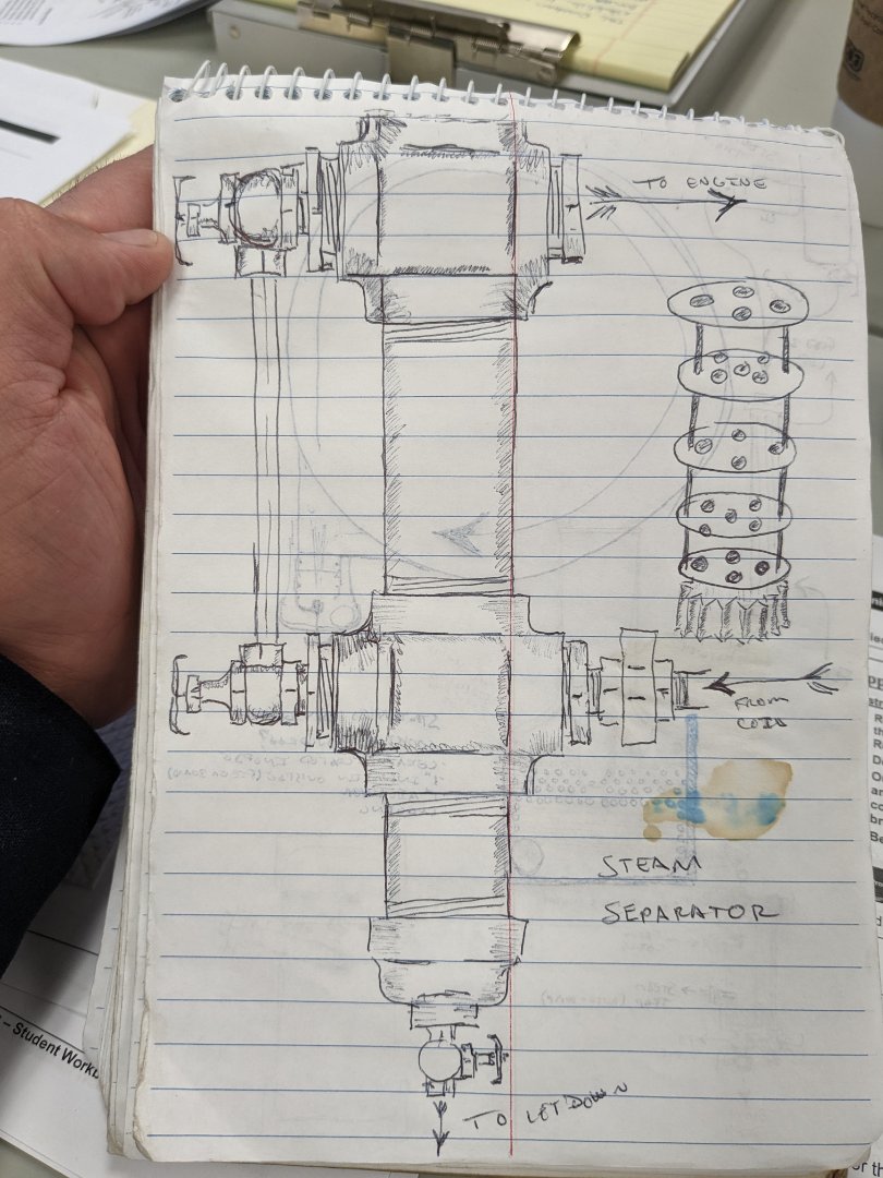

Thank you again Fred for the explanation. My thoughts were a separator completely outside of the casing and pressure vessel. Made strictly of threaded fittings with zero welding if possible. Something like this, albeit much more complex (see attached)
- PXL_20221130_155301885.jpg (155.33 KiB) Viewed 142632 times

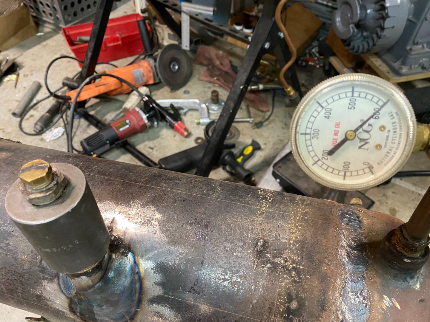

Re: Monotube Javelin
Hydrostatic test of steam/water separaror which receives 400F mixture from monotube coil. Steam to engine, hot water to counterflow heat exchanger that heats incoming feedwater.
