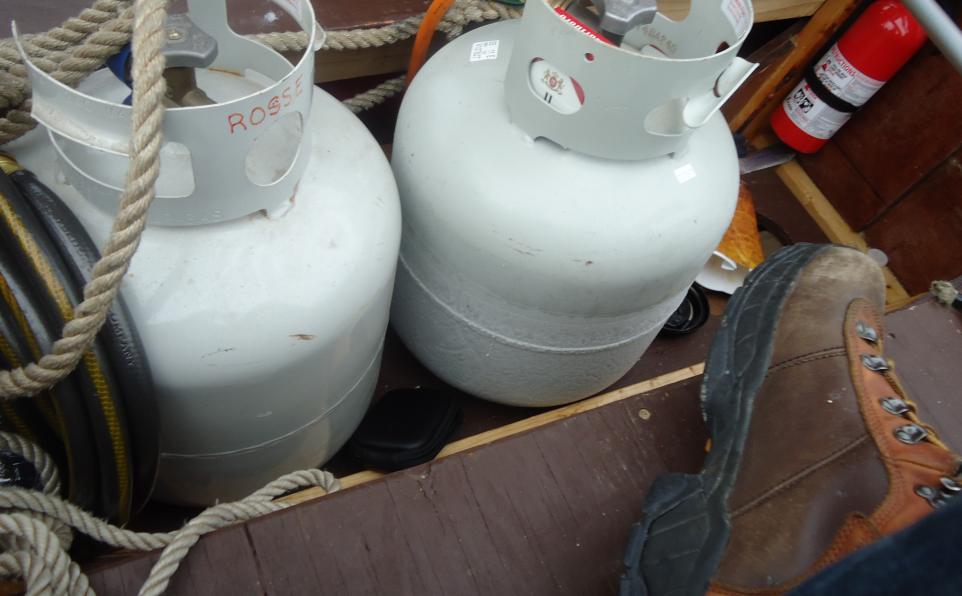

The sidewheeler Margaret S. was a bare hull a few days before the last steamboat meet of 2010, and I had to install the boiler, engine, paddlewheels, rudders, and all piping within 6 days. That schedule meant that I had to put a burner together very quickly, so I abandoned the oil/wood/coal options and went to Home Depot, buying a large "Weed Burner" that uses a 20 pound (or larger) propane cylinder for fuel. The burner ($30 USD) is rated at 650,000 BTU per hour, more than six times my heating requirement, so it runs in a very throttled condition on the boat. The Propane has worked well, and I will probably stay with the Propane as the primary fuel. My only complaint is that the burner does make some noise (a roaring sound), and I have since gotten a set of cast iron burners from a domestic furnace (these are virtually silent) which I intend to install this winter.
I burn about 1 gallon of Propane per hour, and after about 1-1/2 hours of running, the propane tank is showing a heavy ice coating, due to the Propane boiling away. The boat is now fitted with three sockets to receive the standard steel Propane cylinders, and I can switch to another tank in a few minutes. I suppose, if necessary one could disconnect a Propane cylinder, tie a rope to the handle, and throw it overboard. Towing the cold propane cylinder behind the boat for 15 minutes will heat it up sufficiently to restore several atmospheres pressure to the tank. I have never had to do this, but I must switch tanks on longer trips.
Near Philadelphia the new 20 pound steel cylinders are $20 USD each, and the filling is about $16 USD each. They are readily available at many outlets, certainly more available than Dissel fuel. Anything other than the standard 20 pound steel cylinders is very expensive, and much less available in my area. There are 10 pound steel cylinders for about $50 each (empty), and fiberglass 10 pound cylinders cost about $80 each (empty). The 20 pound steel cylinders are universally used at exchange stations, whereas there is virtually no exchanging the smaller cylinders at almost all exchange stations.
- Two 20 Pound Cylinders, one is ice covered due to use.
