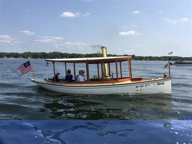

My buddy Dennis's Elliot Bay with AVL compound:
- IMG_2618 (Small).JPG (52.13 KiB) Viewed 79791 times
