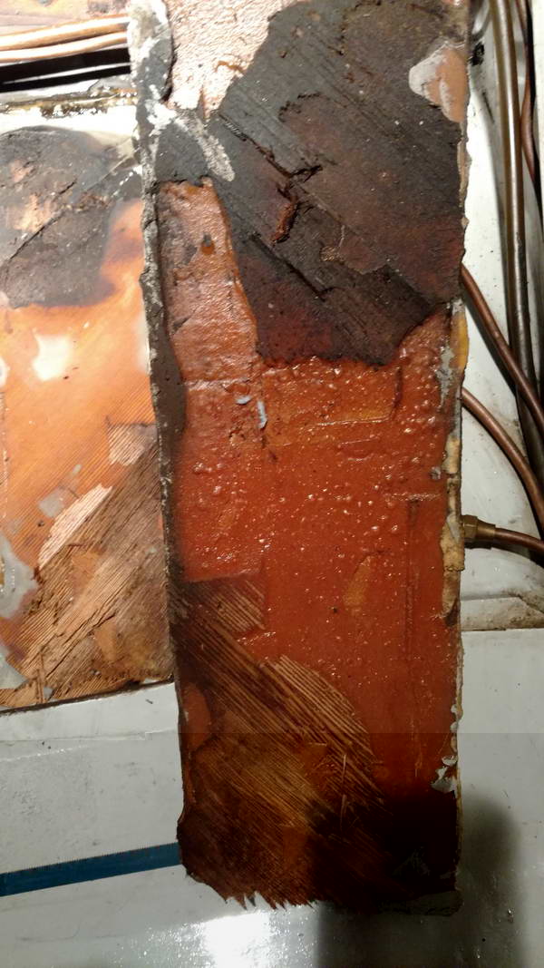

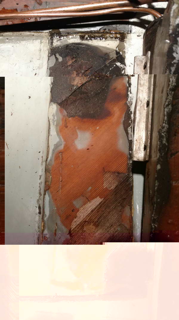

Well the block follows the shape of the hull so it's down at the bottom of the bilge at one end and up under the floor at the other, it's about 6in tall and tapers to 3/4in over a distance of 1.5 ft. The lower end supports the pads the boiler sits on, that area is oily, watery soaked delaminated hull which extends up the hull about 4-5inches, above that there is a foot or so that appears to never been bonded to the hull; the glue has the impression of the hull but it never stuck. Further up are a few inches that the glue HAD a death grip on the floor, I HATED to break that loose but had to pull the block off. I think that just the fact the boiler is tall and very top heavy with a smallish mounting area ( and only three mounting pads!) added to the fact the block wasn't stuck down all the way the boiler just leveraged it loose over time. New boiler is much shorter and lighter and I may give it another mounting point. Will try to get some pix posted, after the rain stops! cheers rp

OK, here's some pix of the bottom of the bilge where the block had come from and next to it upside down is the block, you can see the area on the block where the glue wasn't stuck to anything. To work we go. And if ANYONE knows how to resize pix on a Motorola Droid 2 turbo let me KNOW, a PAIN sending it to my computer and doing it there. You would THINK it would be simple; BAH! rp

Re: Olfelt
Yeah I'll do that as a last resort, I HATE to put more holes in the hull!! But my more immediate concern is the inside of the hull where it's delaminated,I cut back two layers of laminations and it's still oil soaked, I don't want to cut in any deeper, but I'm afraid the epoxy won't stick the the oily wood. I've been soaking it with acetone and have flood light on the area; as the wood warms the oil comes oozing to the surface, and you can press on it and have it ooze out also, I guess I'm just going to keep it warm for a while, keep wiping it down and keep soaking it with acetone, the wood seems fine, no rot, just oil soaked. Any suggestions? This is gonna slow down boiler install! cheers rp
