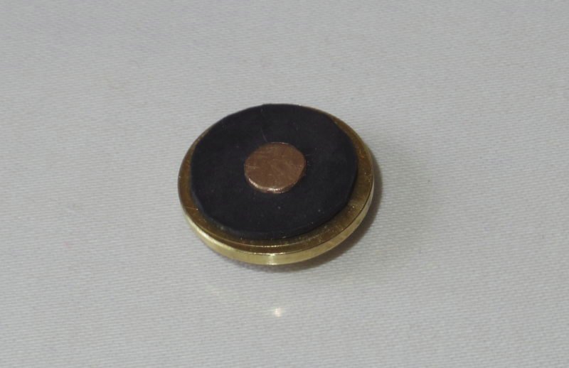

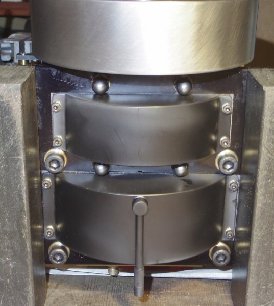

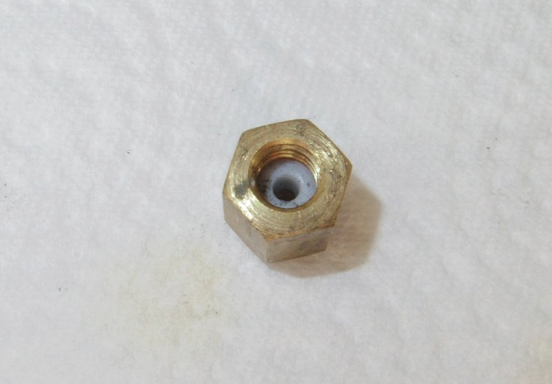

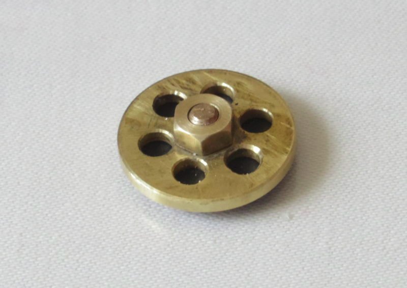

Hello,
for the feedwaterpump were made two "mushroom"-valves. At speed higher than 600 rpm the ballvalves destroy the ball seats in the pump body - experience from the operation of my steam lorry MARTIN. The valves are "pressed" with very light springs to its seats so they work ut to 1.500 rpm - experience from MARTIN.
The valve chest is placed at the upper end of pump chamber to allow the air to leave the system.
The valves in the condensate pump are rubber plate types (NBR). They are small enaugh and noisy in service.
to be continued
-Dietrich

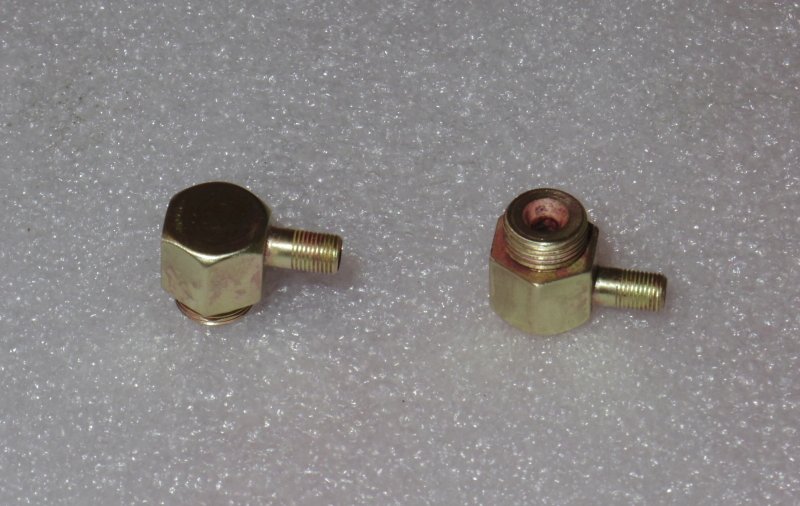

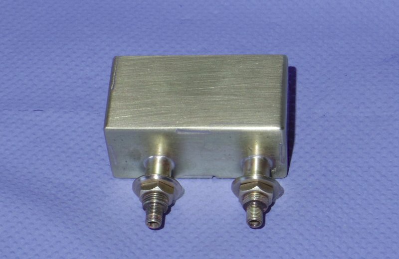

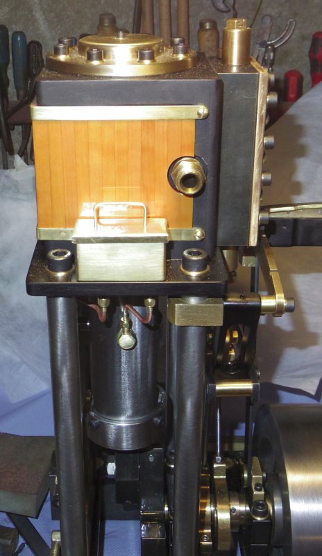

The Crosshead Guide Oiler
Hello,
when i get the engine there was mounted a wick oiler with a cup from a solid aluminium block and plugged pipes so the oil could leak out.
At my model steam lorry was a similar problem and the solution was to built a new soldered cup and screwed connections.
to be continued
-- Dietrich

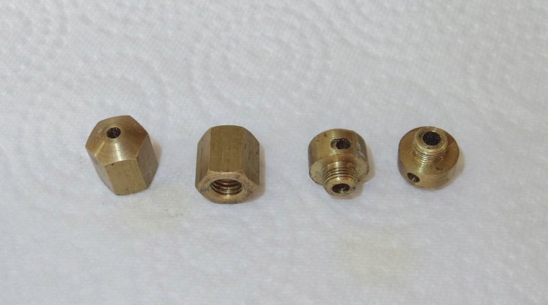

Posts: 290
Re: The Crosshead Guide Oiler
Hello,
all parts were new built and silver soldered if necessary.
to be continued
-- Dietrich

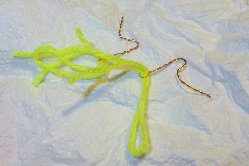

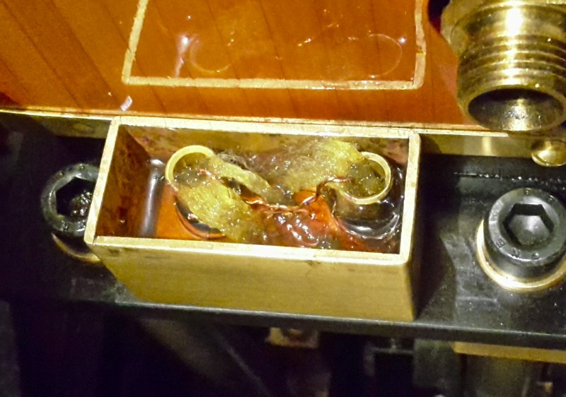

Posts: 290
Hello,
the wicks were made of woolen threads.
The wicks with its handles from drilled copper wire.
The wicks in its cups (in working position).
It is easy to remove the wicks from working position and to protect the fingers from getting oily.
to be continued
-- Dietrich

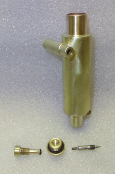

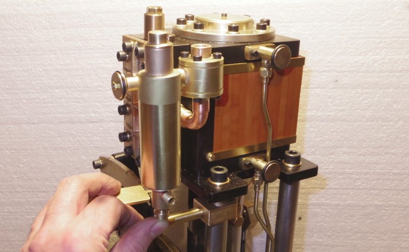

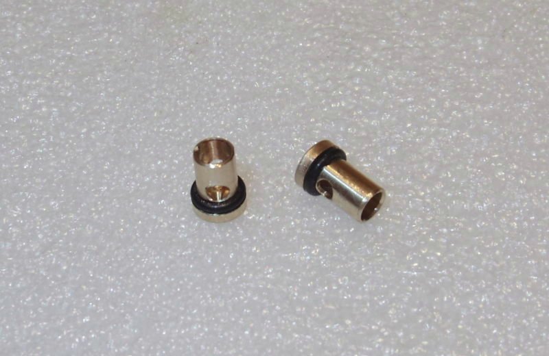

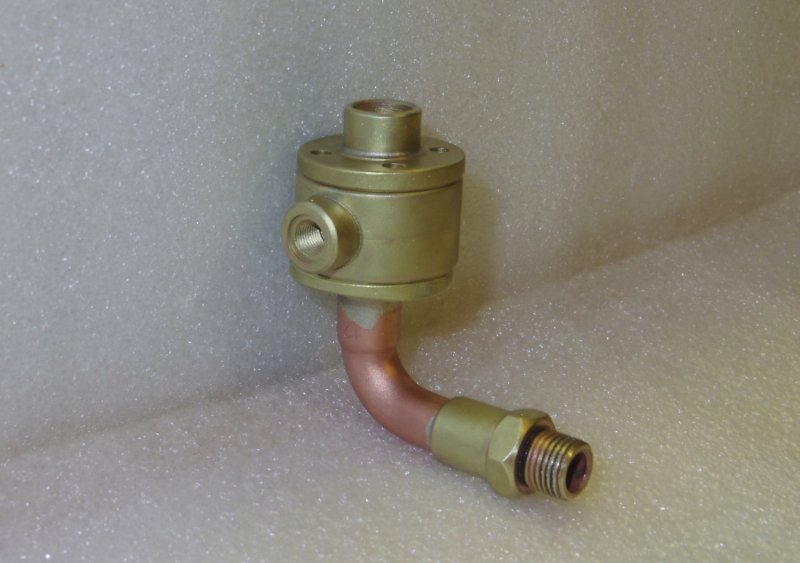

The displacement lubricator
Hello,
the displacement lubricator was made from bar stock and a short pipe. The regulating valve is outside of the body so it can be filled with more comfort.
The valve stem has a 20 degree tip and is tightened with an O-Ring.
to be continued
-- Dietrich

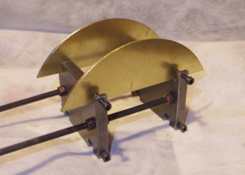

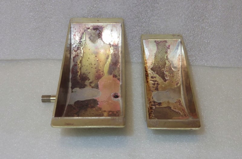

The machine trough
Hello,
because there is only a open baseplate i have built two machine troughs from brass. They were soldered in a fixture.
The fixture
Best
Very nice to see such fine work. Holiday "Eye Candy" for many of us
Thanks
TriangleTom
