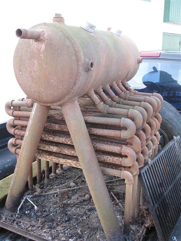

You may not be able to make an olefeldt watertube boiler with tubes that size, but you could possibly make a Babcocks and Wilcox or a Worthington style watertube boiler. Both have good circulation characteristics and have been used in marine applications. We have a Worthington style in our large boat, and B&W boilers have been used extensively in soups of all sizes.

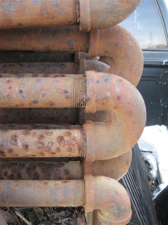

Here is an original George Whitney boiler that belongs to a friend of mine. The engine that went with this boiler was purchased by Webster out east of aluminum launch hull fame. The engine castings were copied and sold to a few people.

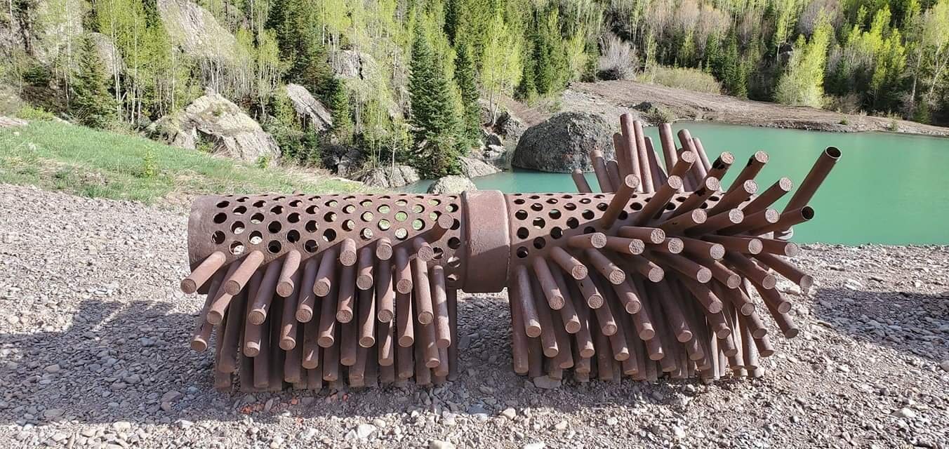

A boiler design you may consider with larger tubing and limited means to bend it, is the porcupine boiler.
This Whitney boiler uses right and left hand threads.

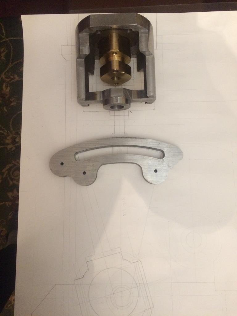

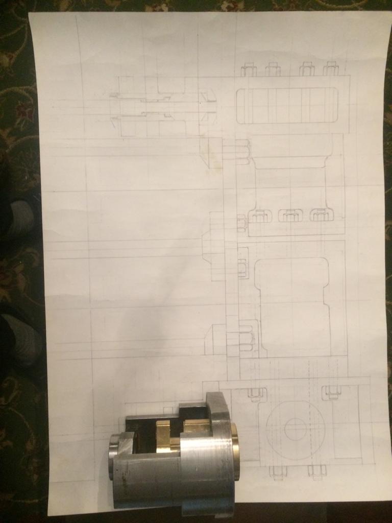

Dear TahoeSteam and DetroiTug, I thank you for your feedback and your recommendations. I have already seen the boiler design recommended by TahoeSteam. This is a great design, but it requires a lot of welding work that I can't handle, I can't do it, I'm a very poor welder. If not for this, I would have started building this particular boiler. DetroiTug showed me a porcupine steam boiler that I have never seen. But I cannot understand how steam is generated and circulated in such a steam boiler? Where is the top of such a boiler? Where should the firespace be located? The second George Whitney boiler is a very nice interesting steam boiler that interested me. But I cannot imagine in what sequence it should be assembled and what kind of seal between bends and straight threaded tubes should be used? To what extent will such connections be vapor tight? Making such a boiler from the material that I have seems to me difficult, but possible. I also want to thank the other enthusiasts who gave me the recommendations and again I want to ask the question: have any of you used a steam box (zolotnik). one, as I showed in the photo, with one port for steam outlet? How does this design work? I would be grateful for advice and any information.
Quote ''porcupine steam boiler that I have never seen. But I cannot understand how steam is generated and circulated in such a steam boiler?''
Porcupine boilers have poor natural internal circulation and why they are not very popular. They do work as some have been built and used over the years. I was reading somewhere that a flat thin plate is installed horizontally in the tubes, creating circulation from the lower half to the upper half of the tubes.
With limitations on welding access and access to machines to roll form tubing, there are only going to be very few design options available. The porcupine is the only boiler that I can think of. It could be constructed with no welding by selecting a heavy wall thickness of the center drum and threading right in to it.

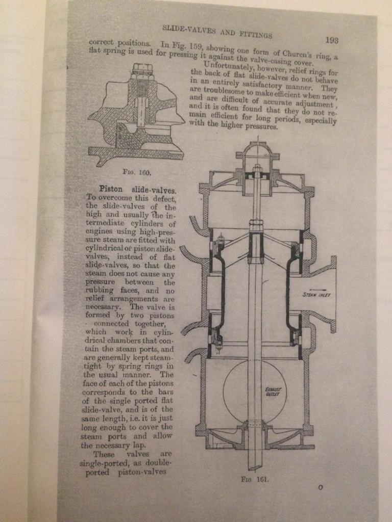

Your picture above shows a “piston valve” very common on locomotives, this particular one has a hollow body so that the upper and lower sections are common, exhaust from the upper ports can therefore leave via the lower exhaust port.
It is usual practice to use “inside admission” i.e. the steam enters at the centre in this case into the annulus formed by the valve body.
The more common valve uses a solid body but therefore needs two exhaust outlets one above & one below. I have made a number of these types with complete success; however the piston and liner need to be made accurately as regards fit. I use plain bobbins with no rings, just some “water grooves”
Jack
Jack

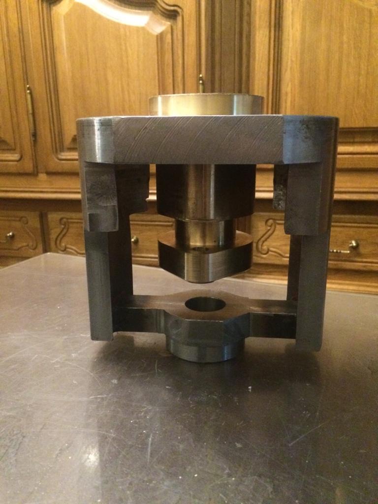

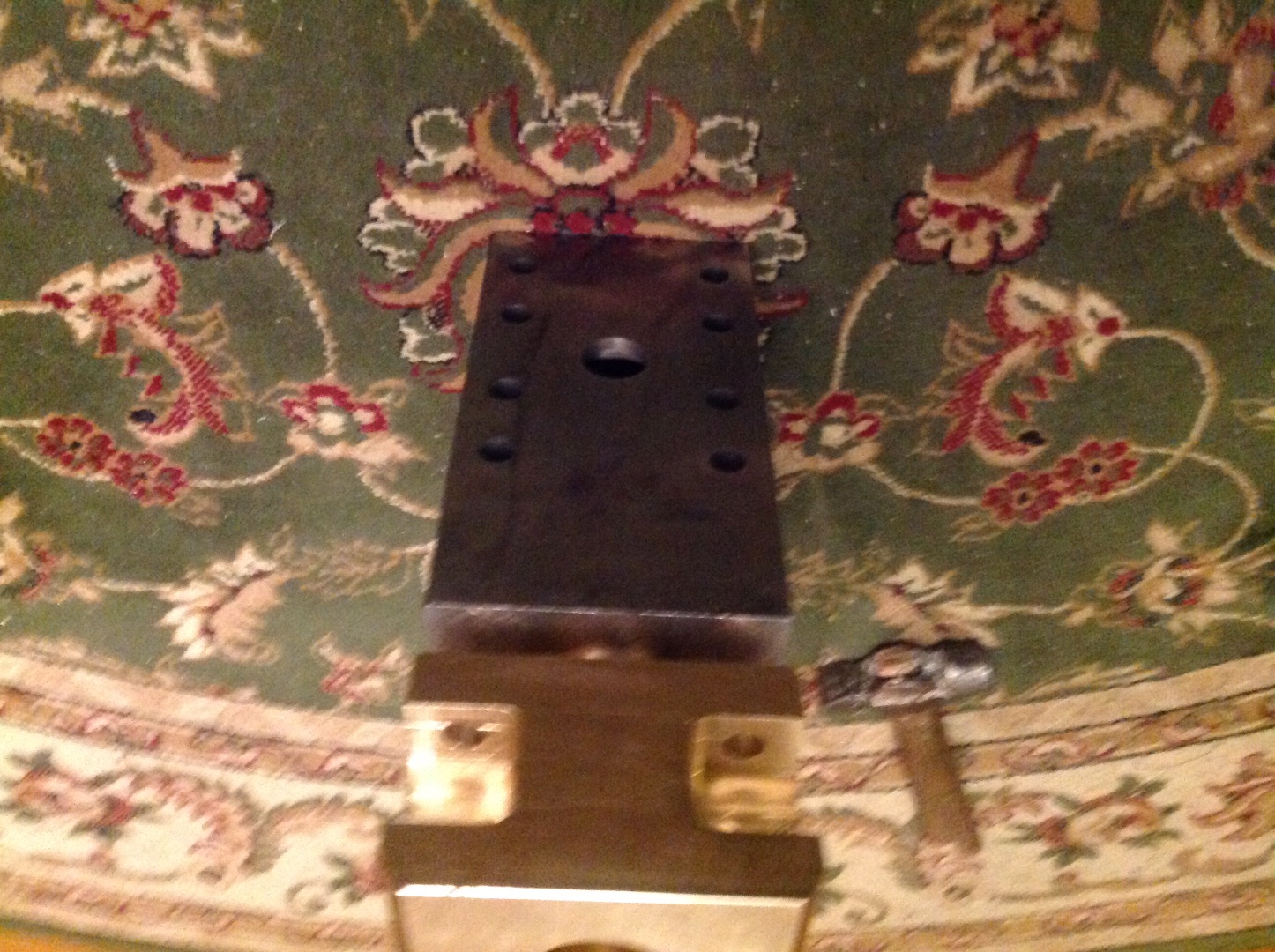

- Posts: 289
Hi,
the slot is to short. You have to lenghten it so the stone can moove free in "full ahead"- and "full astern"-position and to get the full stroke.

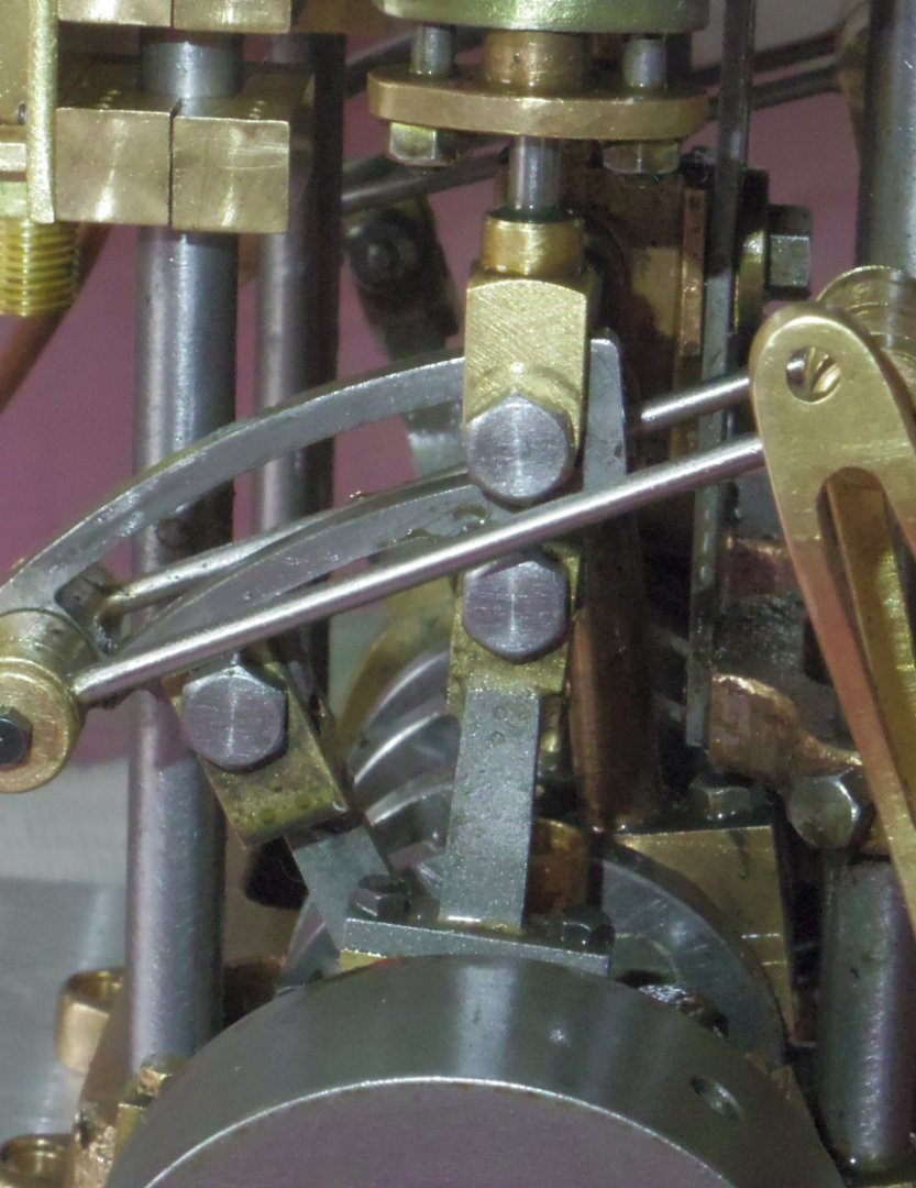

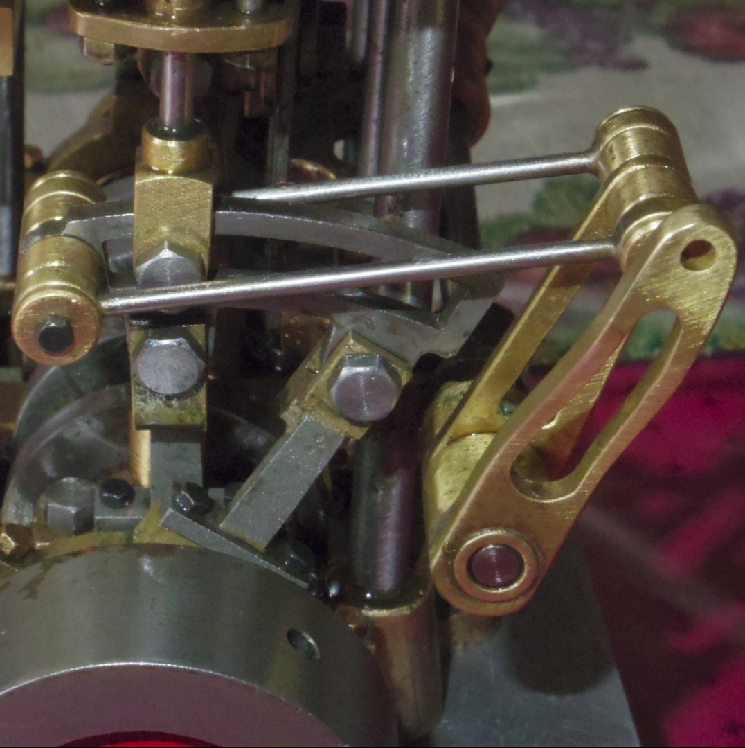

Here two pics of my little STUART Launch Twin. It has also as short eccentric rods like yours, which require a lot of room to move beyond the linkage. A little more length would have been desirable, but the machine runs very well in the intended direction of rotation.
